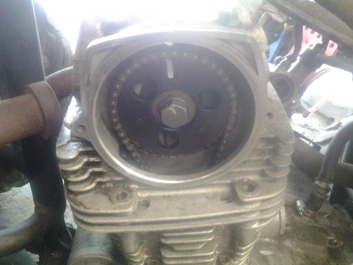

Have a 96 timberwolf 250 4x4 i need help with timeing I did a complete top end gasket set and now I need to time it anyone's help would be great thx bobby
I have that but it is not realy helping me with the timeing I can not fide the timing mark for the bottom half of the motor and dum a$$ me I for got to mark it on the bottom
There has to be timing marks on the gears. Read the service manual carefully and follow it to the letter. Page 4-51 of that manual is where it starts not sure what else to tell you to assist you other than follow the directions carefully. I havent worked on this particular engine but what I do know with everyone I have worked on is the timing marks are on the gears. Sorry I couldnt be more help.
When you get your new valve installed drop me a line before you crank it over - ALWAYS check your cam timing 3 times before starting the motor.
Looks spot on, get that tensioner installed, rotate the motor by hand 5-6 times and make sure it stays lined up. You need to compress the tensioner before installing it - 10mm head plug comes out, use a slotted screwdriver to pull the plunger back and hold it there while you bolt the assembly to the cylinder with the 2 6mm bolts, remove the screwdriver, re-install plug.
bobby sorry to leave you hanging for a month. I always pulled the tension spring/rod, bolted the housing onto the cyl (2 bolts) and then put the spring/rod and plug back on.
