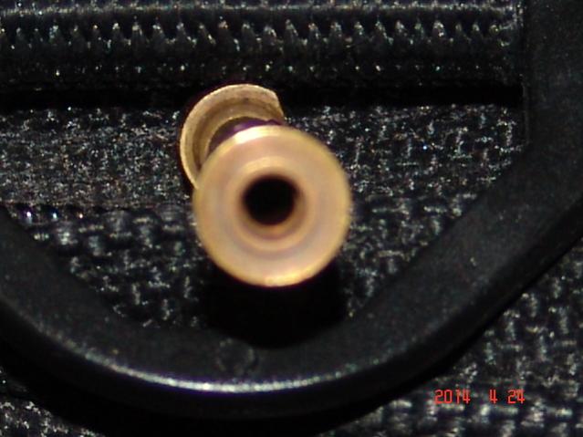

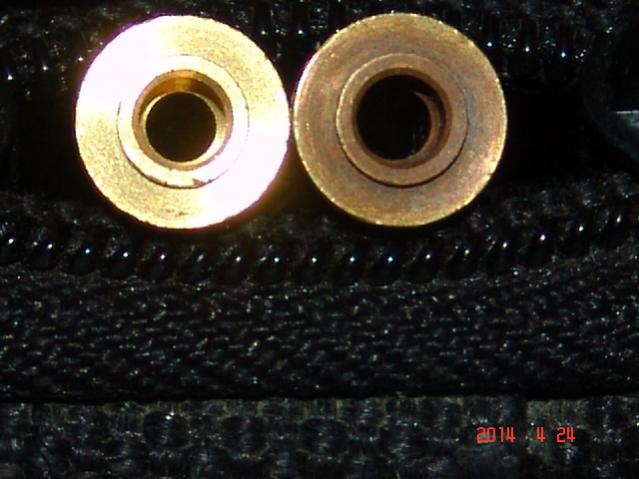

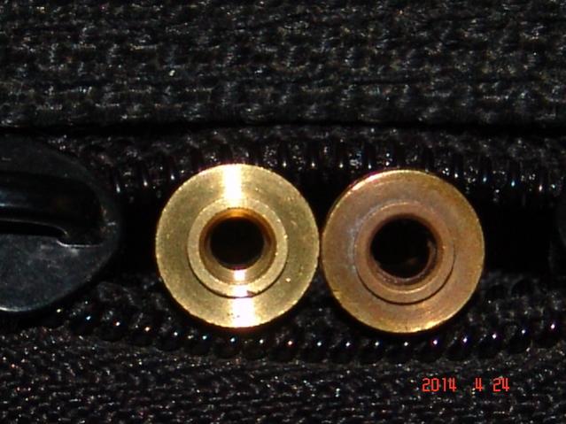

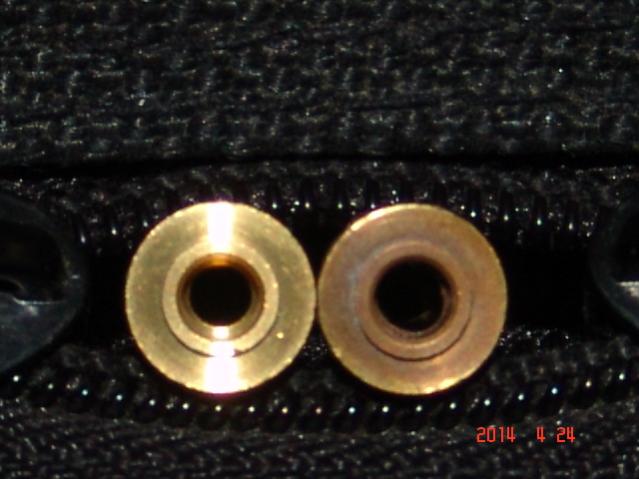

You were Correct Oxidized_Black. The seat or Needle Jet emulsion tube was the culprit.
I searched and could not find any threads about this on ATV sites but what I did find is that Harley Davidson use the Constant Velocity (CV) Mikuni carburetors. What happens is the seat or needle jet emulsion tube will become oval inside allowing the fuel to pass at all throttle stages. One of the indicators is if you do not need to utilize your choke on colder days. Basically it causes a rich condition like having the choke on all the time. This is a slow process and according to the web site it occurs with the use of stainless needles and also Harley attributes it to vibration imagine that.
Anyway my Needle Jet was oval and causing the rich condition. Thank you for the input and I would tell anyone rebuilding a CV type carb to buy the Needle Jet emulsion tube (seat) and replace it. I did not find this jet in any of the carb kits and had to purchase it separately. This surely cured my problem and the machine runs like a top now.
