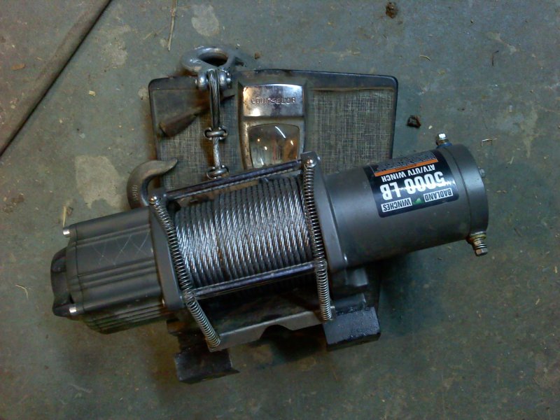

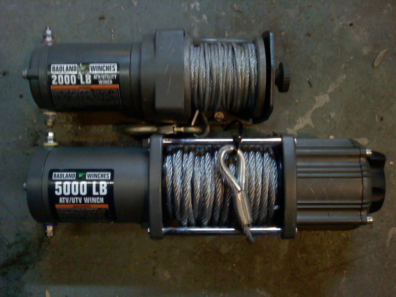

I found some old pics.
Here it is spooled up with 100ft of smaller-but-still-sufficient cable:
Looks like it weighs 28lbs.  The springs are just something I made to hold the cable flat against the spool.
That's the best winch I could find 10 yrs ago.  The line speed is super fast, the line release mechanism is nice, the spool is pretty big, it has all the power an atv frame could handle, doesn't draw a lot of amps, and it sounds a bit like an RC car which is kinda cool.
Yep, long and skinny is better than short and fat.

I have one of the smaller ones shown in your photos, it always works but it seems to really work hard pulling no where close to its limit , especially if your loading an ATV that won't roll, which I do occasionally, I am going to get one of the larger ones, im always afraid the cable is going to break, thanks for the info and photos.

Those are the el cheapo variety that work ok for light use.  I actually have a box of broken ones.  It's the transmission that fails.  The only good thing about them is the price and they're small.  I used to find the 5000lb ones on ebay for under $100.  And whoever sells the badlands brand used to have black friday deals or coupons.  Not sure if they still do.
I have 3 of them and wouldn't mind having another as a spare.  As soon as I get one I pull the transmission off and inspect the grease situation.  Sometimes at the factory they don't put enough in or I don't like the looks of it so I repack it with good grease.  I've heard good things about bel-ray waterproof grease.
