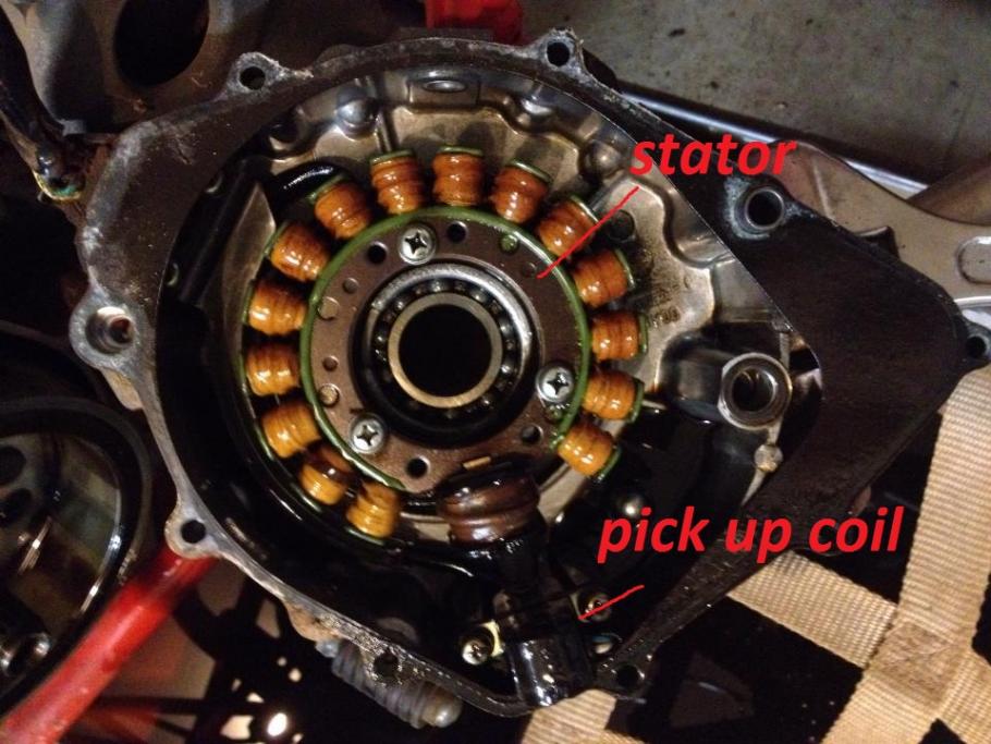

"You can do an OHMS reading on your stator and pick-up if you have a mulit-meter/ OHMS meter. Make sure your meter is set at the 2K setting.
Brown to Green wire should read 275 ohms (source coil)
Red to White wire should read 325-350 ohms (pick up coil)
and between phases (white wires) should be 0-10 ohms"
