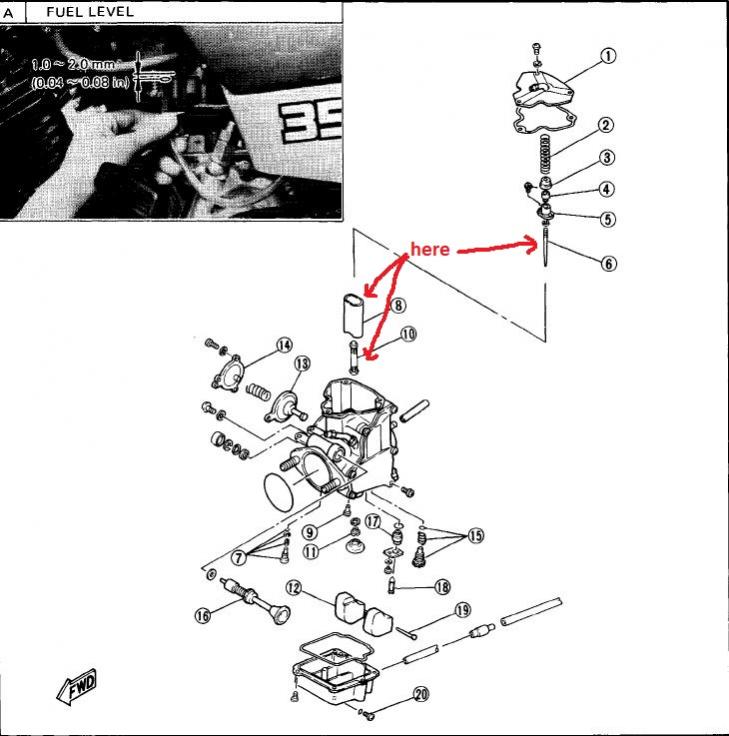

If your carb is like mine there should be two screws located at the base/underneath, the thumb screw on the bottom (one you can turn by hand) is the idle rpms. The one you need a screw driver for controls your pilot jet, or your idle air/fuel mixture. Now depending on carb, its in two locations, either before the throttle plate, or after. If its before the throttle plate, its controlling air, if its after the throttle plate (engine side) youre controlling fuel.
If the screw is closer to the engine side of the carb or past the throttle plate, screw it in all the way in until you feel it bottom out (gently) and then back out 2.5 rotations, and go from there. IN leans the mixture, out enriches it. But until your vacuum leaks are under control, it wont matter, for example mine is about 4.5 turns out right now, and I did that so when I go from idle to part throttle, it doesnt want to kill the engine anymore due to my vacuum leaks. Once those are fixed I should be able to go back to around 2.5
