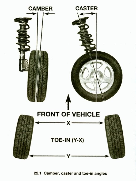

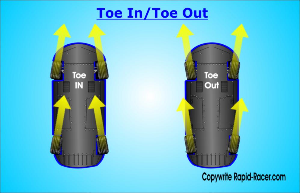

camber and/or toe out ... for tow out, check the measurement at the front of the tires across and then at the back.
I believe the only adjustment is on the tie rod.
