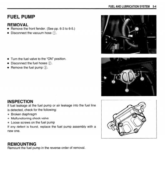

Could be your fuel pump. It should pulse when you take it off and crank it. Check the vacuum hose to it for holes. Also check if there is fuel in that vacuum hose. If there is, your diaphragm in the pump is shot. Also be sure there is enough fuel in the tank to be above both inlet screens

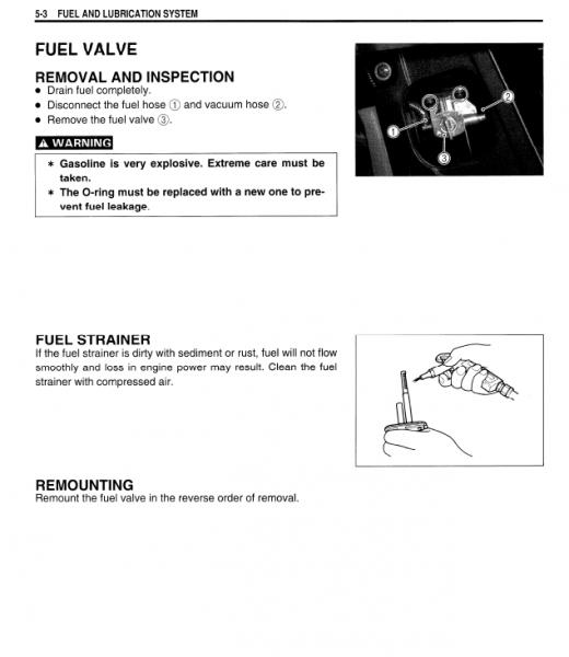

You can check the fuel pump by disconnecting the fuel line at the carb and hitting the starter. Gas should squirt out of the line in small pulses. You can check the vacuum line at the front right side of the carb by removing it and looking to see if it is wet. Since it is a vacuum line it should be dry as a bone. Also look at both lines for cracks. If you have to replace the fuel pump, it is on the left side of the frame below the handlebars. You will have to remove the front rack and fenders to get at it. You might also want to ask oxidized_black for a service manual download. It has a couple pictures of the fuel pump. They aren't real good as far as showing the location, though.
And as oxy says check the petcock. If you pull the line off at the petcock, gas should run out of the petcock when you turn it to on or res. The gas then goes forward to the fuel pump. then down to the carb.
