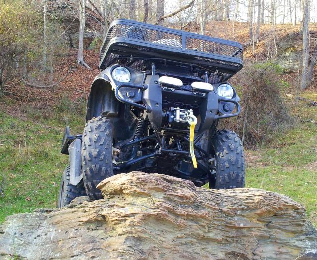

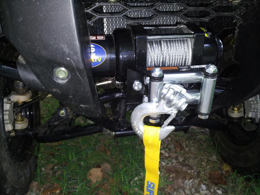

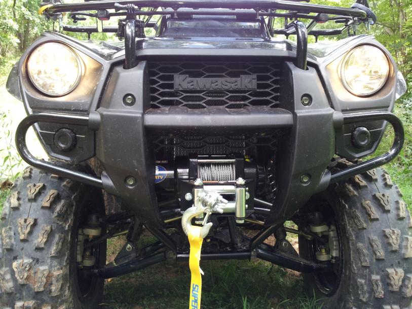

This is just an FYI, the 2012 Brute Force 300 4x2 has a Warn winch mounting plate factory installed. Now they say in their website and brochures it accepts warn winches, but no other winches are listed. I am here to tell you that i have mounted a Superwinch LT3000 with no problems at all as far as installation, the Superwinch bolted right up quite nice to the Brute Forces mounting plate. Just an FYI !!! As this is the new Kawasaki Brute Force 300 4x2.

Aldo, Now this is my opinion ! I think Warn is in with Kawasaki to try and corner the market on aftermarket winch installation/sales ! All i did was compare the mounting pattern from the bike and the Warn winch ! I then went online to Superwinches web site and got their dimensions to see if they matched and they did. I ordered the winch from Amazon.com and paid around 127.00 ( to include shipping ) which is a pretty good deal for a 3000 lb winch. The mounting plate is already on the bike from the manufacturer. I installed mine with no problems at all !! I will post some photos for you to see. Do you like your bike ? I love mine, it has plenty of low - midrange power. Probaly the best 2wd atv if have ever ridden. I can go anywhere i need to go. Kawasaki hit this one out of the park.

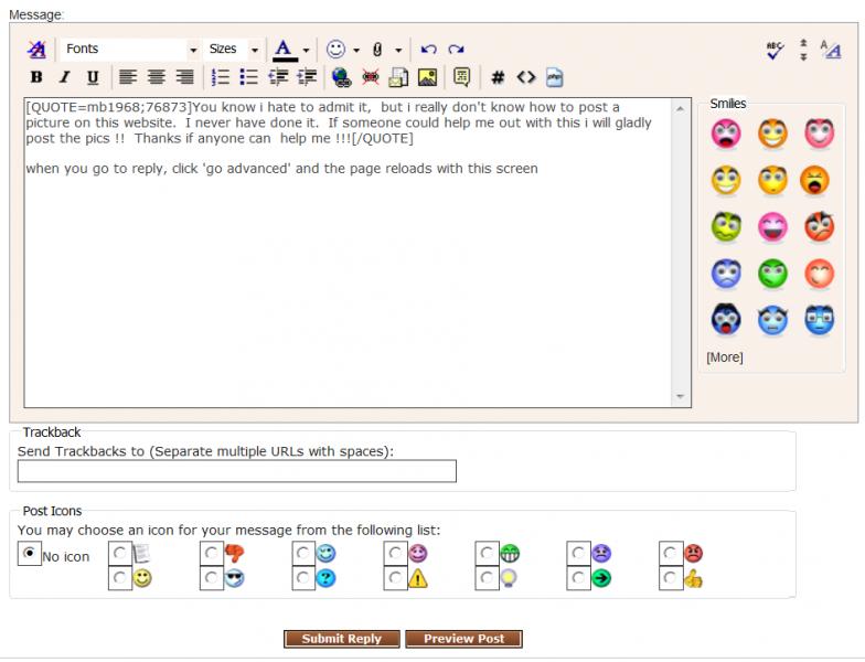

You know i hate to admit it, but i really don't know how to post a picture on this website. I never have done it. If someone could help me out with this i will gladly post the pics !! Thanks if anyone can help me !!!
when you go to reply, click 'go advanced' and the page reloads with this screen and just click the paperclip and this will allow you to upload thumbnail pics from your pc ...

So if i understand i just have to buy a winch ? no need mounting pattern ? because she is already on the ATV ?
