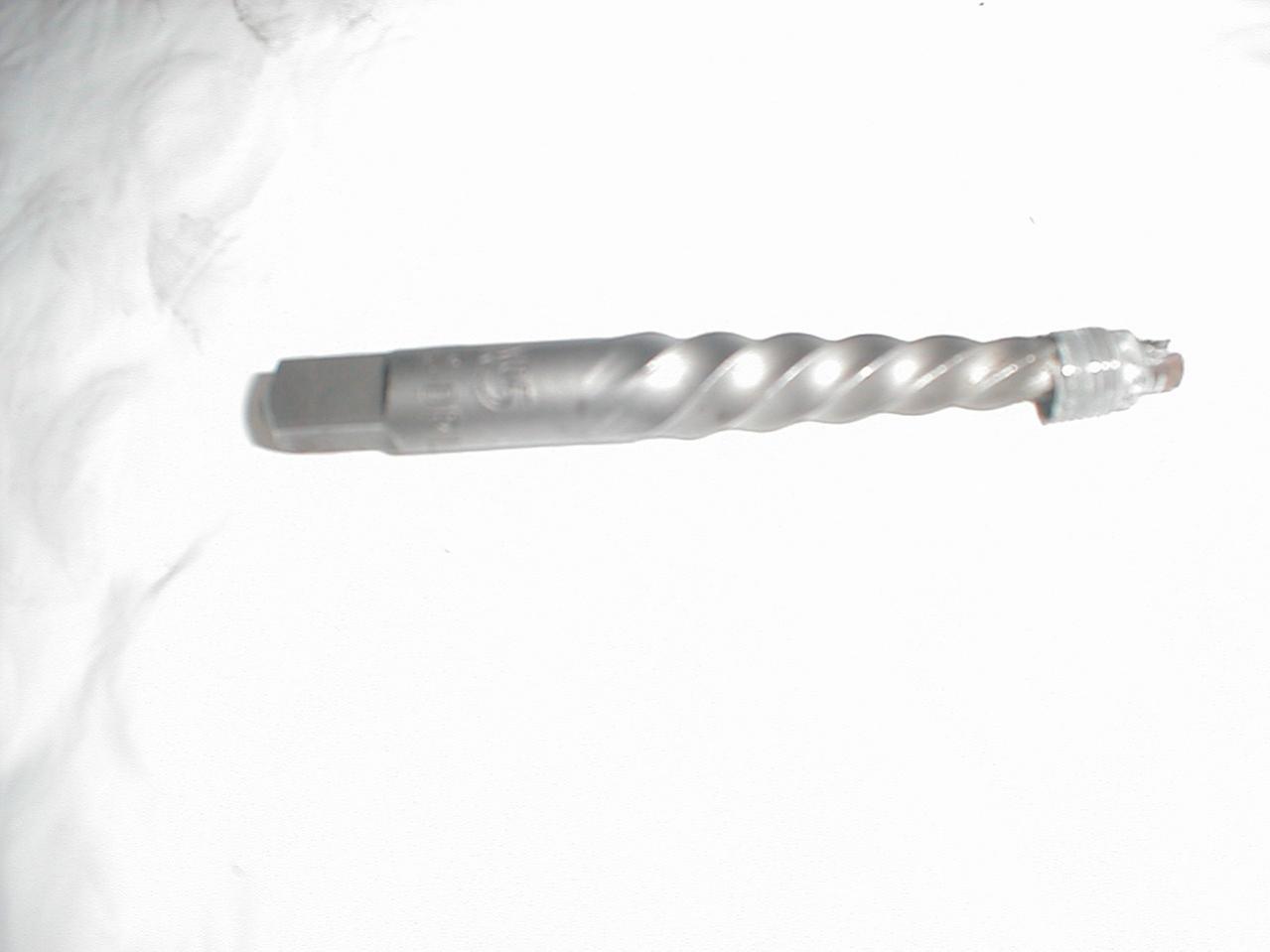

I've also changed the coolant. I ended up rounding the head on one of the caliper
guide pin bolts. Took me a whole day to get the bolt out. A new caliper from Yamaha
though is $277 so it was worth getting out. You can see whats left of the bolt in the pic.
