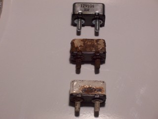

They could be under the hood too. Sometimes the protective wrapping gets water inside and corrodes the hell out of them. I belive there are three of them, 2 run the electrical system and the third one works the 12 acc plug.
They look like this...
[ATTACH]571[/ATTACH]
20 amp breaker goes to the ignition switch and the other 20 amp breaker to the fan switch.
