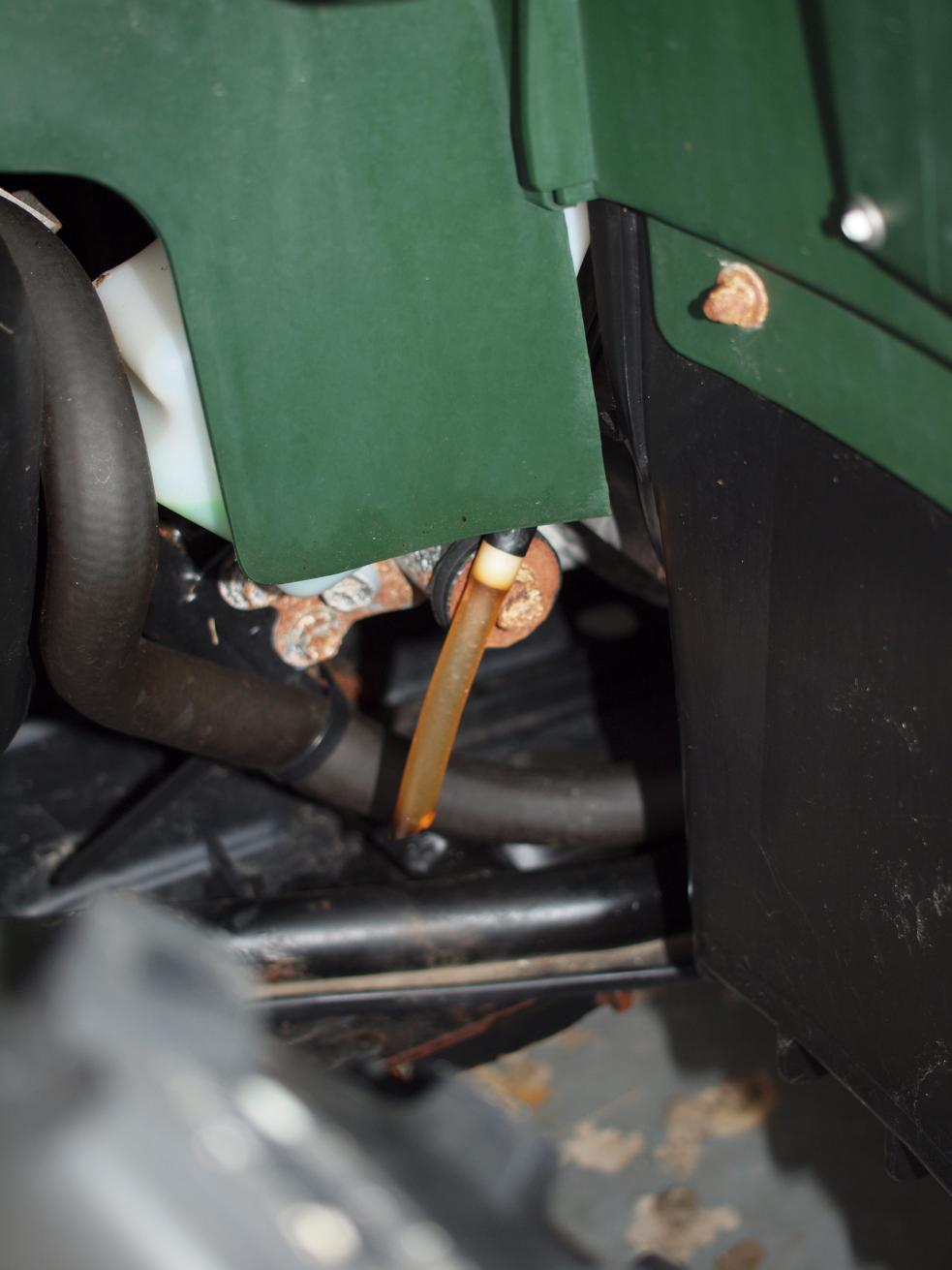

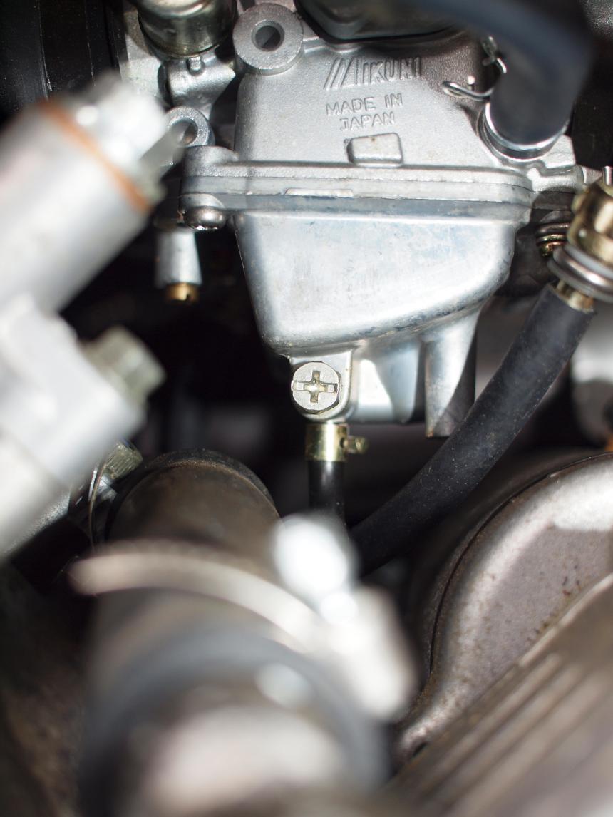

Yes, see the pics below. The small black hose is directly below the screw in the middle of the picture. The second pic shows where it drains out in the front-left wheel wheel.
Could the problem be as simple as that screw having backed out?
I think your float is stuck. Try taking the carb apart and cleaning it. Pay special attention to the float stopper and seat. Look for any debris inside the carb, if you find any, clean it out real good and get rid of the gas that is in it.
DirtDemon sounds like he nailed it. Looks like the fuel bowl overflow tube that we have on Harley carbs. Clean up the carb and see if the problem persists. If it does, you'll probably need to find out what kind of carb you have there and get some sort of manual for it to see what would cause fuel to flow out of that hose.
