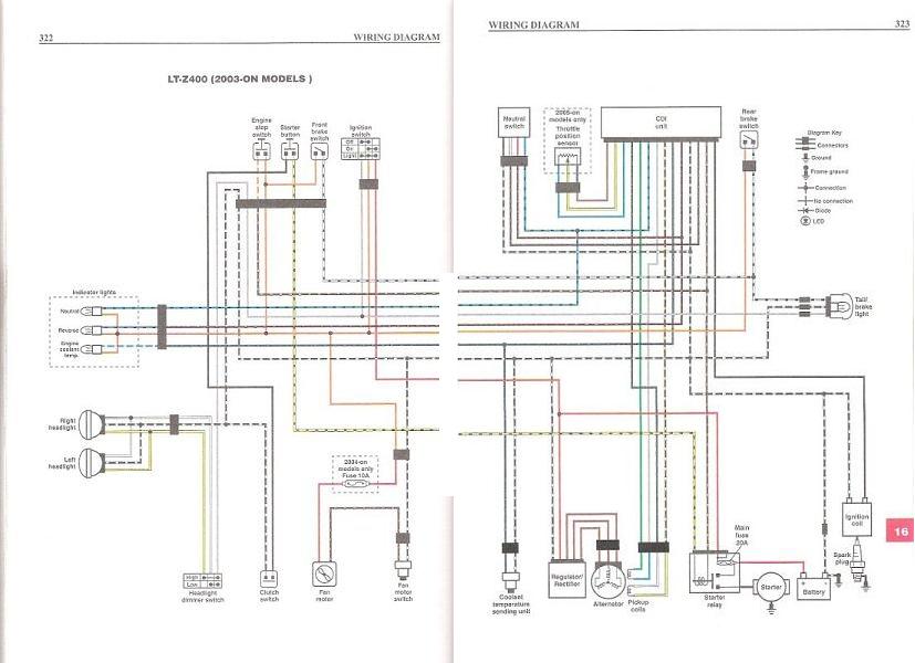

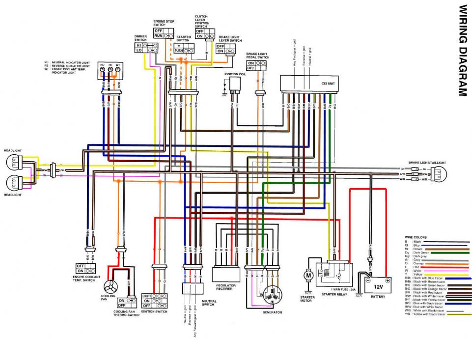

we were riding and doing some checking today and found that the 4 wheeler has been wrecked badly found frame welds etc. also found that the wiring has been tested everywhere puncture holes so i kinda tells me that it's been in a shop somewhere wish my boys would have checked it over better before they bought it. was doing some checking earlier about voltages I'm not sure that 11.41 voltage at idle is enough, to maintain battery with the fan running to cool down it go's up to 12.4 at some inter-volts at higher RPM's . if anyone has a wiring chart for this bike that would be a + at least i would know if everything wired correctly.
