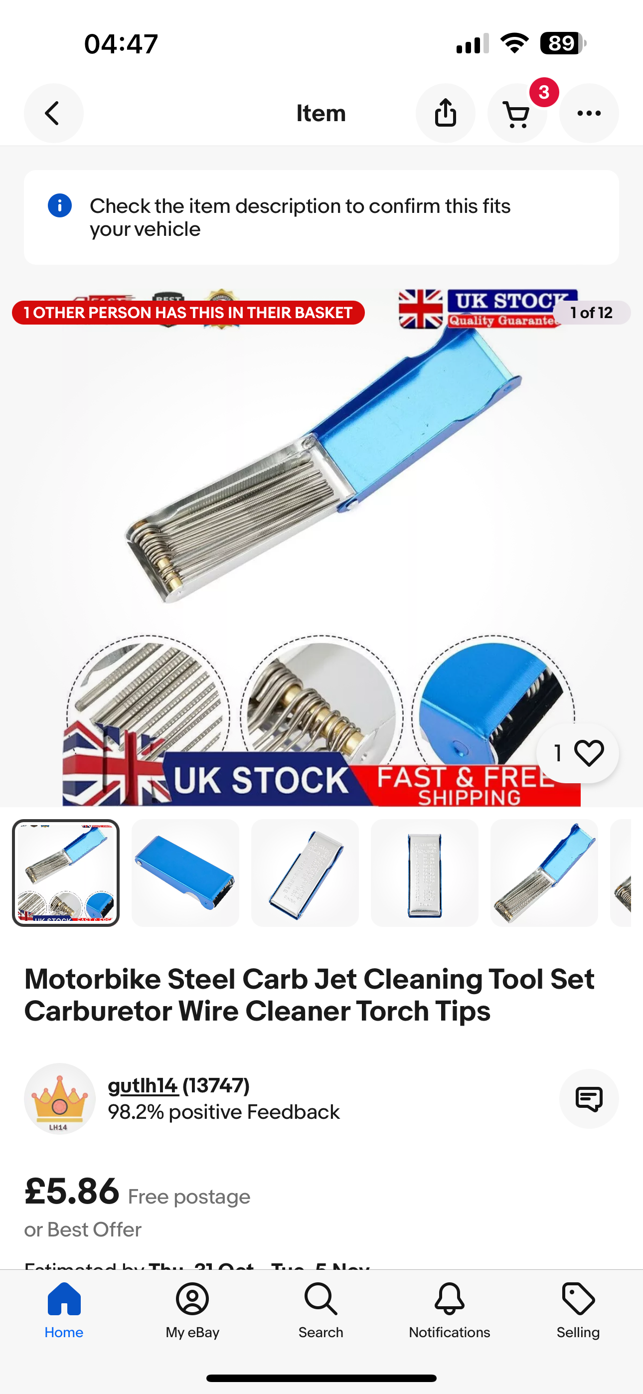

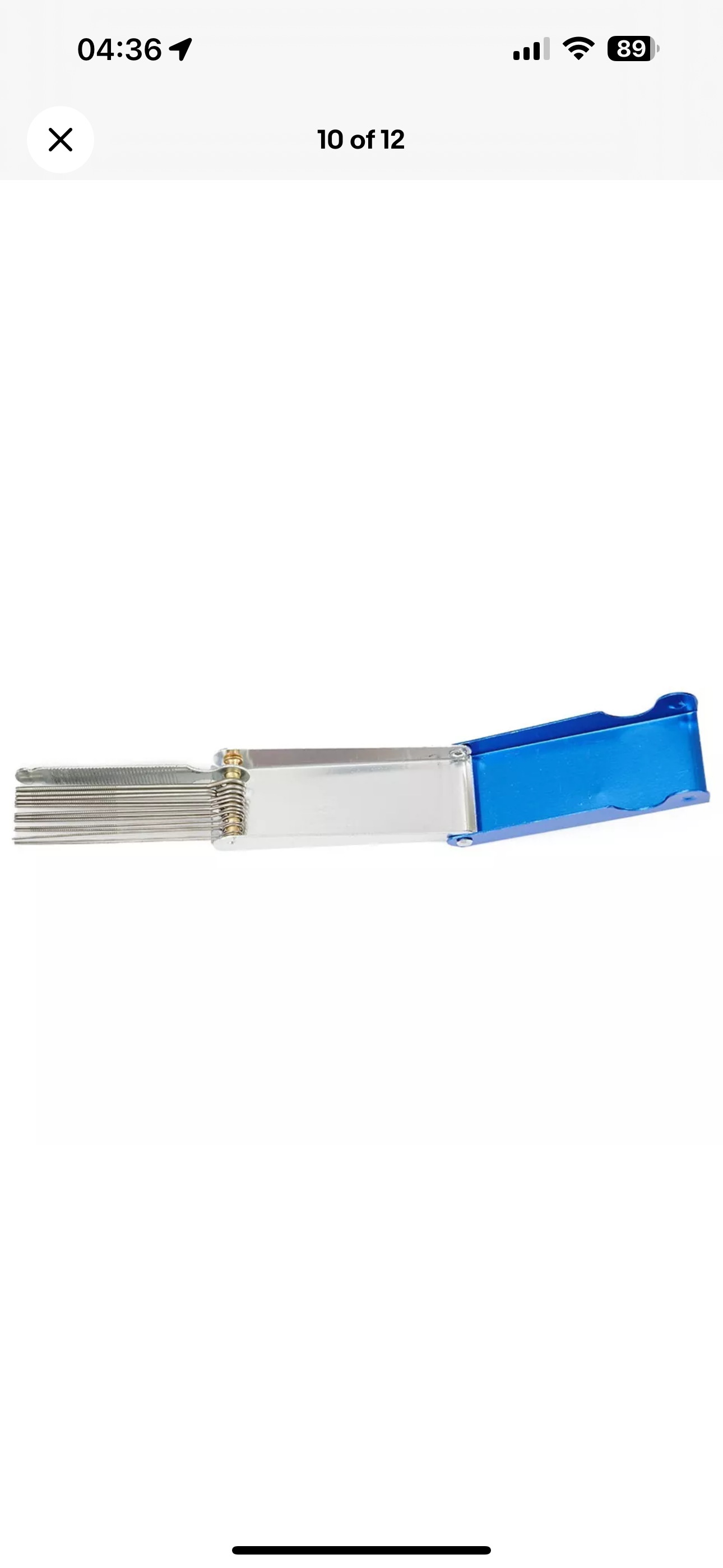

Thats a great idea, never thought of using wood to clean the jets, i guess i figured with my luck the wood would break off in there and then i would have to get that out, i have a set of carb jet tools of different sizes all hooked together so you dont loose them, you only get the size you need out. I think they are made of soft aluminum so it doesnt ream the jet out.
Oh yeah, never seen a set like that. I've got welding tip cleaners in a holder, but we should never use those !
Are the ones you have round section or square or triangle. I can't really see round section ones doing much good getting varnish or verdigris off.
The wood works really well, and if a bit gets broken off you just burn it Gw..  Simple and nothing gets hurt or reamed out.
Er matey.. Those are welding tip cleaners, and they do ream holes out. I'm pretty sure. Unless you are sure they are aluminium I wouldn't use them for jets.

Yeah and they are hardened and those ridges start new off being quite abrasive.
Wood everyone..  If it gets stuck in the jet it only needs a bit of a charing and it will come out again.. no harm done. And it gets them cleaner than any bit of wire will..
I haven't seen a set like that Gw.. Without ridges they would be better than a tip cleaner, and better than some scratchy bit of wire brush bristle(which a lot of people like to use), but I'd suspect they would have trouble getting varnish/build-up off.
Do they go down small enough to do really small jets on bikes ? I've seen cleaners advertised for jets but they never did small jets, let alone the tiny holes in the emulsion tubes.
I've been using wood for.. Err.. something like fifty years.. haha.. and it's always worked fine.
They do go down really small , and right, dont do much for caked varnish, it would be great if they made little brushes to get that off, but hard to make a brush that small, i would guess.
