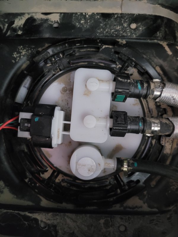

All 6 of the "locking tabs" look to be the same.  The white piece at 11 o'clock is part of the plastic seal.  I marked it with a sharpie to be able to see if it moved.
Is that what you are talking about?

The lock detent I was looking at was just a bit of dark metal I think. Not white. Check for locking tabs on the retaining ring, then bigger screwdrivers/levers crossed and a steady pressure. Lube helps and lube it all when it goes back together.
