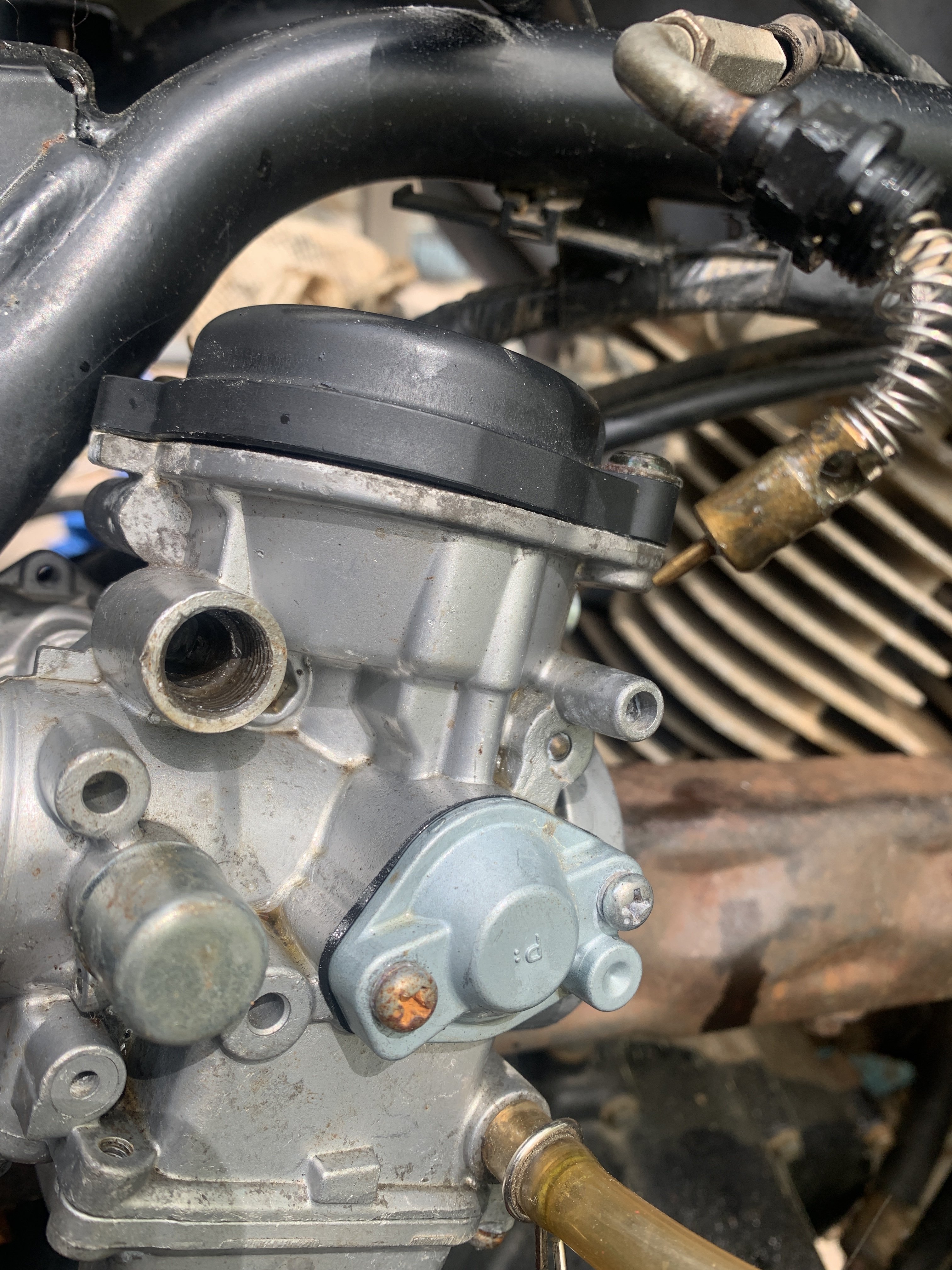

The choke lever doesn't stay in position on my 2001 Yamaha Kodiak.  The model is YFM 400.  I have to hold the lever to the choke position manually for some reason.  Any Ideas as to why?
Its possible that your choke plunger could be stuck in the bore, if not stuck completely just kind of sticky pulling the cable back. I would try taking it loose from the carb to see if its working smoothly. You can see here mine was actually stuck took me a minute to get it out, cleaned it up good and no more problems.
