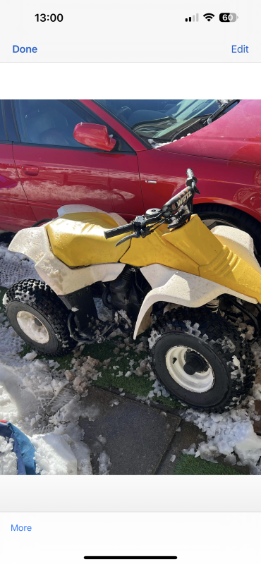

Hi everyone new to this forum, i just got a LT80 for kids to learn on but can’t get it started. There is a spark but not very good so changed coil but got one with separate cdi so wouldn’t work cleaned car but still no joy. Fuel is getting in as plug is always wet. Im baffled. Like i say there is a spark i was thinking timing might of slipped so going to try that. any help please really appreciate it.IMG_2999.thumb.png.e5c4a94deb67e922109636670dd019bb.png
