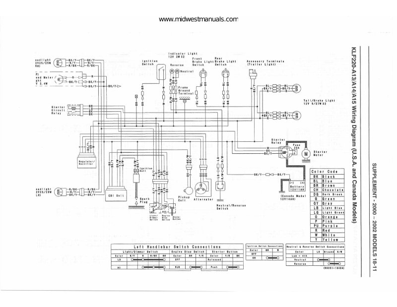

Need some help putting a new ignition switch on this thing. I'm not finding homes for all the wires. I can hook up the white wire and brown wire, But the switch has a B/W and Solid Yellow wire i can't find a home for, and there aren't any more wires in the vicinity from the harness that match this, except one red wire with a double female end crimped on, and a few B/Y grounds. None of the wiring diagrams i've founder or have been given match.
I'm also wondering if i have the wrong switch? some switches appear to have 4 wires and other just 2, the Brown wire and a White wire.
I'm at a loss here. Thanks.

That download isn't working for me, for some reason. but it does stand to reason i may need a 2 wire switch, as all i have is a white and brown available on the harness.
Replaced the key switch, CDI box, and igniter, WE HAVE SPARK! just need to slap a carburetor on this sucker,and some new fuel line and tires.

Well since i got spark, before i put a new carb on and all that, i figured i'd see if it'd pop over on some starting fluid.. gave it a squirt through the carb.. no go. made sure i had spark. i have spark. put a new plug in. Gave it a shot in the plug hole. no fire.
What gives?  I know i have fuel (since im introducing it directly), i have spark, a new NGK plug...
Well, it seems now i have no spark.... rechecked it.....
How can i go from having no spark, New CDI, Igniter and Switch, get spark. leave it alone for a day, come back. no spark.
Thats Bad, I think the first thing i would do is check all my connections and make sure they are good and tight. Im sure you have done that already. Does everything else seem to be working correctly, just no spark.
