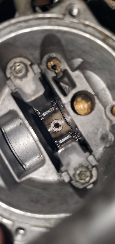

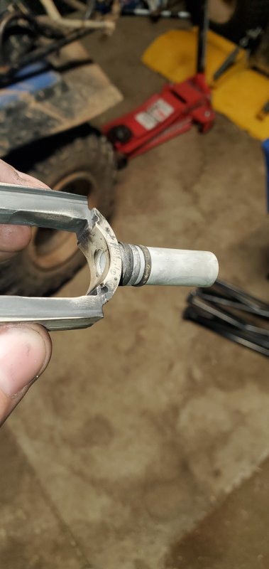

Make sure the carb isn't letting gas leak into the throat. My King quad did this and I could only figure out what was going on by looking into the carb while the bike idled. I attached the video of what was happening and a picture of the piece that I needed to replace. Also changing those o rings didnt fix the problem bc it was leaking from the center circle where the needle goes.
