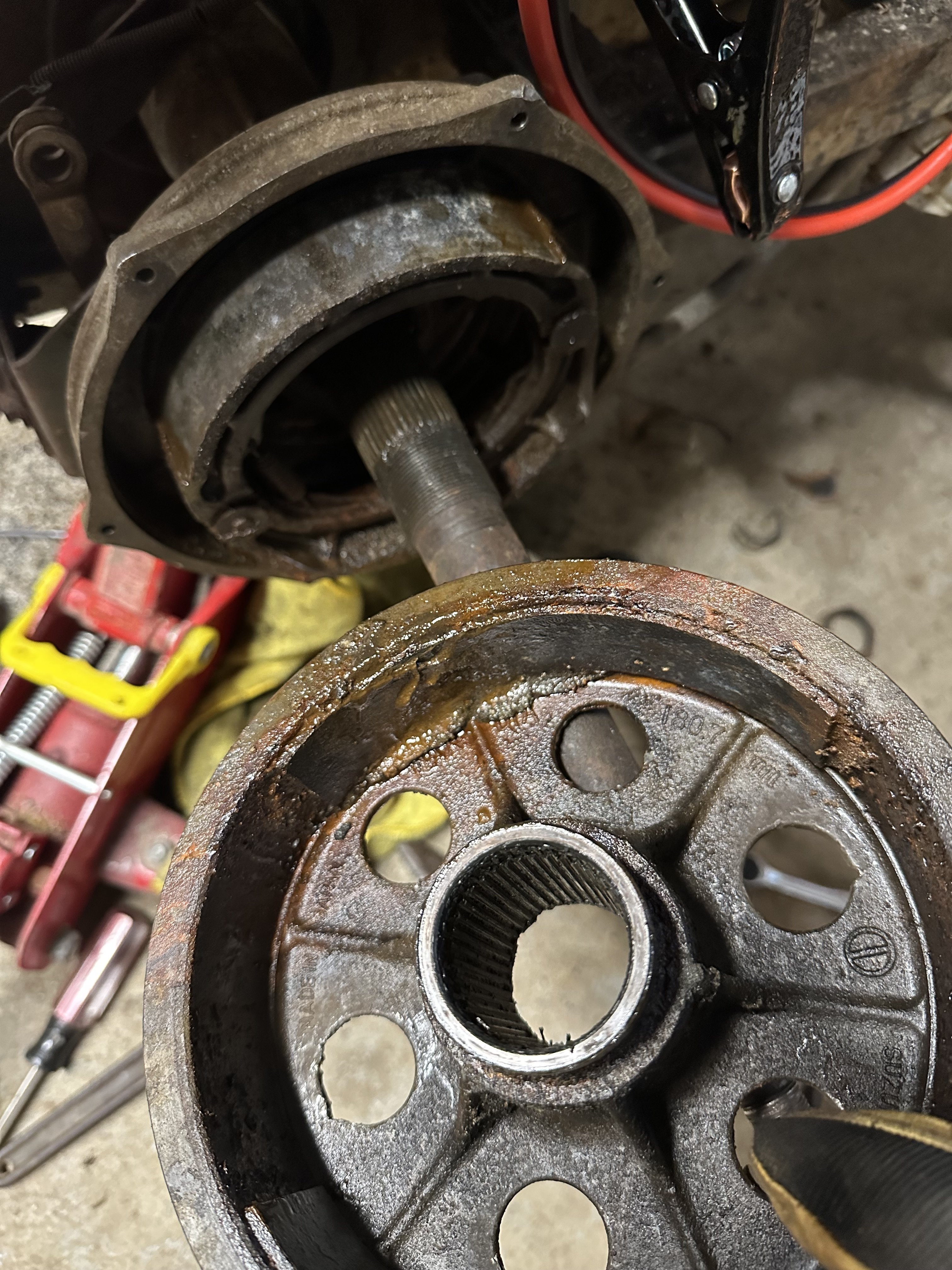

Hi all! I’ve got a barn find LT300 with a frozen rear drum. I’ve just about done everything to get this thing off aside from a torch. I don’t have access to the service manual as yet but I assume there isn’t a locking screw somewhere?

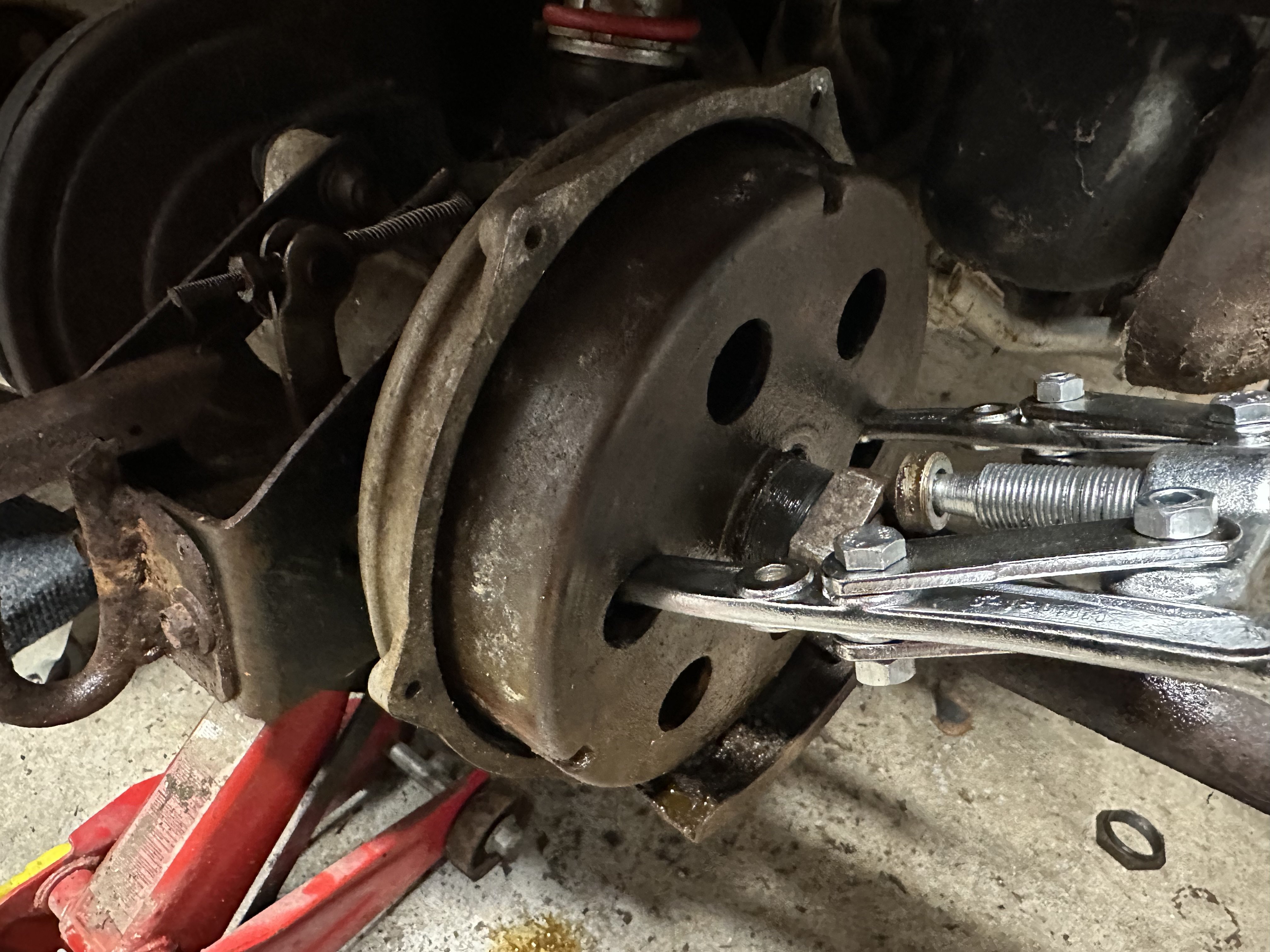

I hammered it. I pulled on it. I pryed on it. I soaked it in PB blaster. It’s just about done me in. I soaked it good and put a little pressure on it with my jaw puller to see if it loosens up overnight. Again, this bike was a barn find so I’m not entirely shocked but I wanna be sure there isn’t something I missed.
thanks!
Update: Still stuck after sitting all night with some PB blaster.  I'm trying not to hurt it, but again, I want to be sure there isnt a bolt/nut holding this drum in place somewhere?  I didnt see one, but since I can't turn the drum I can't see the entire surface inside.

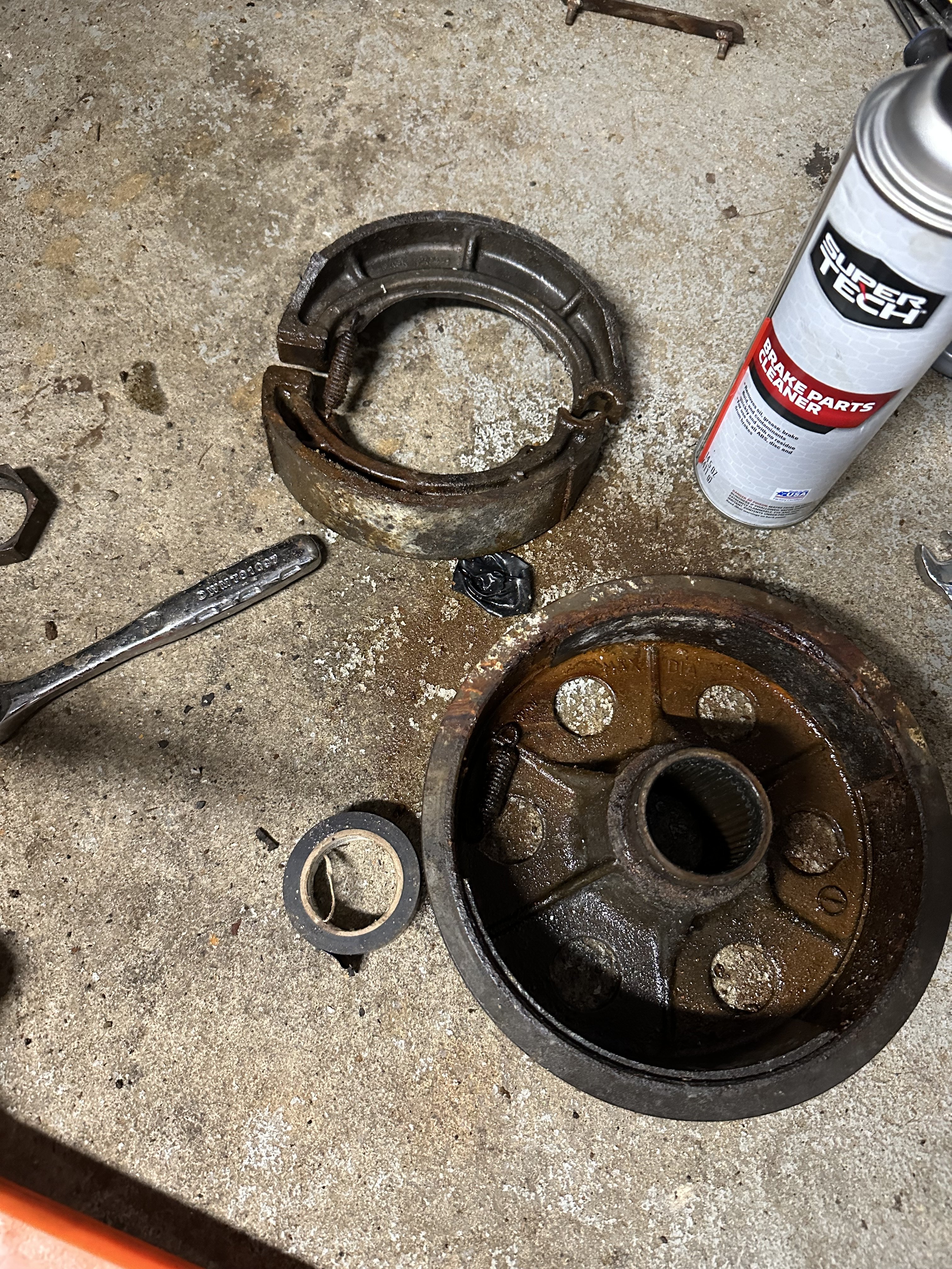

Update again and solved. (Mods didn’t approve my post until I solved it. )
shims on the shoes were completely stuck to the inside of the drum. Managed to unstick with some time, PB blaster, and a little help from my friendly map torch.
managed to also rescue the cam actuator for the brakes. I thought for sure it was done for but man the map torch came through again.
