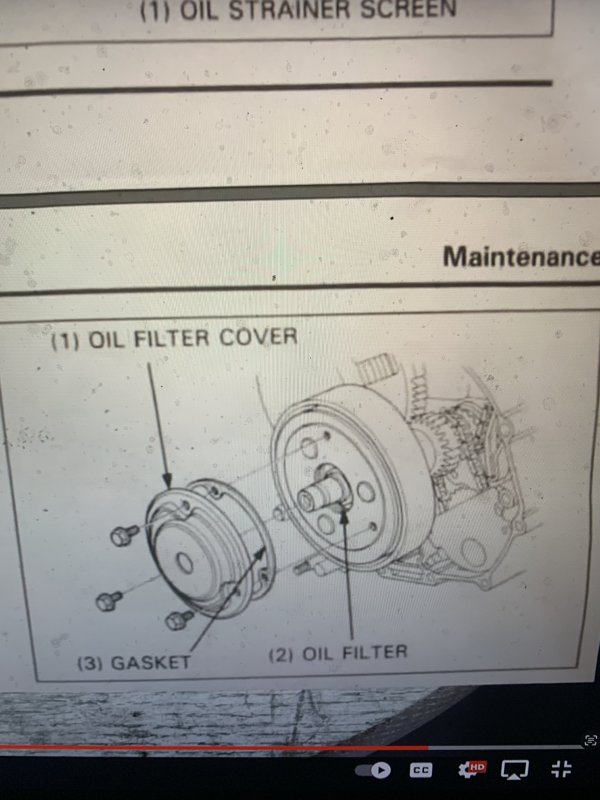

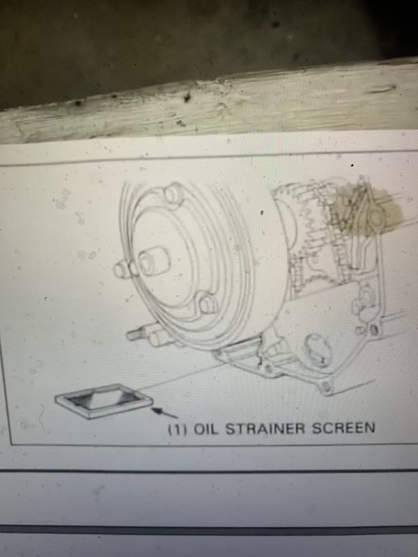

I'm thinking the clutch maybe warn or loose which is causing the rattle, not sure yet. What would be the symptoms of a warn clutch? could the clutch plates cause a clanging metallic sound. I think its only during idle, so it makes sense that the clutch plates could rattling. I'm going to take the clutch cover off and clean that out when i change the oil...I'm betting its never been cleaned before lol
I found a Clutch video here
