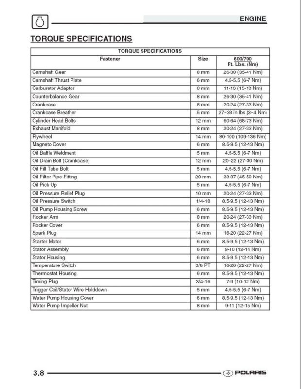

Hi I had an issue with a Polaris 325 ace . It was pressurising the water system. I’ve stripped the engine and had the head skimmed. Would anyone have torque settings and correct timing procedure/marks thanks
  • 3 months later...
Yeah that does seem a bit rare.. All I can find is 325 bigboss or magnum engines, both ATVs..
What year is it and is it water or air cooled, and carby or EFI ?
Hi it’s water cooler , efi . I’m sure there was only two years they made it . I’m sure it’s like 2016 or something age wise. Really needing procedure to time correctly as I Cant see any timing marks on the cam shaft and torque settings aswell thanks
