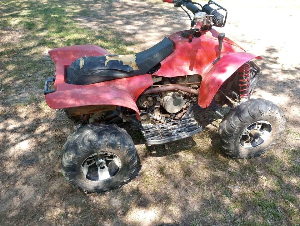

Hows the Polaris working out, I know you have had a few problems, but how do you like it, never see these in my area for sale, but ran across this one, rough shape for 1500.00, so you got a good deal on yours. Yours looks good.
341442195_6332813370104951_3913434705400627981_n.thumb.jpg.50e653c21551fac2da9e57a47b727ef9.jpg
So far, I like it pretty well. I'm going to need to replace an outer tie rod end on the left side while sitting on it. I may, just replace them all. I'll probably get aftermarket replacements. I've been trying to find out what kind of bolts I need to put the factory muffler back on it. I looked up replacement bolts but, I can't see how they could possibly work. The mounting brackets on the muffler have like one inch holes in them. The aftermarket exhaust that's on there now, has small torque head bolts/ nuts with some type of washers. I think those washers may be too small for the holes that are in the OEM muffler. I get a chance I'll post a photo of the OEM and the aftermarket. I'm pretty happy with it so far hope to get new tires on it but, I want to take care of nesecites first. 🙂
