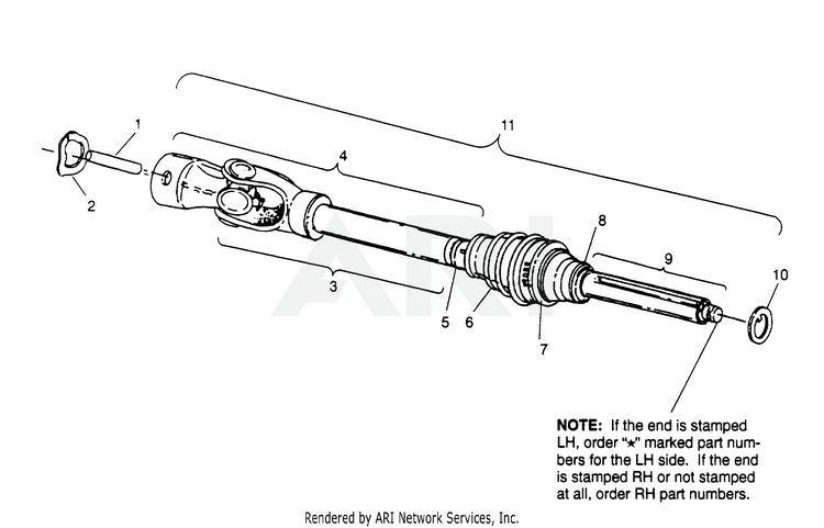

I’m having a hard time finding a replacement ujoint for my Polaris. Every parts lookup only shows the entire front shaft, yoke up to the cv joint. I’m assuming these can be replaced like any other universal joint but I’m new to this world… ideas or suggestions? it’s a 1994 Polaris 400L  4x4
Thanks for helping
The old one should have a marking on one side or the other I've seen numbers or letters and combination of both ,Wich teels you the diameter of cup and t ,if you don't have or can't see them measure the specs of without the cups on and the cup itself that should give you the size of,and cross the specs with specs of other u joints online Hope this helps
