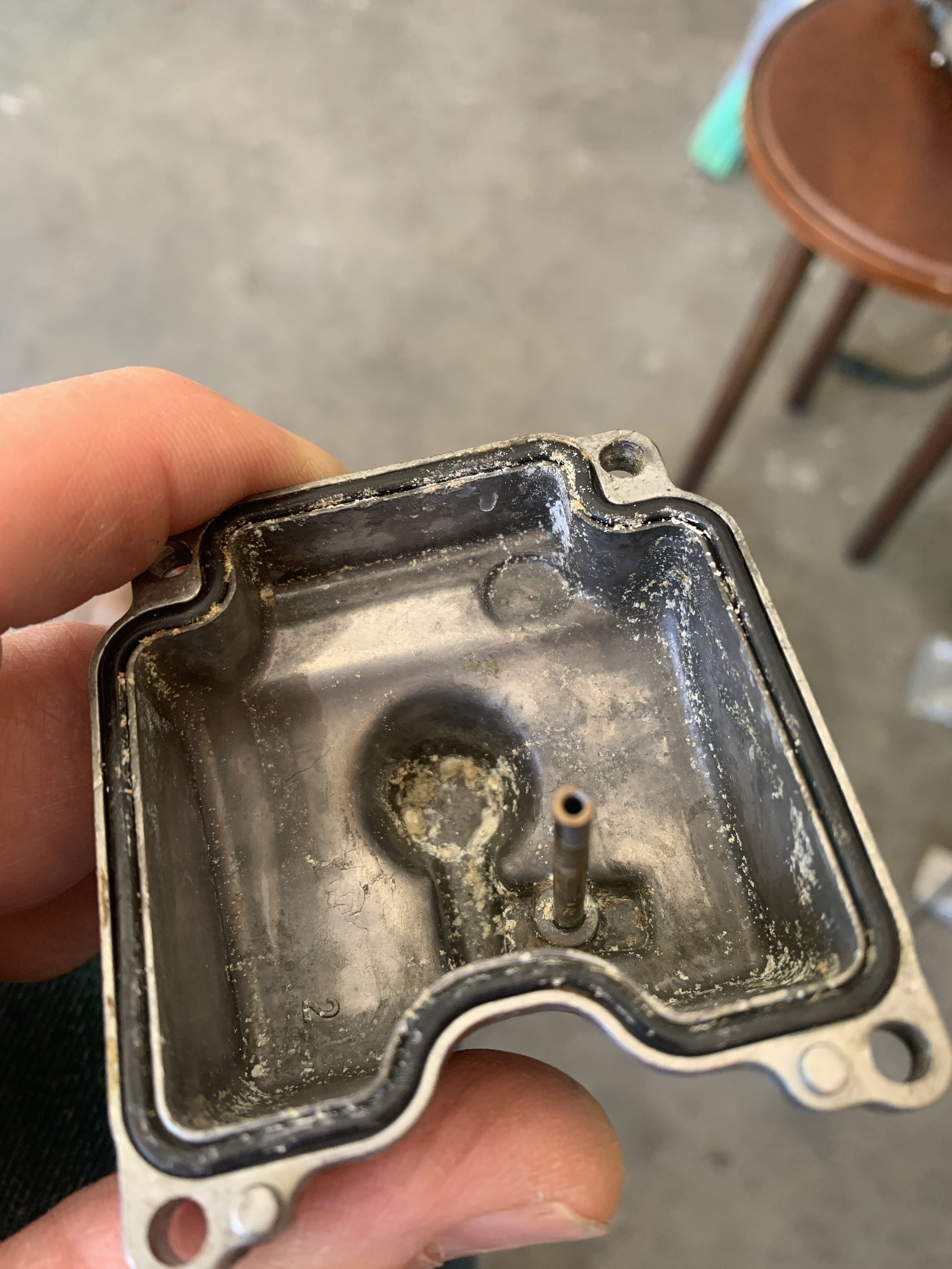

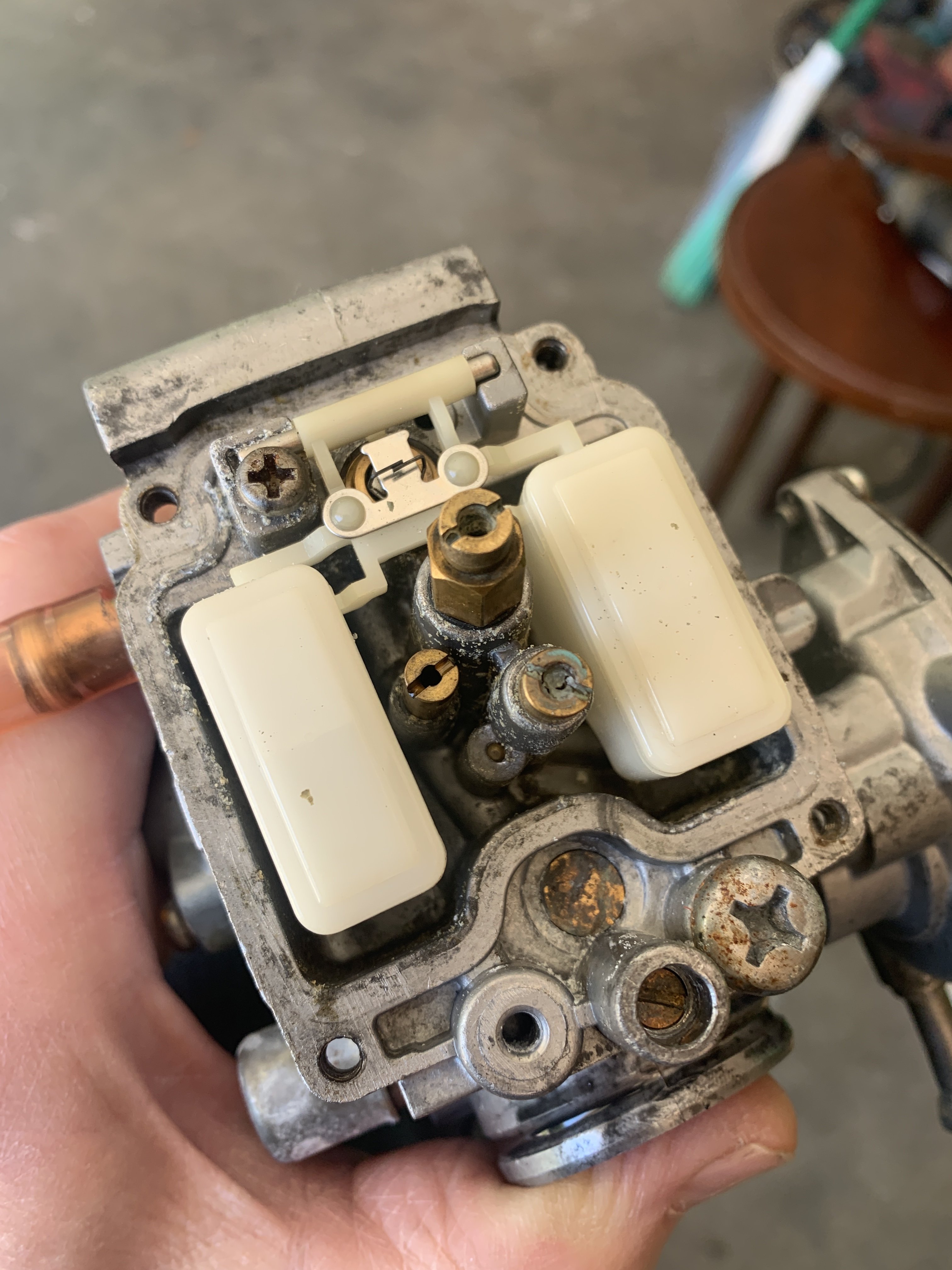

I took my old carb back off, kind of a mess, I just cleaned this last week in ultrasonic cleaner, cleaned the tank out, cleaned the petcock, and put on new hoses. Im not sure where this white powdery stuff came from. The only thing I can think of is I sprayed some silicon based lubricant in the bowl and around the movable parts, maybe the gas caused the lubricant to break down. It was Tri- Flo won't use that again. Waiting on new carb to arrive.IMG_3664.thumb.jpg.24f7c20a2faaa0f7c29034ecbc0d60b9.jpg

Thanks for the replyKP I have seen it before also but didn’t think anything about it because the carbs were in really bad shape, but this one seemed cleaner before, I wonder if it has something to do with the heat or soap I use in the ultrasonic cleaner, I don’t use really harsh chemicals unless the carb is really bad with dried varnish on the inside and I only used dish soap on this one
