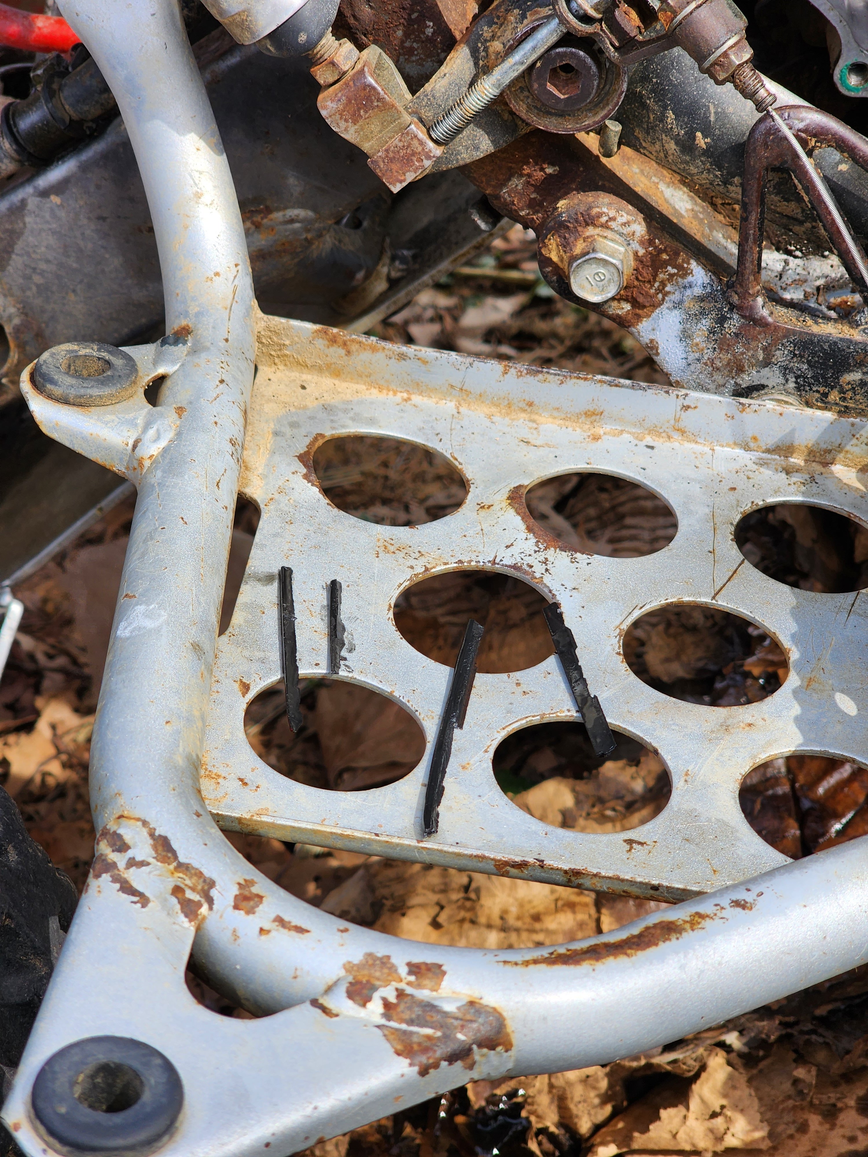

Things were going pretty good untill I screwed up. The main drive gear shaft had left hand threads but, I had to try taking it off with my impact the wrong direction. I know, the nut is ruined I don't know for sure about the drive shaft threads but, I probably, ruined it too. 😞 There are some plastic pieces also. I'll post a couple photos.   Photo of shaft threads may be ruined, and photo of some of the black plastic pieces.

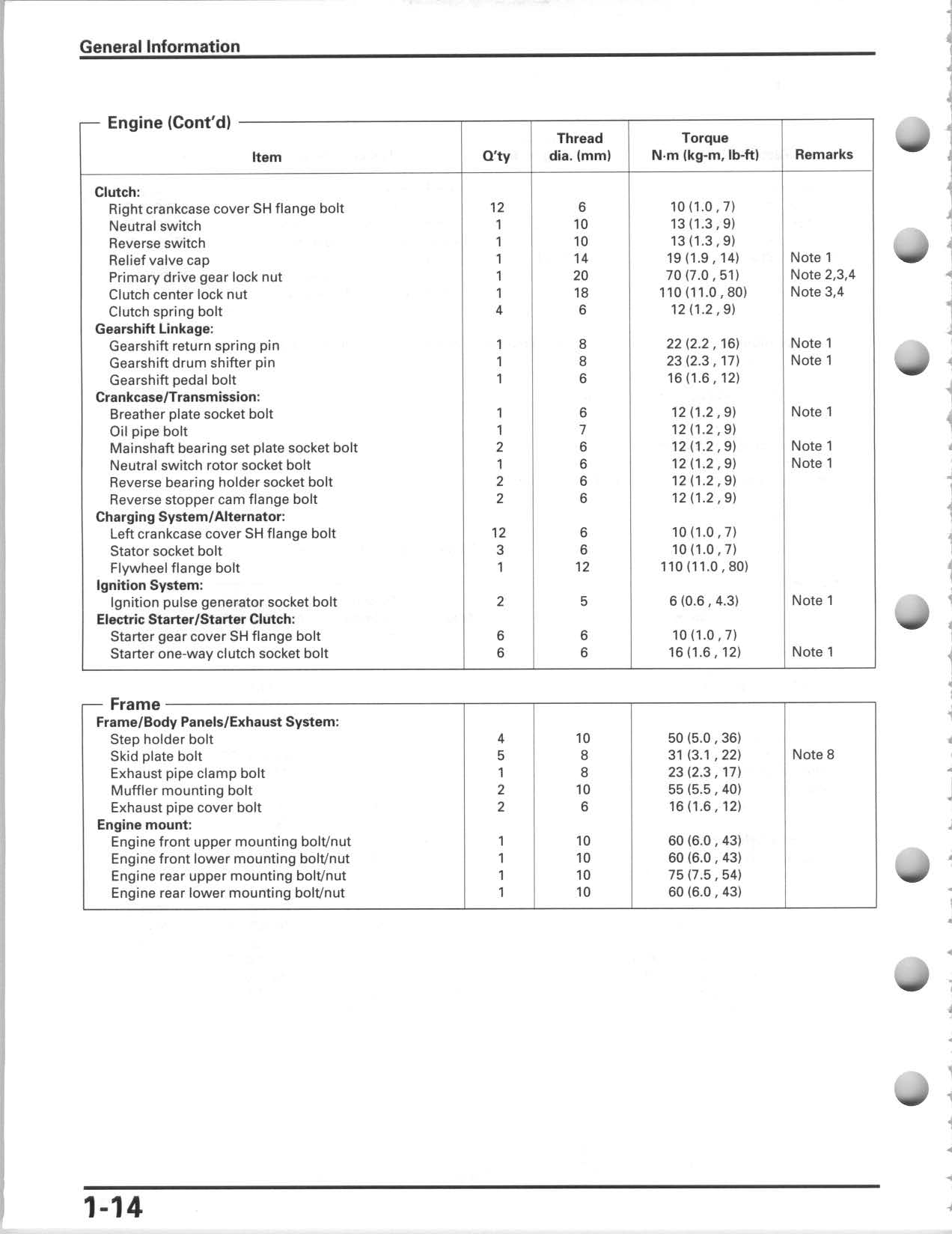

Good manuals eh ?
Too late, I already bought it lol! I'll check the place you recommended because I guess I should get the chain guide and the plastic tensioner which, I think is what the broken pieces of black plastic are from.
Just checked OEM part $9.36
part # 90235-HAO-680 Nut, Lock,(20mm)

I hope, I'll be able to get the nut to thread on. I'm thinking since the nut is so smooth on the inside that a lot of what I'm seeing on the shaft is fill in from the nut threads. I guess I should look for a black plastic tensioner piece at least, since I'm pretty sure that's what broke. It's the one that's bolted in I wonder, if I took the bolt out if I could pull it out and get a better look at it? Thanks
