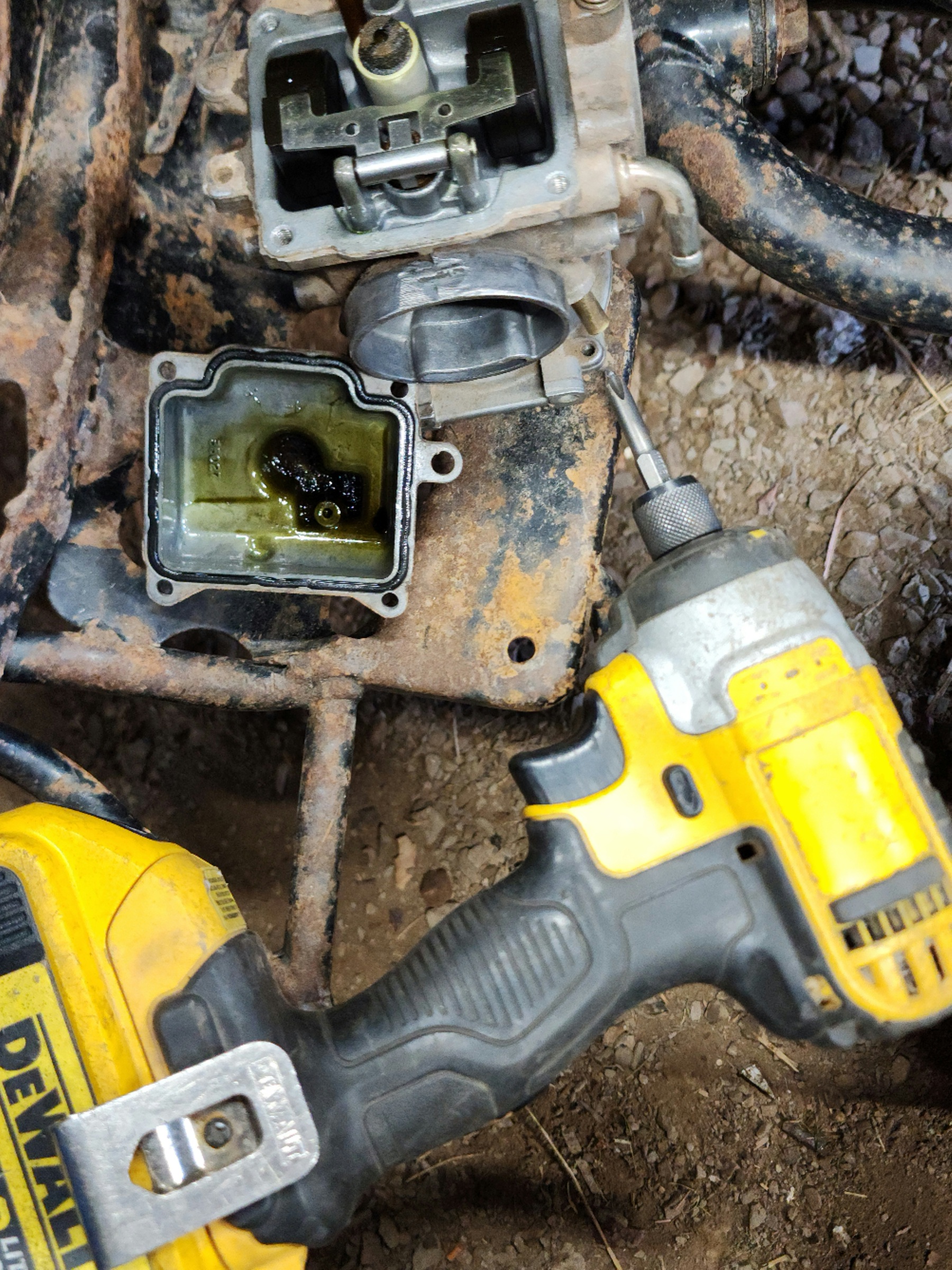

Nastyyyy, parts washer is probably next on my tool list, for now it's brake cleaner spray and a variety of brushes, stuff cleans everything, smells to high hell tho.  It's kinda of awesome that they can be put thru that kind of hell and still come out running, battery location is almost as bad as yamahas or polaris is my only complaint with these machines. Unrelated but my favorite bit of advice is anti-seize everything, I love myself a little bit more everytime I have to remove a bolt I've removed once befor lol.
I was lead on a dentist office demo and refit. Got my pick of goodies. A nice set of Craftmade cabinets that I resold and an ultrasonic cleaner. It's big enough that I can fit an HD head in it, and it has 3 transducers. The thing rocks. I'll hose it with brake cleaner first though. Years ago I bought a Harbor Freight table top parts washer. Fill it up with diesel and it works pretty good.

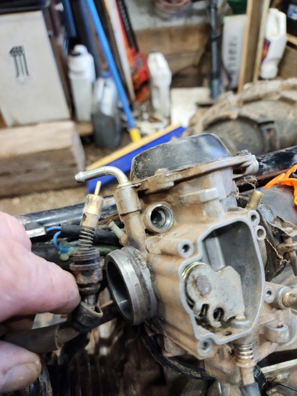

20 minutes ago, Gwbarm said:
Not so bad , no white powder.
No amazingly enough it still had some gas in it. The tanks still half full.
And yup, love the silver  stuff.

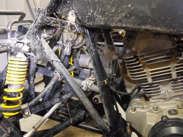

A Porta Power does wonders too. There's one bent spot on this frame, one of the lower bolts for the front bumper things missing. So when somebody rammed a rock it bent. Its the bumper rather than the frame really, you can seenwhere it caves a little.  Your buddy got lucky. Now the bolt centers are off. The lille bottle jack is sitting next to it to fix that. Works wonders indeed. Hydraulics ate great for moving stuff. I completely tore down my Bayou, sandblasted everything, primed and painted it. Rebuilt the top end so I didn't look like a fog machine. Put a fan on it from the junkyard.  A horn just cause the motorcycle switch I got to control the fan had a horn button.  I had access to a very nice selection of metric ss socket head hardware so swapped just about all the fasteners. Put a winch on it. Ran all that through individuale relays. Found a set of plastics on Ebay for $100.00 with free shipping. They screwed up their listing and didn't want to piss ebay off so they honored the deal. It was a 2wd but I surprised a lot of people with it. That was my first atv. Been thinking about moving the battery to where the storage box was. Some front weights a good idea. The hills here ain't molehills.FH2.jpg.a8095603691de35003d1c39827e19825.jpg

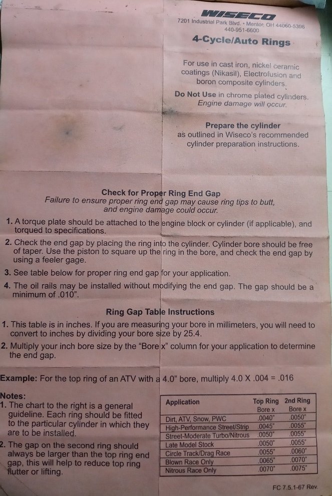

You file the ends off for a bigger gap.
24 minutes ago, Kibblesnbits said:
So wait, are you saying you cut your rings? Do they not come the right size? The ones I get come with the piston
The directions that come with the piston specify the ring gap to make according to the type of engine mods you have.  I just take it a step further to be absolutely sure the gaps never close.  Big gaps won't bother anything with an engine with such a long stroke.
Here's Wiseco:
Adjust the gaps according to the amount of heat you expect.  My quad pushes a plow in summer so although it's not nitrous or blown it generates a lot of heat without any air movement.  Plus I have a high compression piston.
Once the rings expand due to heat and the gaps close then it has no where to go except to expand into the cylinder wall.  Once that happens the rings won't seal and it will burn oil.
So then you have to hone it to roughen the walls and that roughness is used to cut the new rings so that they seal well.  That's why a lot of guys say to ride it like you stole it when you first put it back together in order to seat the rings.  Of course that is an issue with a lot of debate and no clear right answer.

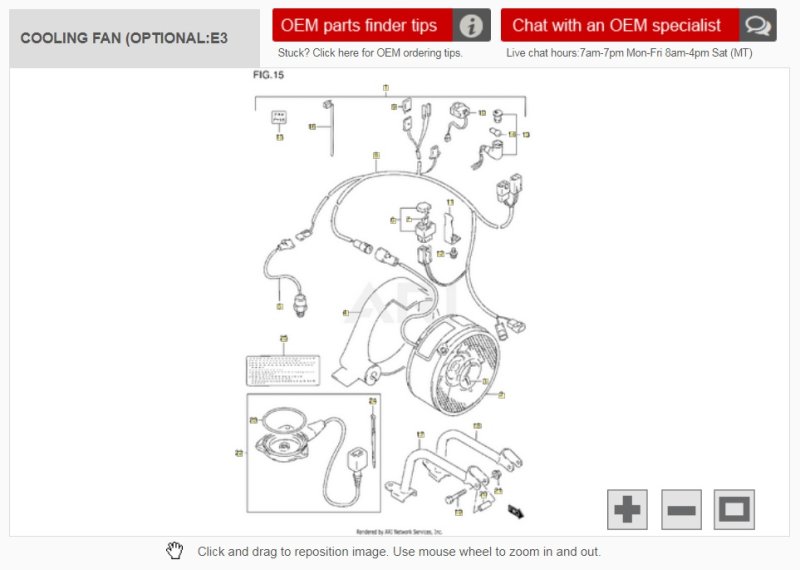

There used to be an optional cooling fan you could buy for the King:

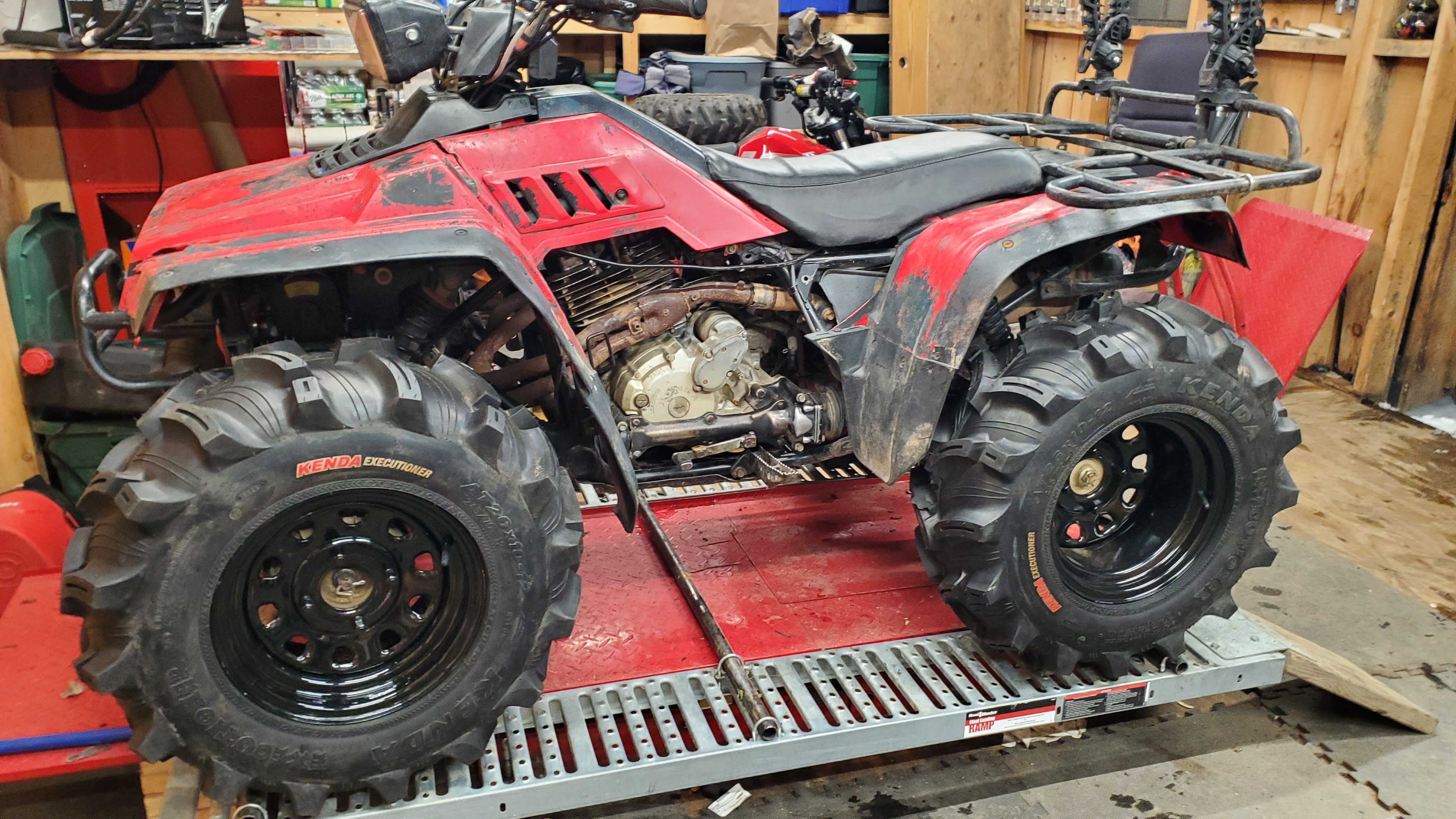

Wow those are some serious tires.
13 minutes ago, Jim Denton said:
I will indeed. When I get to having a winch again. If dragging something I'd make sure to bight the log with a chain, won't hurt that sliding over rocks. I usually wrap a choker if it won't see rocks or gravel. The biggest thing to watch in my opinion is keeping the wrap tight. If it loose it pulls between the lays and can be a bi*** to get back out.
They grab hard, gave me a bit more clearance and the rims gave me a bit wider stance, really dialed this machine up to 11, we got a swamp path outback that's so wallered out we haven't been able to cross it in 2 years, she marched right thru it like a boss, cant run in the higher gears any more but I never really did in the first place. The seudo lockers I got really come in clutch for the deep stuff too. She also needs a rebuild atm tho :/ my lift has a waiting list lol
