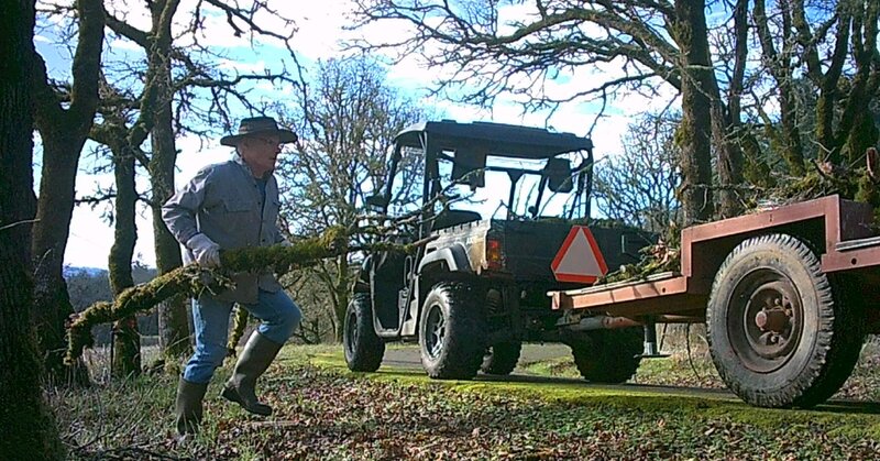

Well, it's been three months since I bought the Axis 500.  I've got about 60 miles on it in approximately 40 uses.  No problems to report.
There are some things that annoy me though:
Worst is the gear noise.  I reported that last time, but it doesn't seem to be changing.
The safety inter locks are also annoying.  I leave the seat belts clipped together all the time except when I take my grand-kids on a ride.  Gotta be a good example, you know.
In order to change between H, L, R, you have to step on the brakes hard, or it won't shift.
I really like the dump box for the stuff I do.
I used the winch to pull a log off one of my trails.  The winch seems to be a realistic size, and can skid all four tire.  No need for a bigger one.
Chores I used to use a wheelbarrow for,  I use the buggy.
I need a better name for it.  whoopy, buggy, quad, ATV,  whatever?
