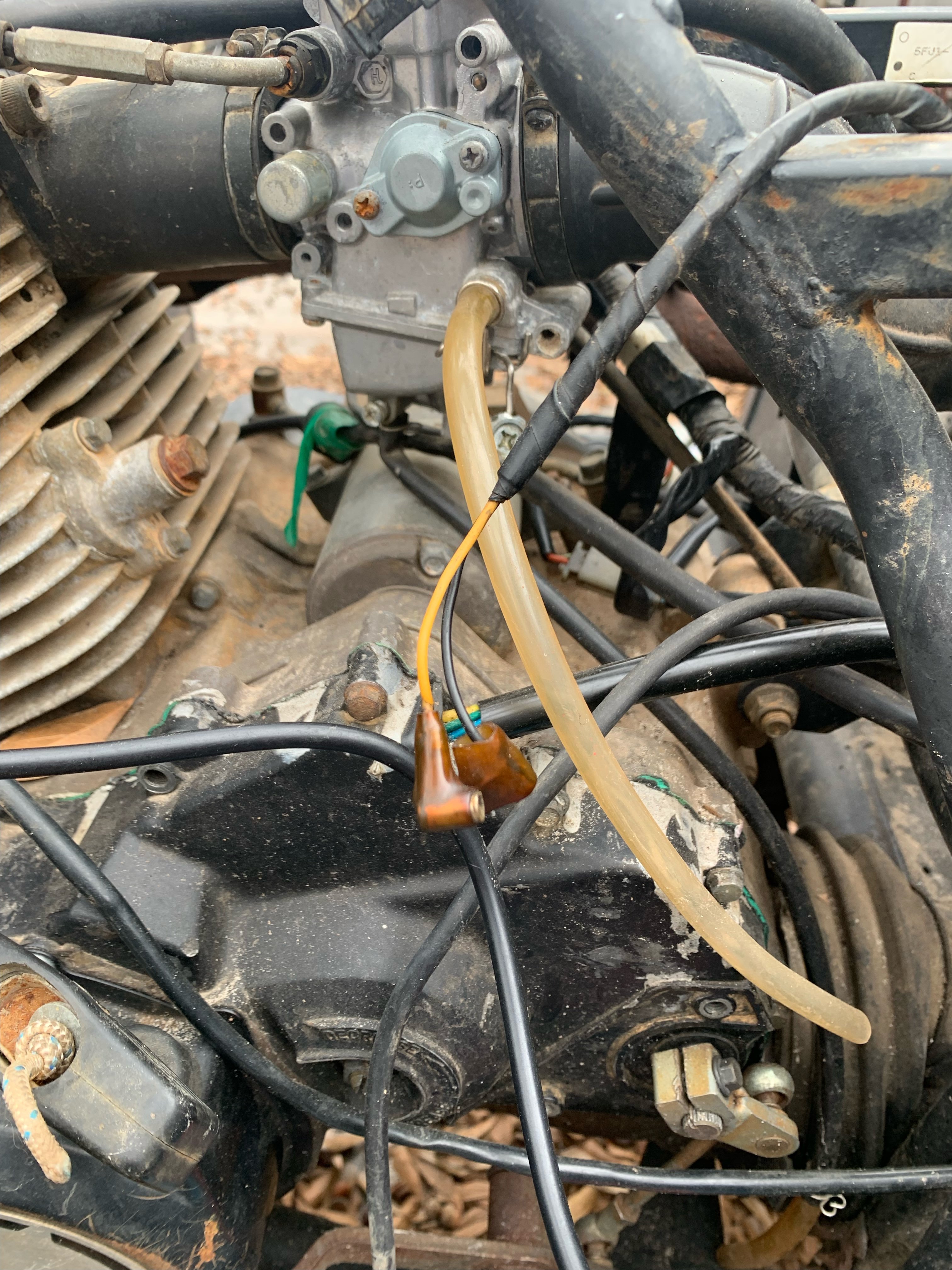

I do not have the lights wired up the fan ground is unhooked because when I hook it up the fan runs horn is not hooked up and these two wires I haven't figured out where they go yet my guess is the carb heater which appears to be missing.IMG_3471.thumb.jpeg.90adb87f15b82af20ed1435f507028ae.jpeg

are those two wires for the carb heater? I never connected mine since it's an aftermarket and i don't think it has a heater. I've read that you don't really need it unless you live where the temps are way below freezing.

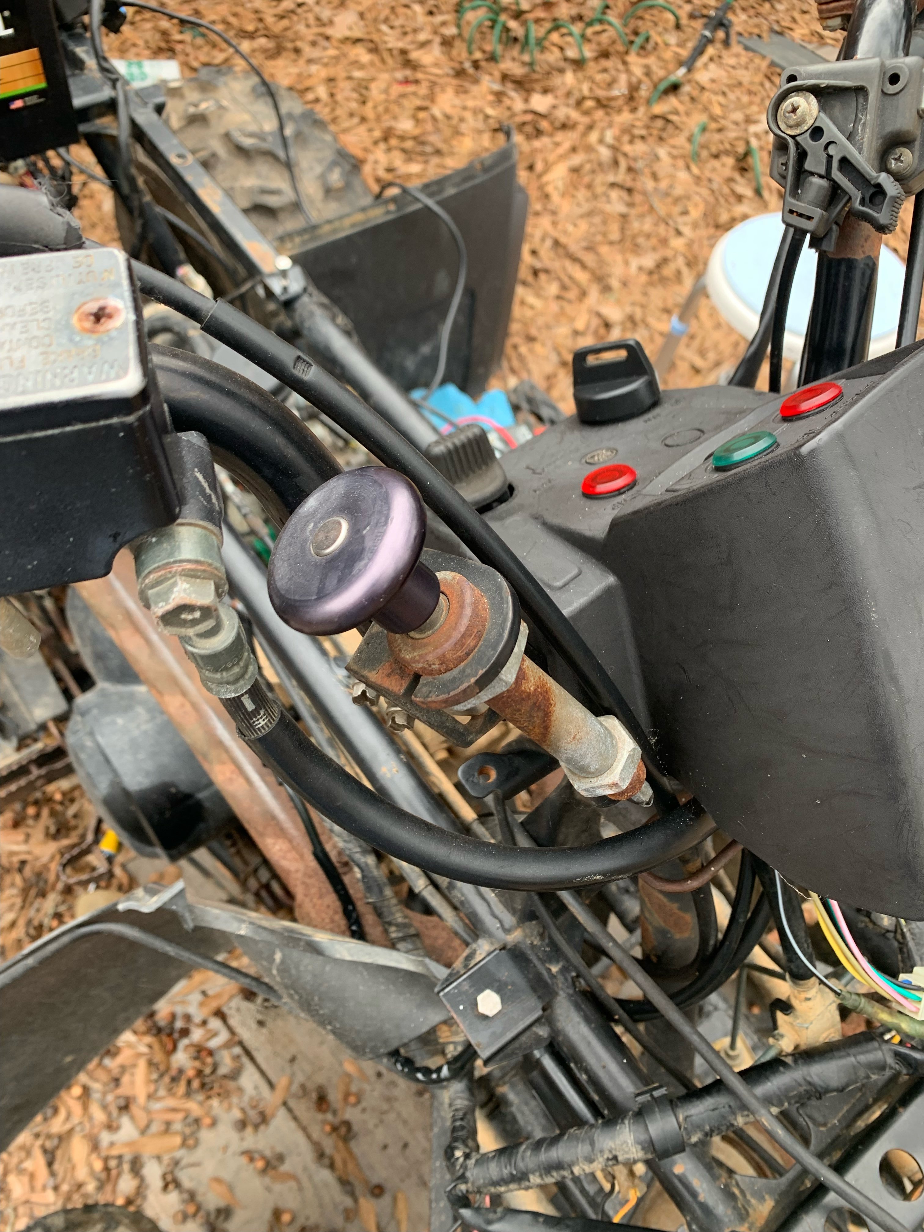

also, that lever in your other picture...does that engage/disengage the front drive? I read these are full time 4x4 and that would be a nice option, or did someone install that? Need more pics!  lol
None of the diagrams I have show a carb heater.

Not sure what those wires are for yet at first thought they were added to my harness but if you have them they went to something the only yellow wire found on schematic s for lighting I haven't got that far yet. The big knob has a cable that goes to front differential it doesn't look factory I thought these had an electronic switch for switching from 2w to 4w I don't have that what does your have. I just bought this thing in July and just getting around to it.

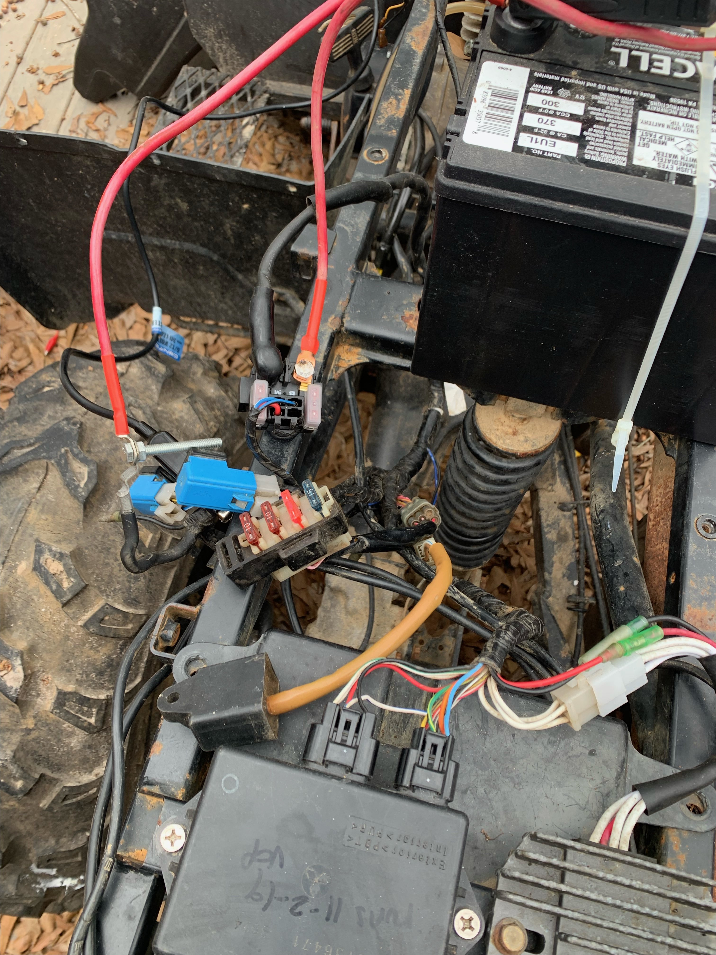

Thanks Mech! Finally got the starter rotating with the start button, the cutout relay is bad, there is another identical relay in the harness next to it , it was also bad , not sure what that one is for I looked it up last night and now I can't remember, the joys of getting older. I temporarily put a jumper wire to take place of the relay, still nothing. I checked all the connections again and found a ground wire that bolts to the coil I had left off. I did that because when I attached it the fan would run continuously, but that ground was the problem. Not needing the fan to run now I unplugged the fan from the harness. The starter now rotates with the button and I have good bright voltage where it needs to be. Still no spark yet, but I will continue looking for that problem. I did notice the CDI had a date hand written on it of 2019, im assuming that's when it was replaced. At this point I think I will just start checking for correct resistance on all the coils and go from there.
The other relay is for the reverse light, but it's a special one with an internal diode..  They can't be swapped, and you should check they haven't been swapped over..
The reverse light circuit also connects to the cdi and stops the cranking if the reverse signal isn't right. The reverse switch is normally open unless it's in reverse. When the switch is open there is 12v going through the relay's diode and windings, and that is going to the ecu and the reverse switch. As long as the reverse switch is open, the ecu will see 12v on that G/W wire that goes to the ecu and reverse switch. When the reverse switch closes it shorts the relays windings to the earth, meaning the voltage on the G/W wire drops to zero, which the ecu detects and so prevents cranking. It means you need that relay in place with the 12v going through it's windings and into the G/W wire or it shouldn't crank.. If it is cranking with only the one relay in place, there is something wrong I think.

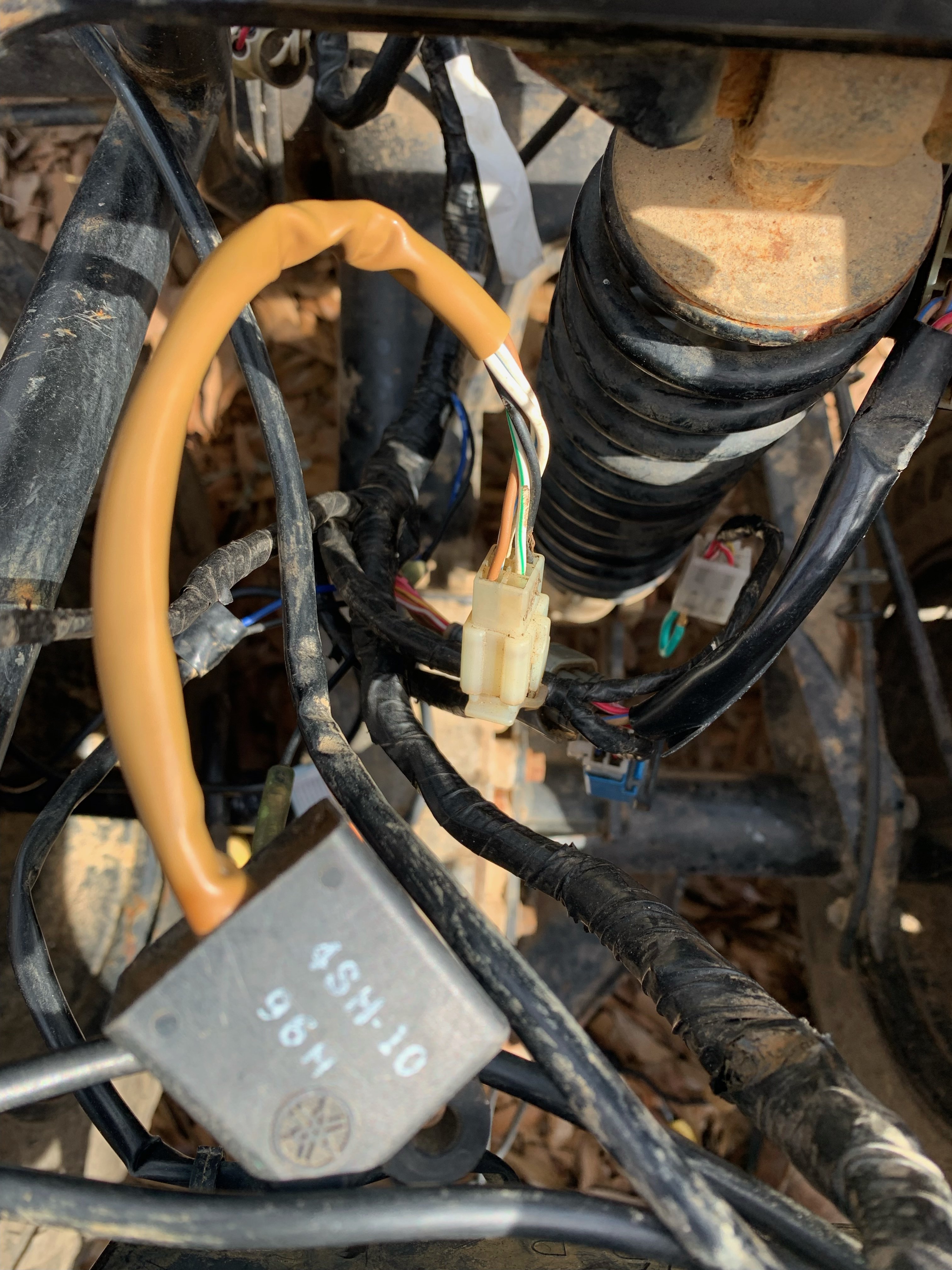

Thanks for the info , they look just alike I will have to check to see if they have been swapped because I tried both in the starter cutoff harness and neither worked, they are the blue things in the photo, also see the other black box just in front of the CDI think they called it the engine controller I haven't tested that to see if its goodIMG_34682.thumb.jpeg.9310db3e07fd6913fa117ed76f403a5c.jpeg
The reverse relay is in the main wiring diagram at the end of the manual. Part 23. See there's a dotted box around the relay.. and the diode is inside the box.. That means it's a part of the relay.
And that other box you think is called an engine controller... well I hope it's not.  haha.. None of the three manuals I've been looking in show any such thing..

its the Fan Motor Controller. They list it as a "motor controller", they just left out the word "fan"
the two relays...one is a starting circuit cut off relay, the other is the reverse relay, and my post above describes the Fan Motor Control Relay
In the books I'm looking in there is no fan relay..  There's only the starter isolation and the reverse relays
Could it be the fan's circuit breaker ?
How many wires does it have Gw, and what colours ? It should be identifiable by it's plug and wire colours.
I didn't see one on the schematic im looking at either, also when I was looking up parts at Motorsport they showed both cutout and reverse relays the same there must have been quite a few different variations on the 2000 model. The wire colors for the motor controller are blue/white, green/white, brown, black,IMG_3497.thumb.jpeg.fba71a37b16f419d12a6911041146a01.jpeg white
