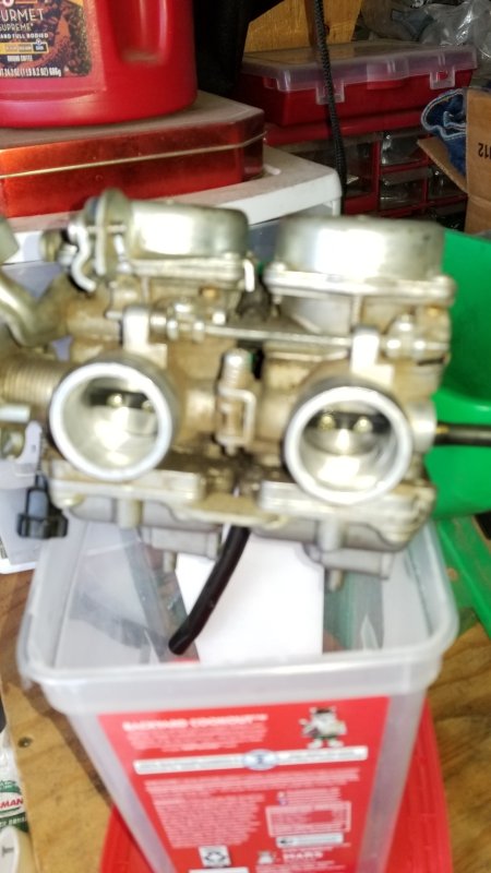

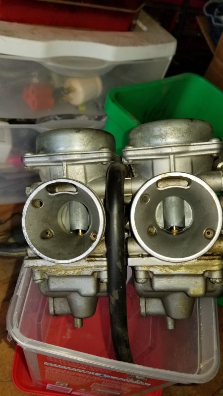

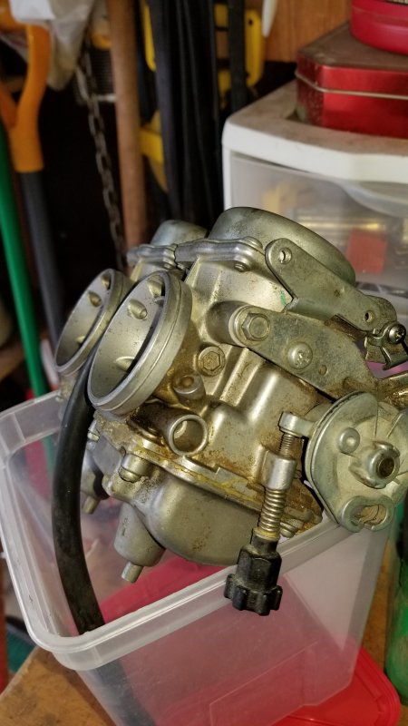

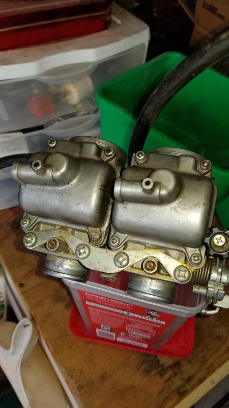

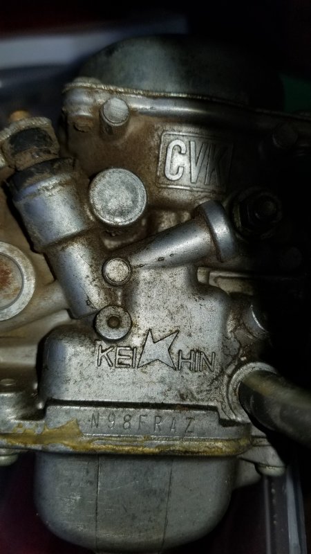

Time for another question from a rookie......I got spark to both cylinders and put a splash of gas in the tank to see if I could get the engine to fire, it does with a shot of ether so I want to try gas.  When the gas reached the carbs, it flowed straight through.  I'm thinking of replacing both carbs but not sure I can find exact replacements.  Any thoughts about this ? Thanks!!
It's a atv my neighbor "donated " to me.  I've sorted out most of the electrical issues and am moving on to see if it will run.  I've got it to fire with ether,  and ran into carb issues trying with fuel.
