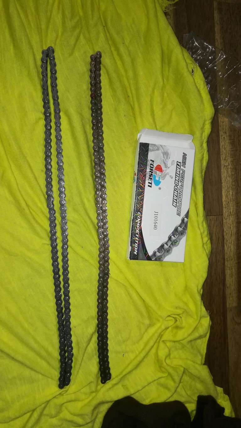

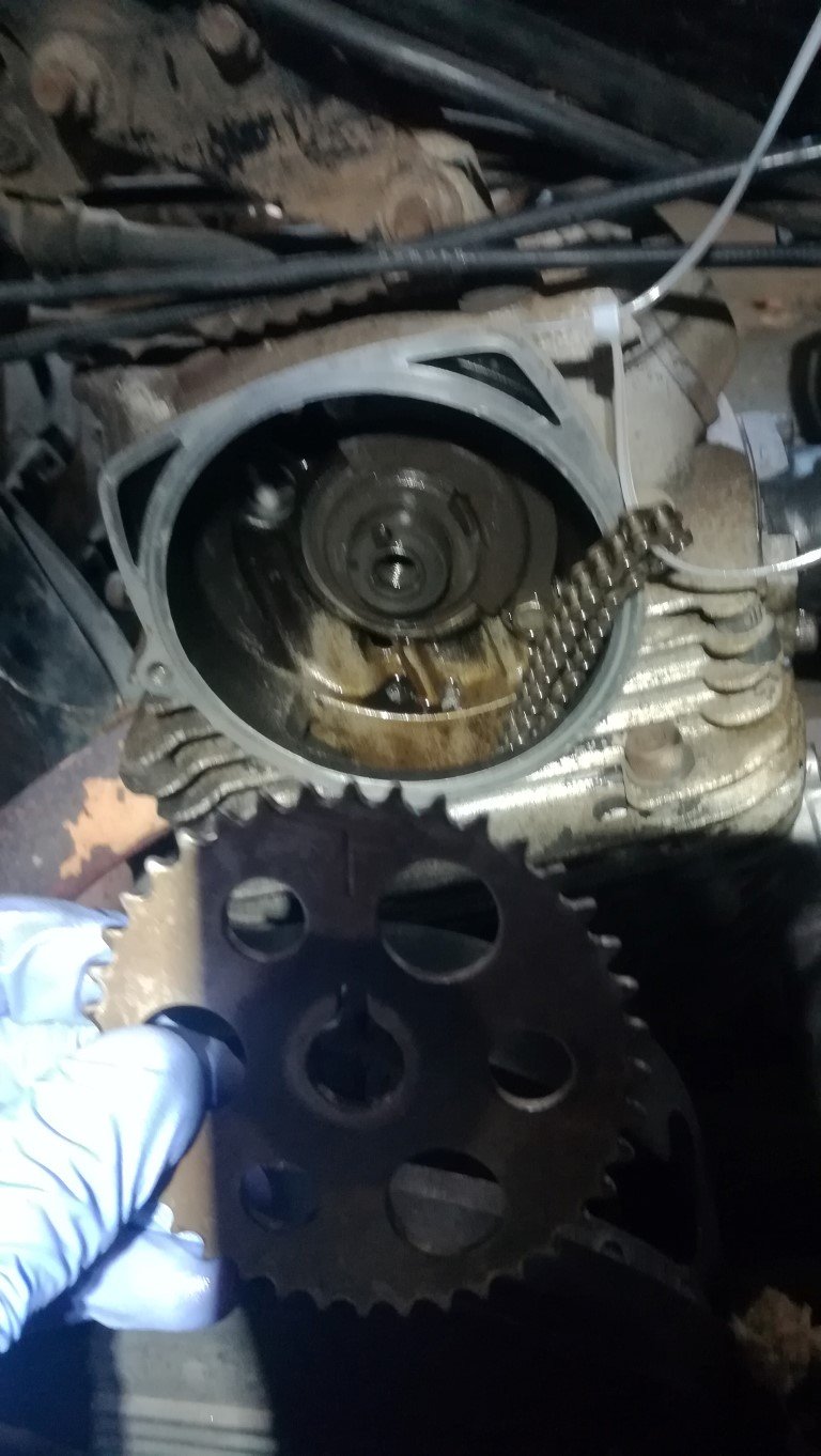

- Couldnt get the timing marks to line up, stretched chain!

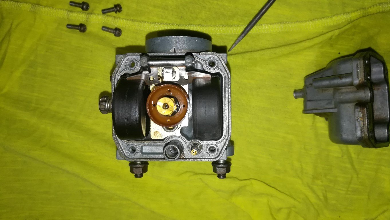

- someone had been into the carb in the past becuase the float was upside down, aso was leaking fuel quite badly

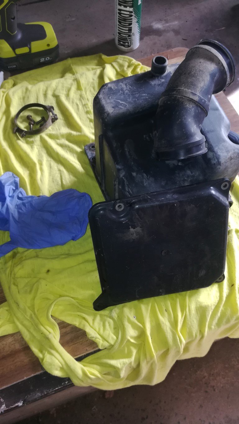

- airbox was missing the cage, so i brought a complete K&N unit

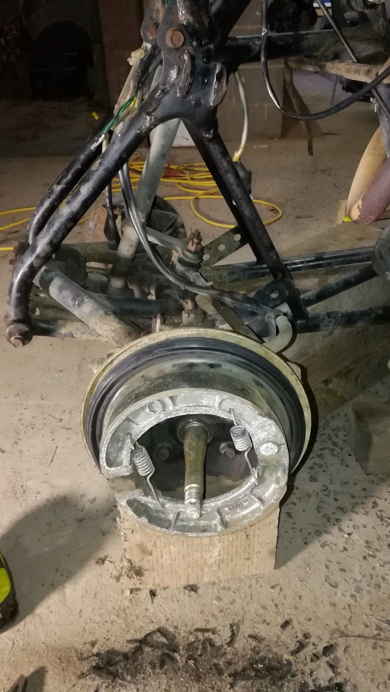

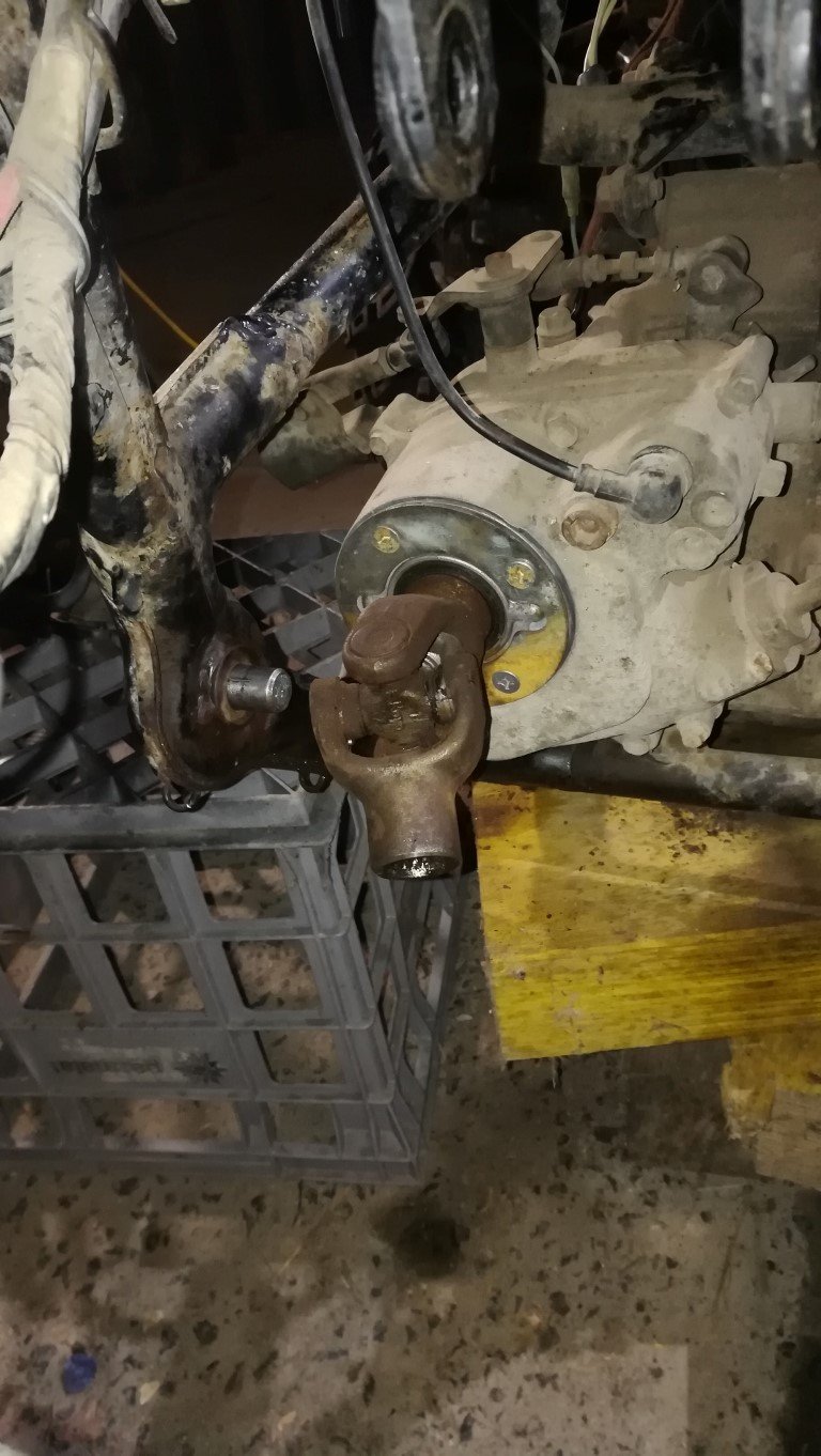

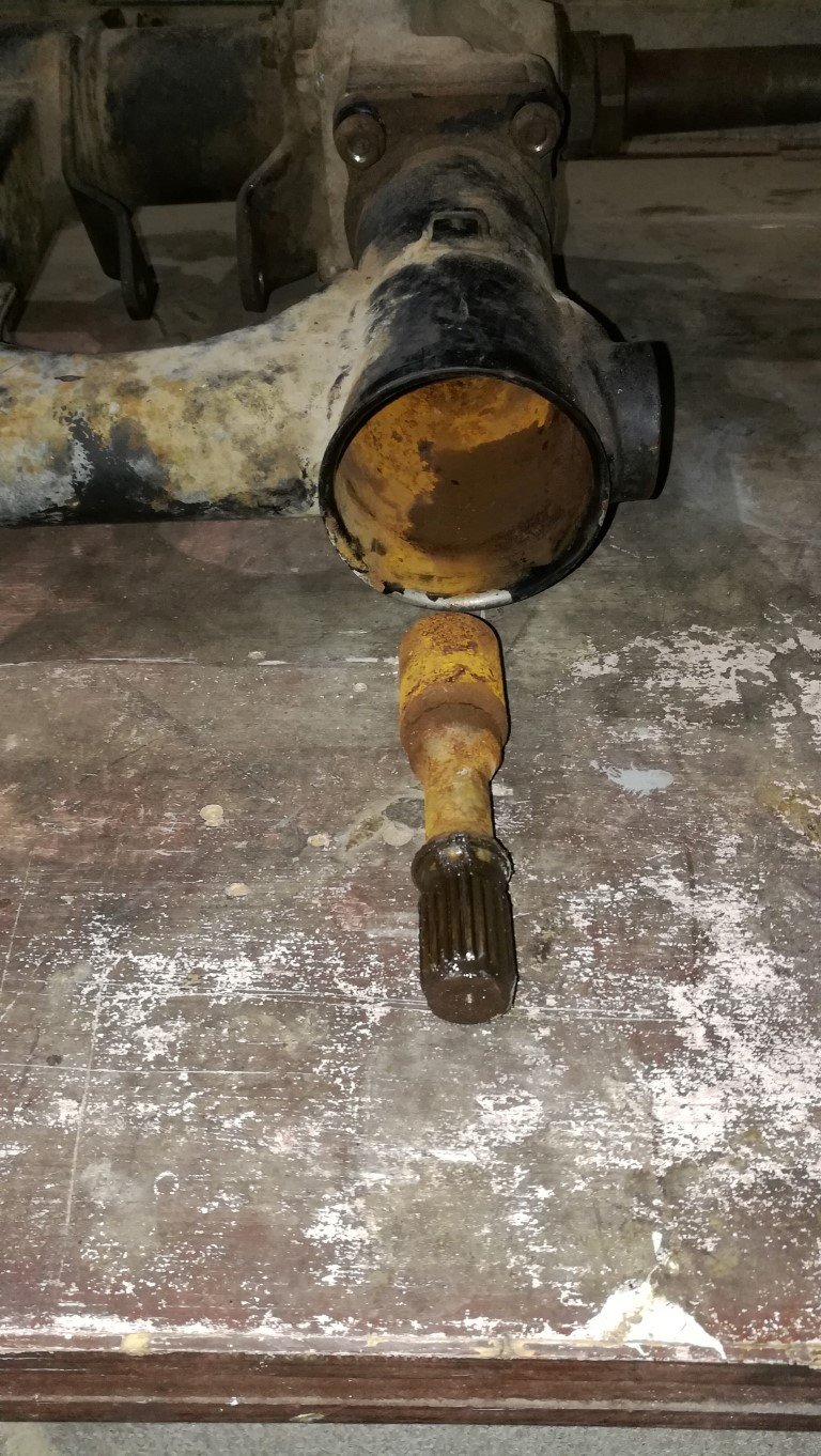

- Swingarm bearings were destroyed!!! What a sage to get the swingarm bolts out!!!! all cleaned up and ready for installation
- currently working on the front end becuase there is a bit of play in the bearings
