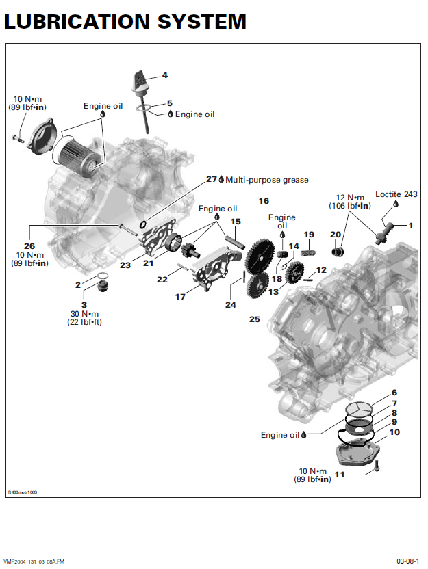

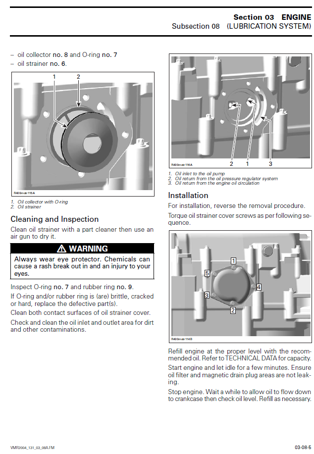

The oil strainer is on the very bottom of the case, just above the frame member. It can be removed/cleaned without engine removal but you DO have to unbolt the engine mounts, remove the exhaust pipe from the head, and very carefully lift it up. The strainer has 5 bolts (8mm socket). I would also VERY highly recommend removing the decompression weight/spring/pin from the end of the camshaft if that hasn't been done. It's a ticking time bomb, and well known over on the can-am specific (only can-am) forum. I just finished getting mine back up and running. It's easy to tell if that has been done, just remove the valve cover and its right there on the right side (behind the cam chain/gear).

You may clean the oil strainer at the base of the engine case without removing it, but you'll need to remove the engine mount bolts, remove the exhaust pipe from the head, and carefully lift the engine up. Five 8mm socket bolts secure the strainer. Since this is a recognized problem with Can-Am vehicles, it is strongly advised that you also remove the decompression weight, spring, or pin from the end of the camshaft. If it has been completed, remove the valve cover and check the right side behind the cam chain and gear.

I just had the same problem on my 2006 Outlander 400. It was the oil pump. It is made of plastic.
The oil pump is steel parts's.. But gears are plastic.. Not very common problem but they come some times...
BRP Parts Catalogs
21 and 22 are steel ;)
