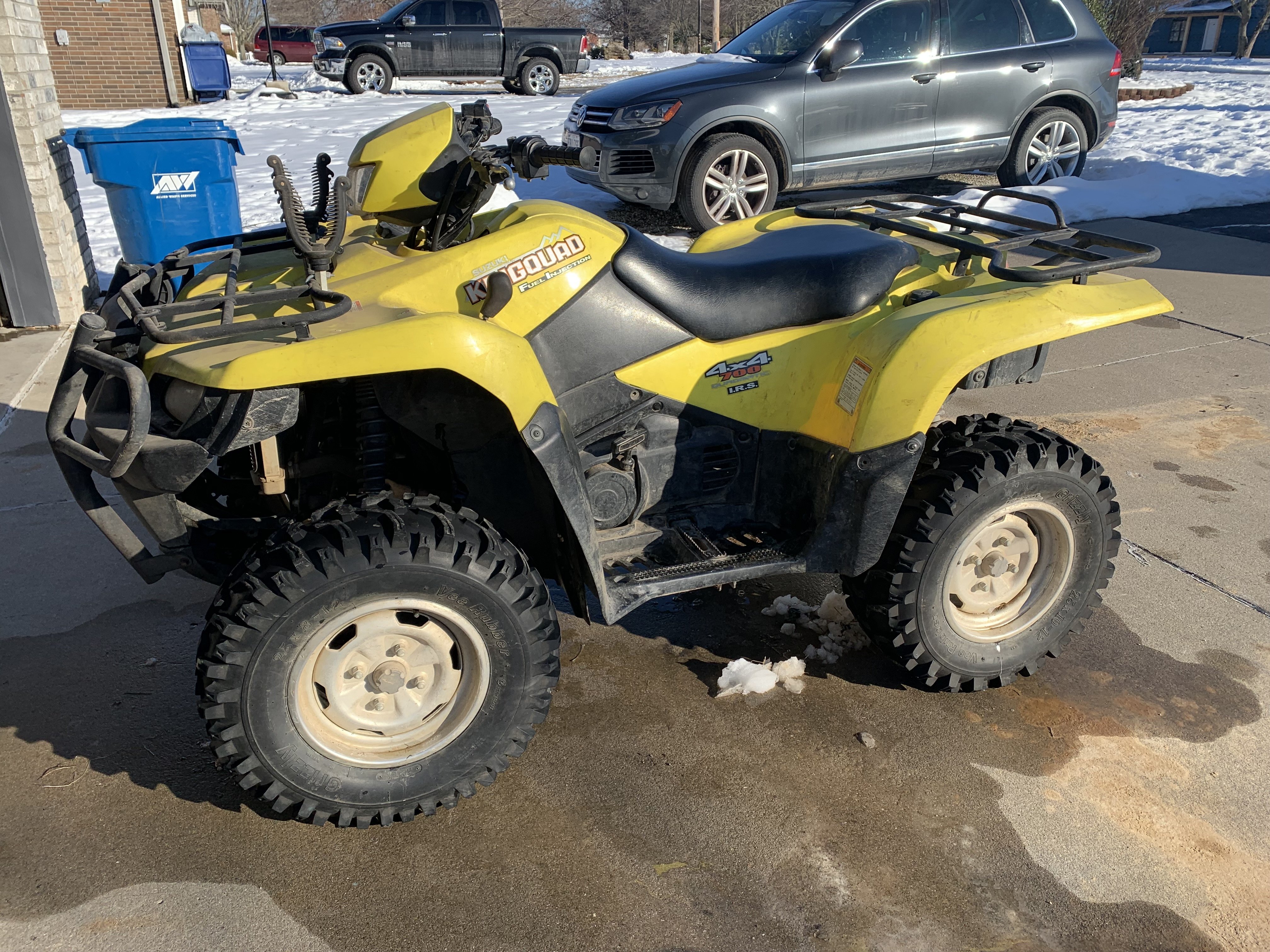

new to atv's.  just got this 05 KQ 700.  seems in good shape, has 3500 miles and about 350 hours.  but its dusty/dirty as heck, looks like it sat in loafing shed for years.  found mouse nest when i changed the oil.  anyway,  like i said, just got it, seems to run fine but I want to do some general maintenance as I'm not sure what that was like with previous owner.  so far, I've only changed the air filter, put in a new K&N, it was the ONLY option I found at local O'Reilly's.  Changed oil and filter and also put in a new battery.

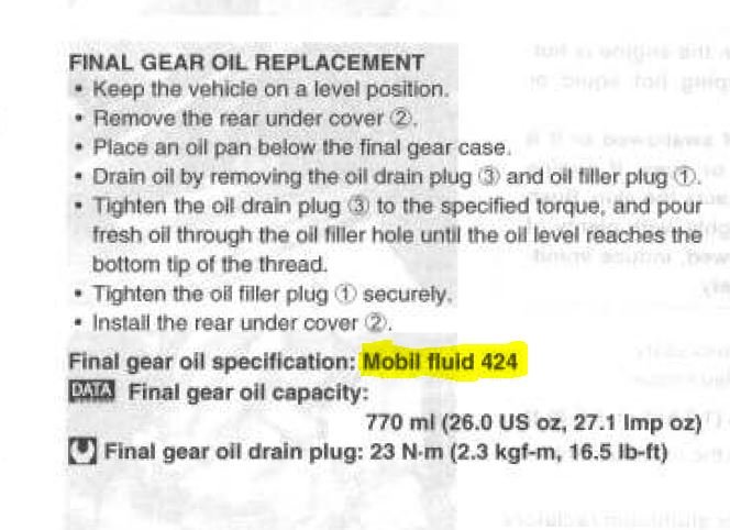

I also looked into the rear diff.  and it calls for Mobil Fluid 424.  I'm not familiar with this fluid.  a quick search looks like its just basic tractor fluid. Most are conventional and come in 5gal buckets.  I need 30 ounces.  I was wanting to use synthetic fluids in this machine.  Any thoughts on a Mobil Fluid 424 synthetic alternative?   I found an Amsoil Syn Tractor Hydraulic/Transmission oil sold in quarts.  Also saw Lucas UNIVERSAL HYDRAULIC & TRANSMISSION FLUID but its not synthetic.

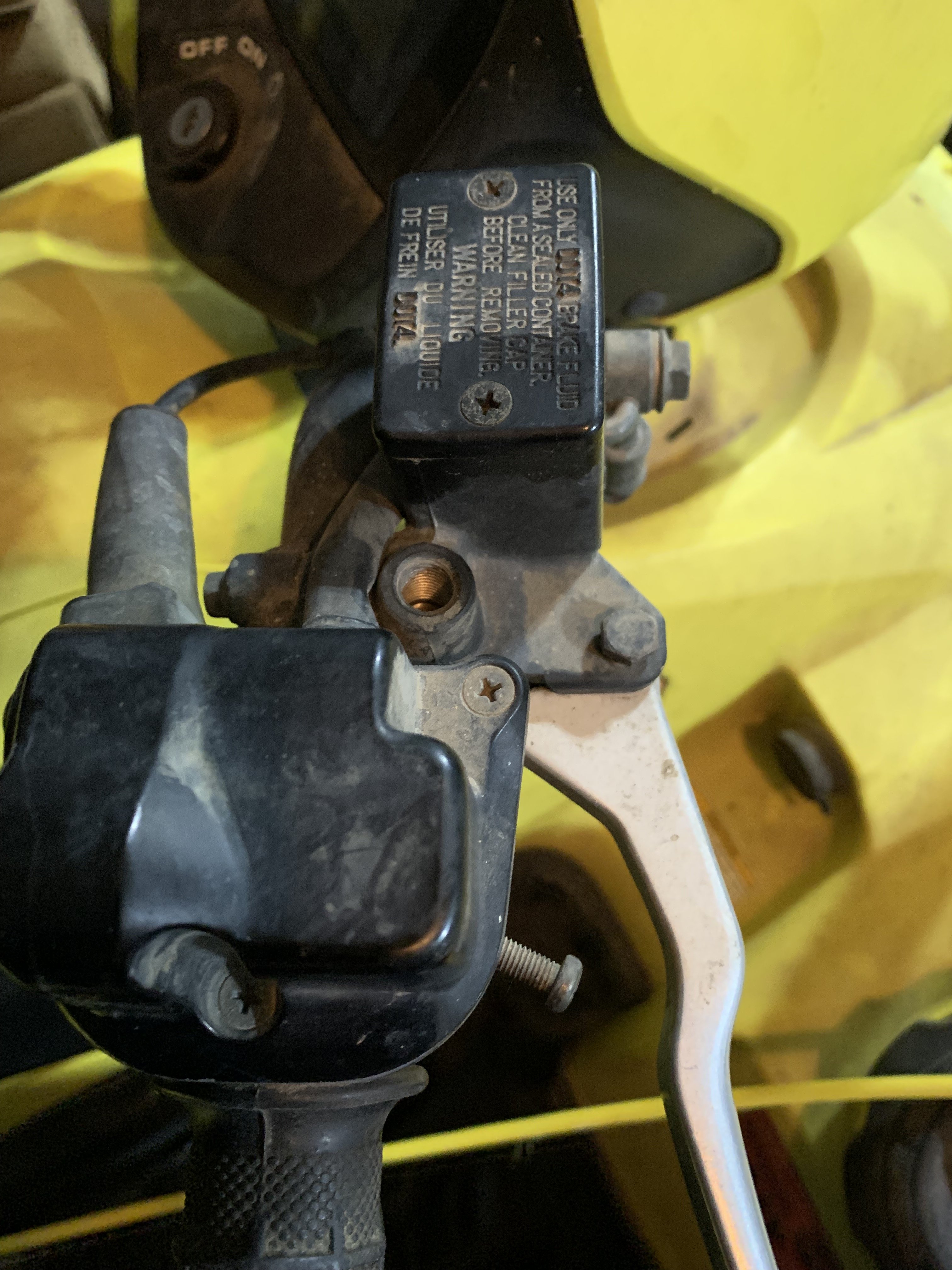

Also, Any idea what this open screw hole is for?  its on driver side handle bar.  mirror maybe?  im skeptical on that but not sure what else.
Yup that's a mirror mount.
I don't know the oil or an alternative but look into it well. There are a lot of specialist tractor oils now, for wet brakes for instance, and they have anti-squawk and anti-grab, and anti-slip, and combinations of those. The rear diff might very likely be a limited slip diff and need a light but limited-slip oil or something.
If you look up Mobil they should have the specs and a description.
OK, so I called Lucas Oil and verified with them that the Universal Hydraulic & Transmission Fluid is their equivalent to the mobil424.  I used that and changed the final gear oil.

That oil.. The mobil 424 I looked up is no common oil, it's anti-everything..
https://tinyurl.com/yk6n63w4
The Lucas oil doesn't claim some of the features the mobil has. I'd use the mobil. The new agricultural oils are bloody tricky. I've seen problems from using very similar oils, designed for the similar applications, but not good for the particular make and model of tractor.

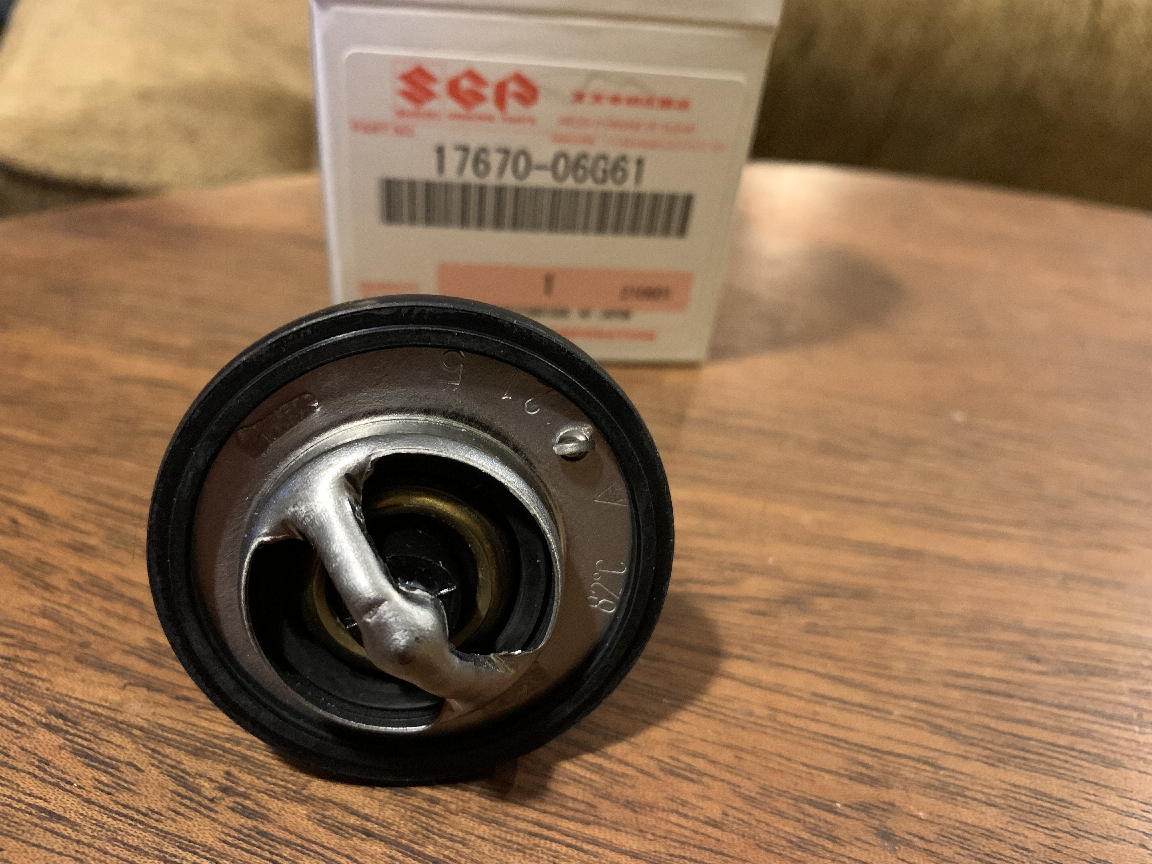

You know if there’s a gasket for the t-stat housing? Don’t see one in the service manual. Seems odd. If no gasket, ad it looks like metal on metal, what about RTV for a gasket?
The thermostat likely has a rubber gasket fitted onto it. A new one should come with the thermostat.  I'd never use silicon anywhere on a bike, the excess squeezes out inside the engine and can block or jamb things up.

And..  Do you know that when you get the new thermostat it will have a small hole with or without a jiggle valve in it, and that the hole has to be fitted to the top... That's important.
Thanks for the heads up on the orientation of the thermostat.
It does have a rubber gasket fitted around it.  I also see the hole on one side of the thermostat.  i'll make sure it goes in correctly.

Yeah that's the gasket on there. That should be all it has, it should poke up a little above the surface when you fit it.

Just put the thermostat in today but haven't had a chance to ride it.  I've also got new front cv axles coming in, suppose to be here tomorrow and will put those in soon as I can.

my uncle was here this weekend and he suggested I test the thermostat before install.  Not a bad idea, but id never done it before.  I didn't.  But I did put the old one in some near boiling water and didn't notice anything happen, like it opening up.    Anyone ever test a thermostat?
To test a thermostat  you put it in a pot of water  and  heat it up. Use a cooking  thermometer to  measure the water temperature  that the thermostat opens up at. It should open at the temperature it is marked for ..  In a pressure  system, that would most likely  be near or at  sea level boiling point of 212 Degrees F or 100 C
