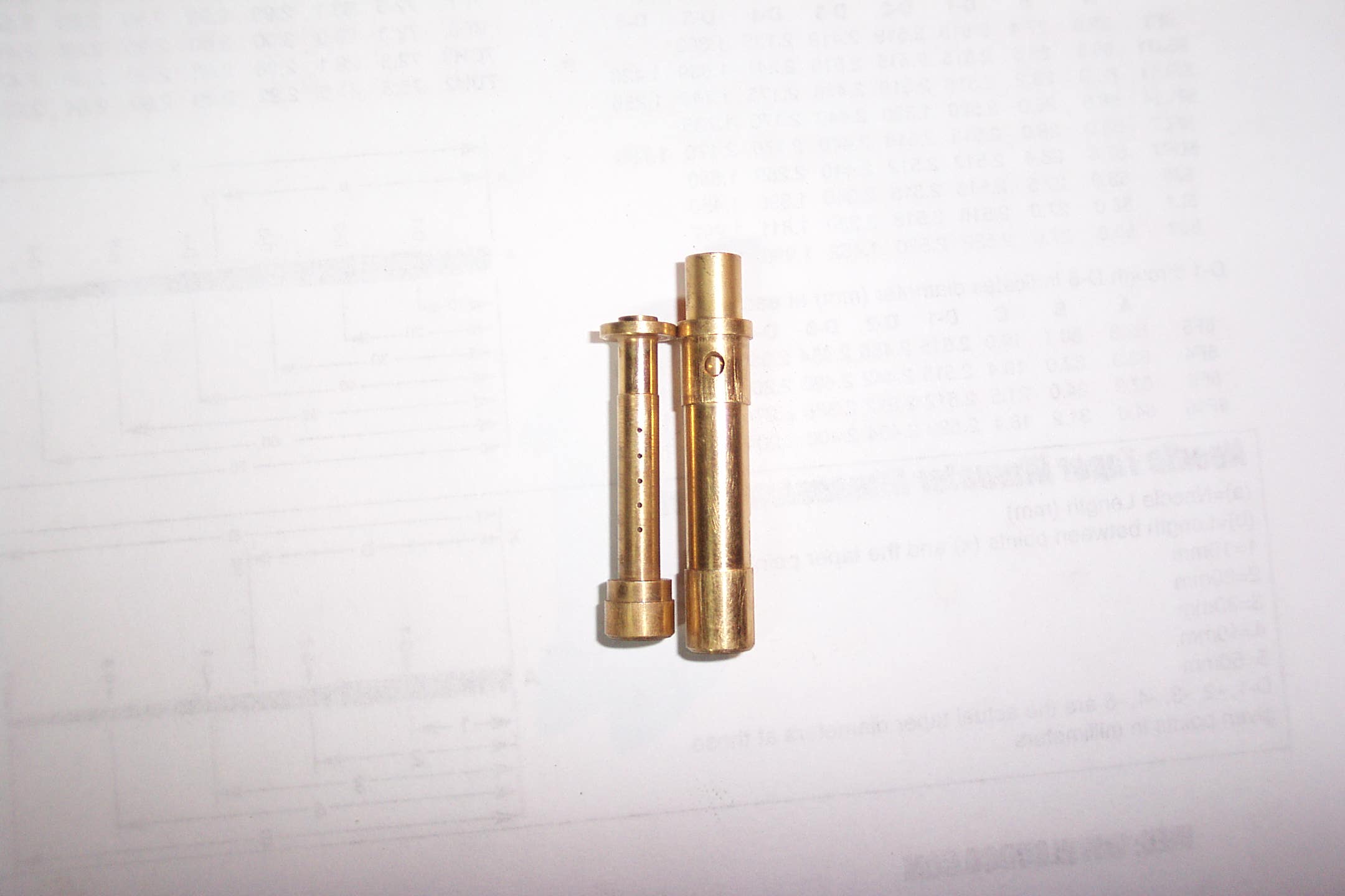

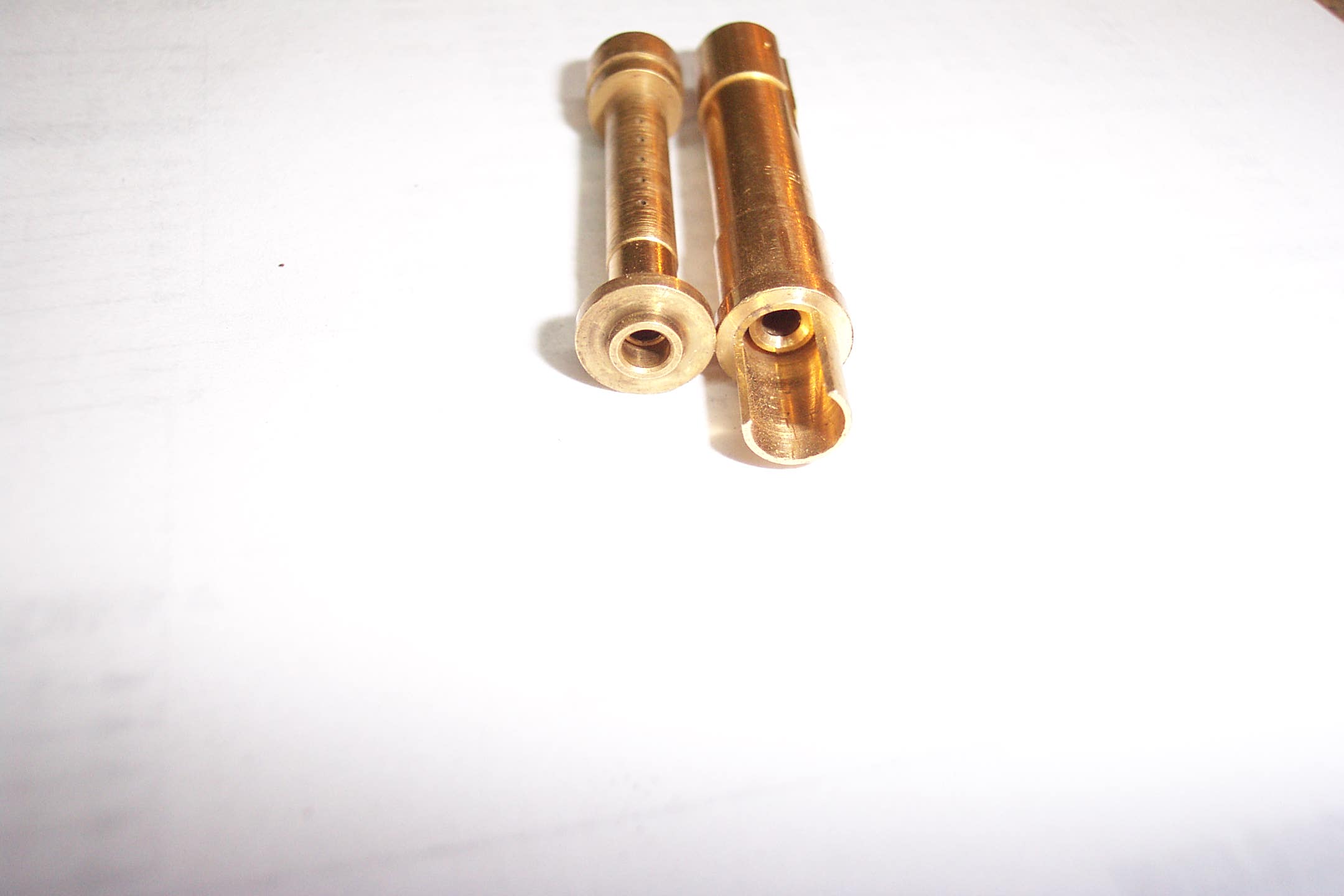

That jogged my memory.  The tube is how I know it's a 2-stroke carb.  I remember swapping that too with no luck.

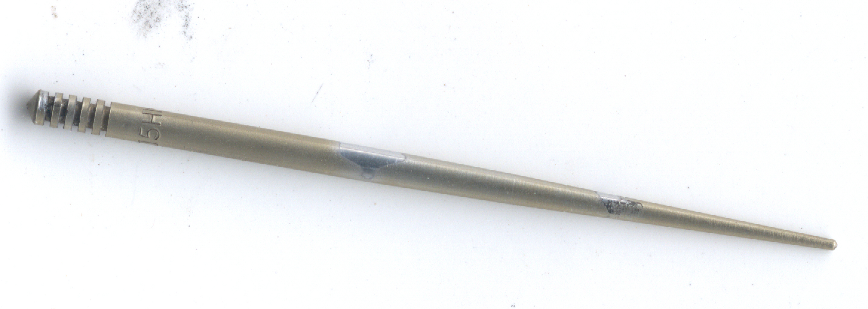

I thought I posted these pics earlier:
needle.thumb.jpg.40071a89033828825d9171a851ee3602.jpganeedles.jpg.9848b5751b4a01c5c3989830d3522bef.jpg
The 230s and 250s carbs are the same but look how different the 250s needle is.

And you see those small holes stacked up on one tube.. that indicates it needs/gets a lot of enrichment as it comes onto the needle, which means it's running lean somewhere else.. slide probably.

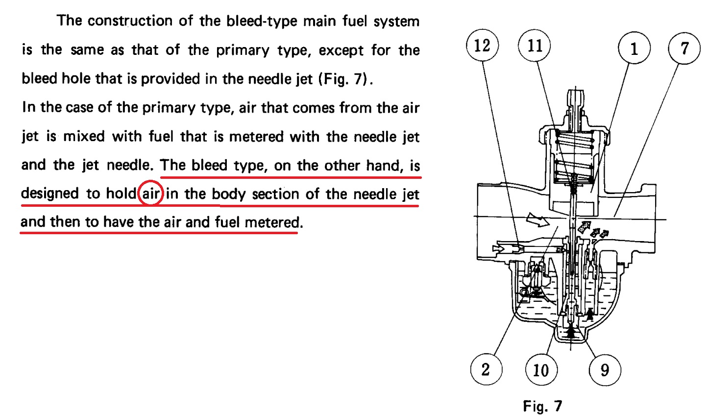

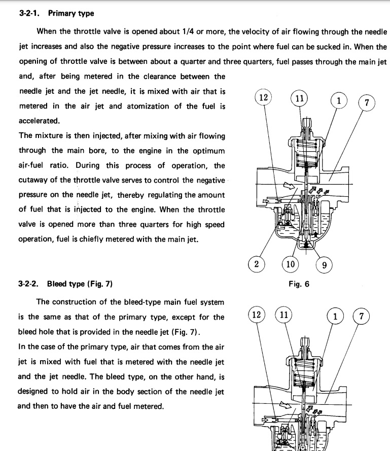

I believe those little holes draw in the air from an air jet.  #12 in the pic.
Is Mikuni also welcome to their opinions?  They also believe the little holes are to mix in air, not extra fuel.
The primary needle jet is a straight tube drawing up the fuel while the air comes up through a separate opening around the tube.  The air and fuel are not mixed together in the tube.  I guess it's good enough for 2-strokes.
But with the bleed type the air bubbles into the fuel as it's drawn up the tube.
You're right that it's important for those little holes to be unplugged, but to prevent the carb being too rich, not too lean.
I guess we both learned something lol.  I'll pay more attention to cleaning those holes in the future.
That tube is in a drilling that fills with fuel when the throttle is closed, it fills via the main jet and those small holes. It fills to the level of the fuel in the float bowl. When the throttle is opened, that fuel level in the drilling drops as fuel is drawn back through the small holes. To start with there is some air being drawn through the top small holes and fuel through the lower small holes. The fuel level in the drilling drops until no more fuel is being drawn from the drilling, but only through the main jet, and it's mixed with air from more and more of those small holes as they get uncovered.

When the engine is not running the well will be filled with fuel as you say, but so long as the air jet (#12 in pic) is passing air then the well will be filled with air.  I suppose the question is at what point the air jet begins to pass air and I'm not sure how we could determine that with any certainty.
The way they worded that suggests that if there is any fuel in the well, it is so quickly evacuated and replaced with air that it's irrelevant.  If it were designed to hold fuel, I think they would have specified that.

Not sure what that's supposed to mean.  You tell me to download a manual, then you suggest the manual is wrong... and because you disagree with the manual you threaten to give me the cold shoulder?
