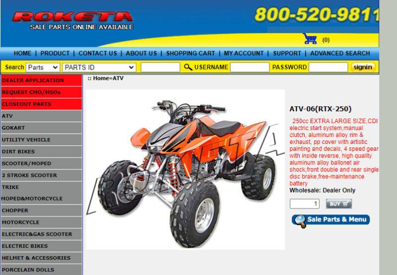

Yeah I looked it up Ajm. Not something we get here.

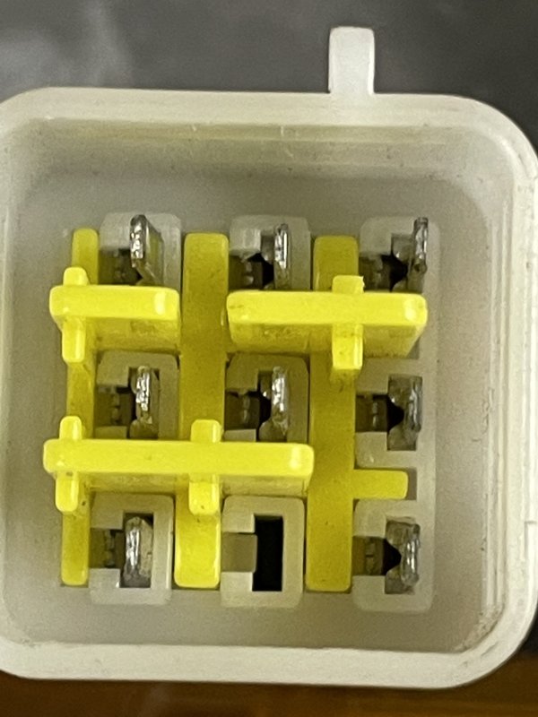

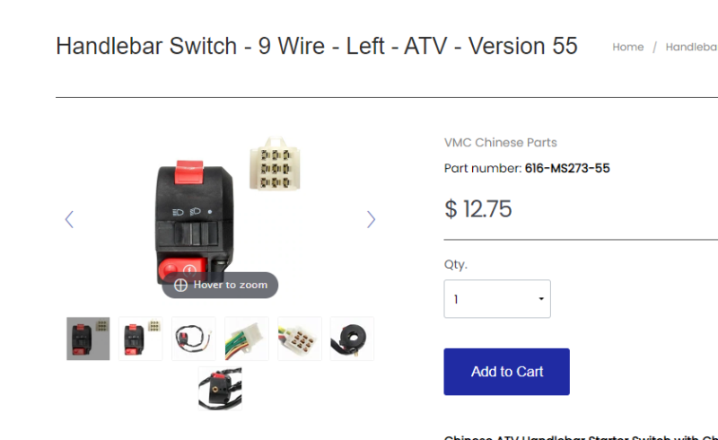

I don't think you are going to get a manufacturers wiring diagram Jerry, and there are no generic wiring diagrams for something like that switch, or bike. You could take the switch apart and you should be able to see where the wires go, check which wire/pin goes to which switch and when they are connected or isolated from one other, then pull your old switch apart(if you have one), and do the same with it. If you don't have the old switch you will have to try and figure which wire on the bike goes to the power for the headlights and to the headlights, which wire goes to the starter, and which wires kill the ignition and whether the kill function is by shorting two pins/wires or by disconnection them.
