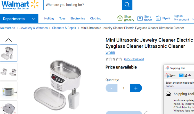

i am not a mechanic but i help my dad work on motorcycles/quads/snowmobiles and it is always the carburetor is gunked up/ it is always those things called 'jets' these tiny brass looking bullet shaped things
i'm going to buy one of these $20 or $30 ultrasonic jewelry cleaners and test it out with just using vinegar as the cleaning solution on some carburetor jets and see if i have the same results as this youtube video guy
i never used an ultrasonic cleaner before
