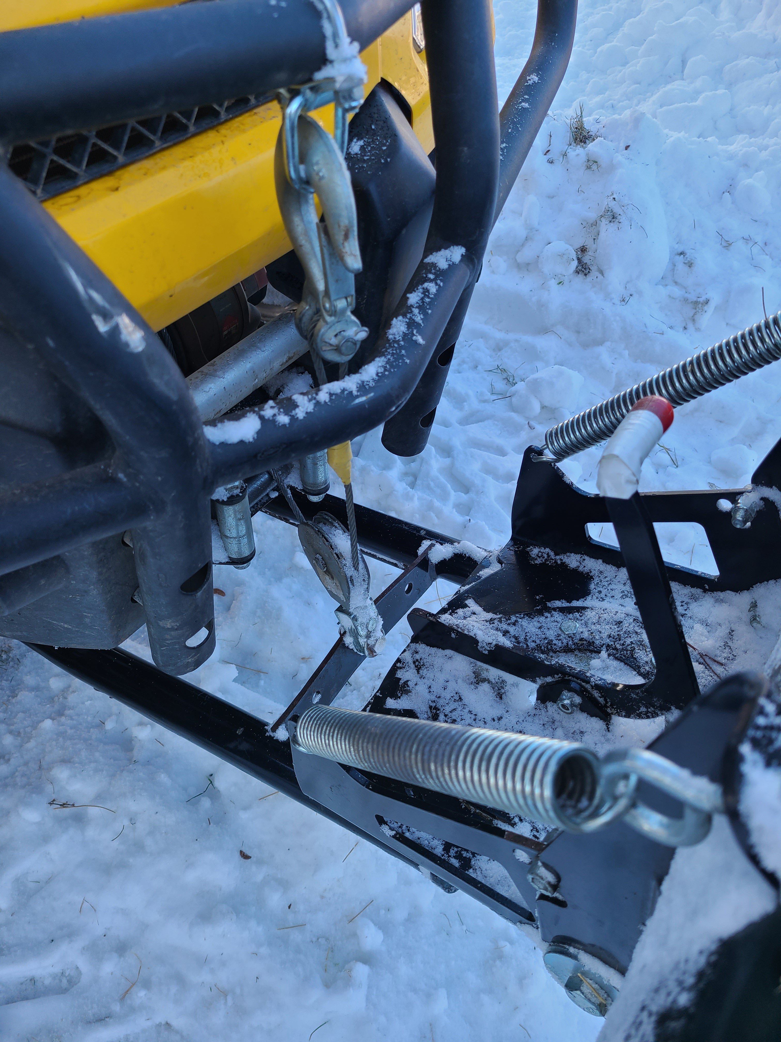

My only issue is that the winch isn't sensitive enough to adjust the blade an inch or two at a time.  I will need to modify how I'm grabbing it so that I can position the blade more accurately.

I installed a light duty sheave on a swivel (snatch block configuration) instead of hooking right on to the blade mount and in slows the in/out down so you have better button resolution on the blade up/down.
