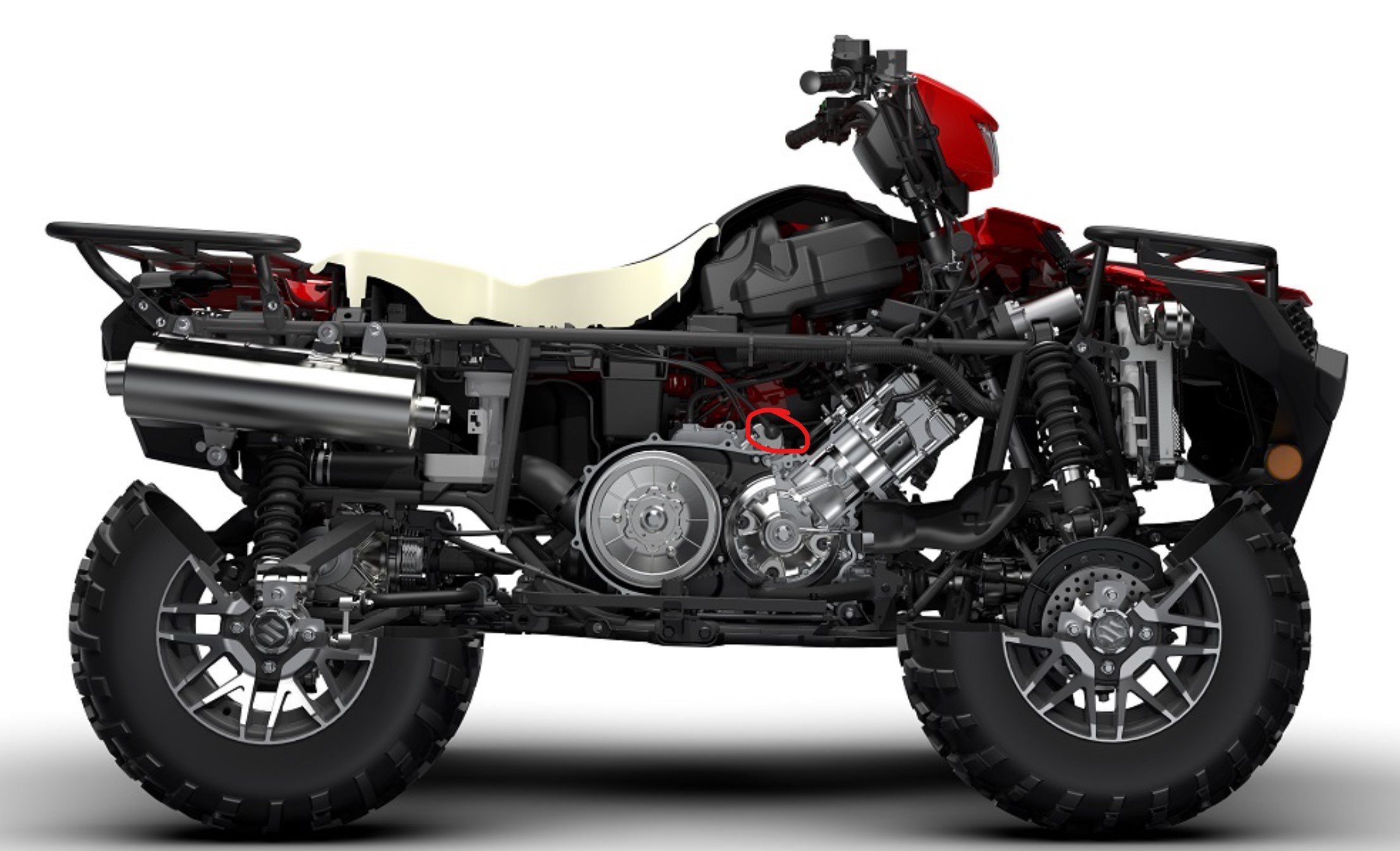

Sensor is located on the right side of engine, between exhaust and engine, outside.
Attached picture below, red circle shows the location.
