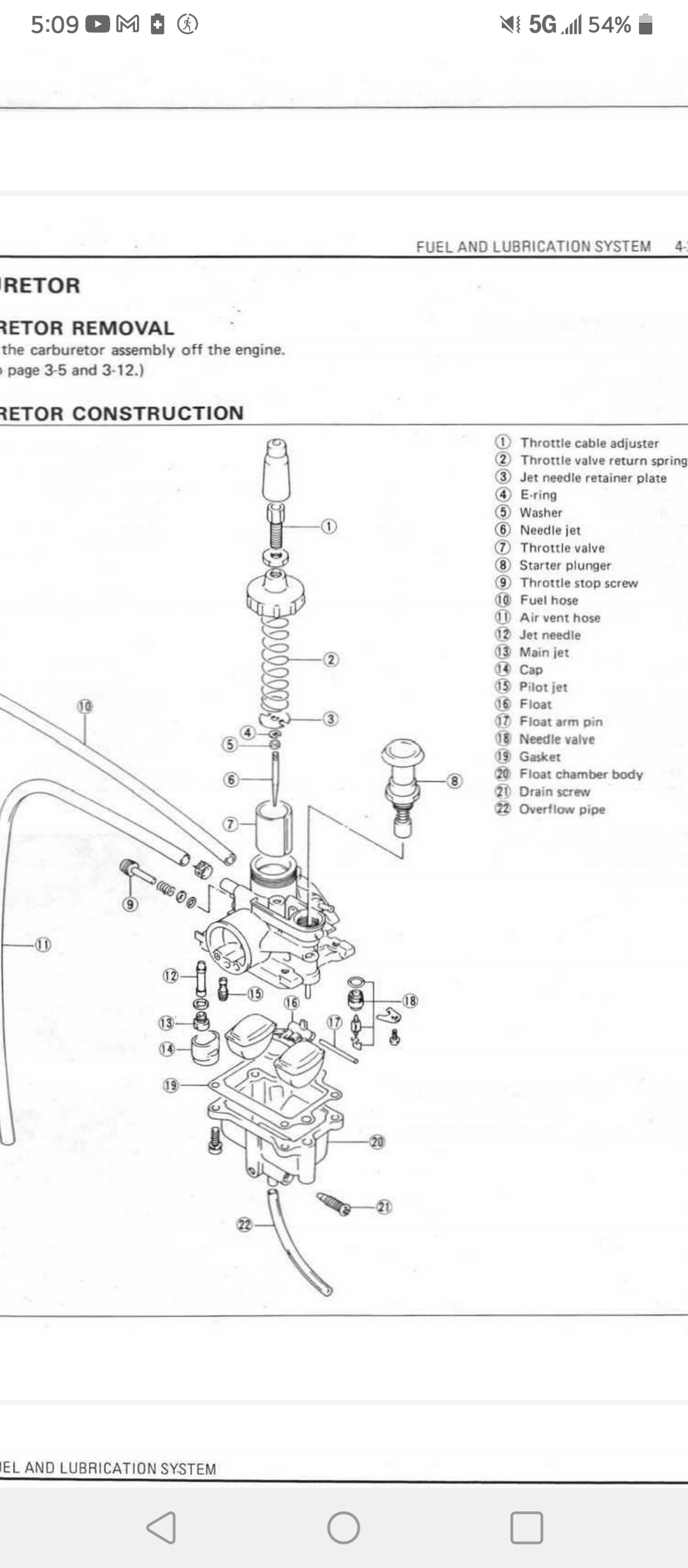

I’d like to know how the carburetor is connected. There’s a few hose lines that come off it. I don’t know much about carburetors so yea. I just don’t know if there’s more parts that I’m missing.
There are two pilot holes on the top passenger side of the carb.  The front hole goes to a breather port that dead ends under the gas tank.  It just needs a small filter or piece of cloth taped on the end of the hose.  The other small 1/4" hole on the carb is toward the rear of the bike and it goes to the fuel petcock valve to the diaphragm port.  The larger lower opening hole is fuel into the carb and also goes to the fuel petcock to the outer connection where it says on/off/priScreenshot_20211109-170936.thumb.png.b8a81fee92890c51ce6cf4b7ca2952c7.png
