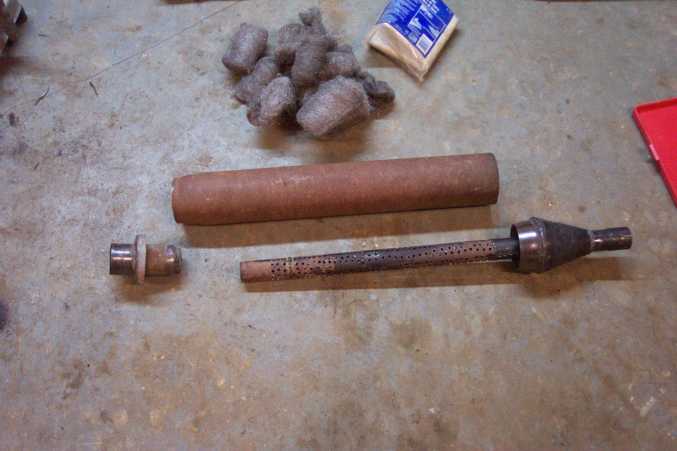

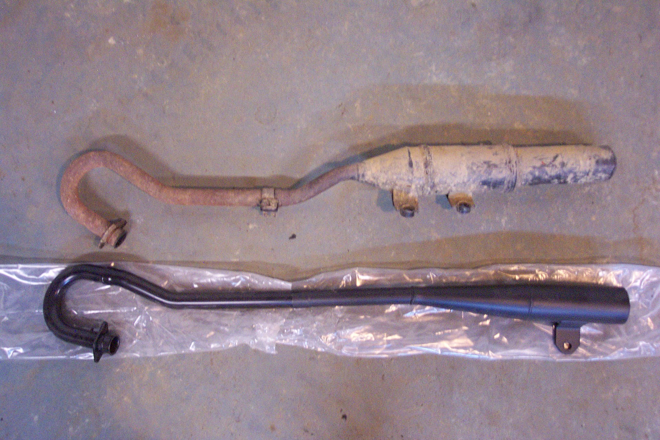

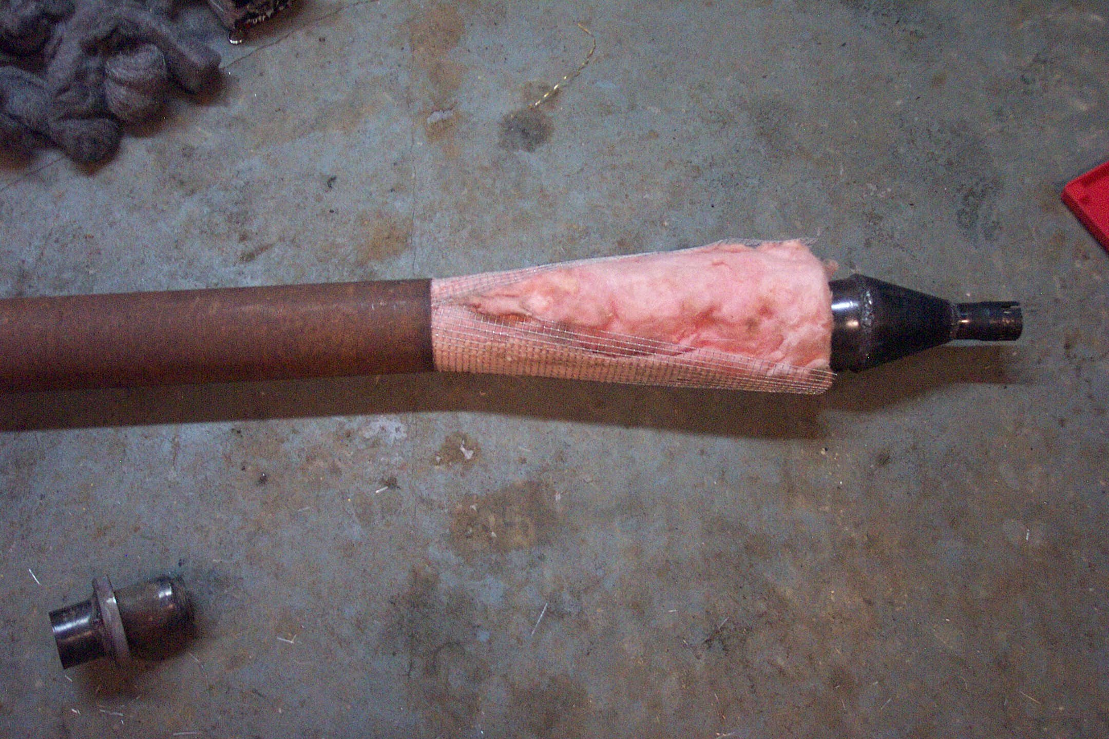

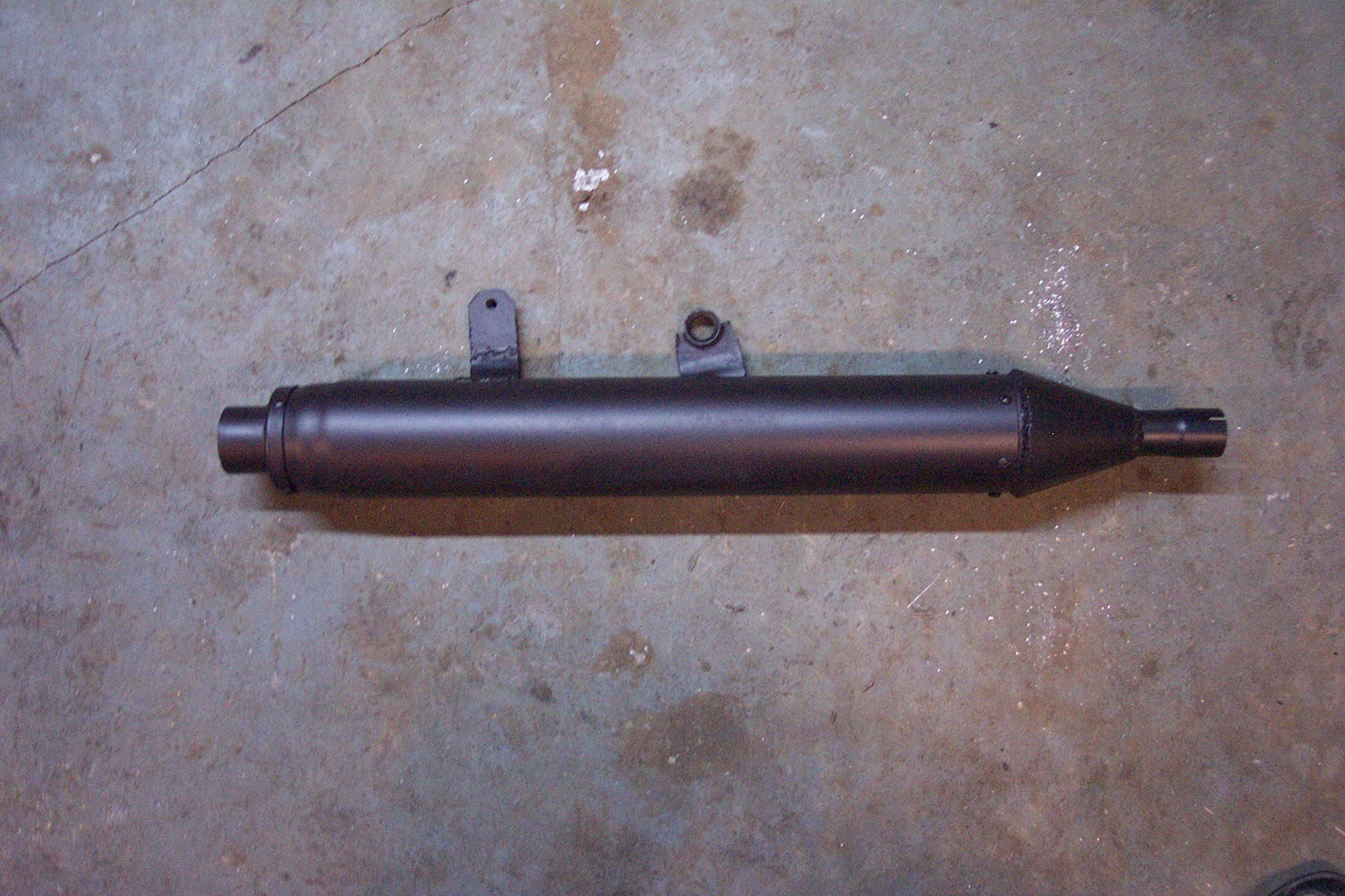

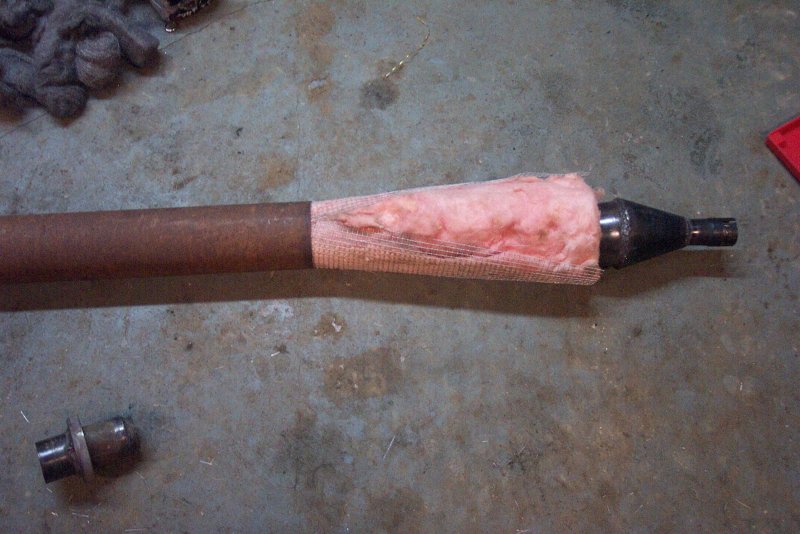

I think this is a Jardine exhaust like that guy with the 250S on craigslist.  The muffler sucks so I made my own, but the header is nice.
The muffler I made
That's a section of driveshaft.
The muffler is super quiet until the throttle is opened up.

Mufflers like speaker boxes have to be strong enough to contain the sound which is why I picked something thick like a driveshaft.  The pressure won't be able to leak through all that metal.

I really like the driveshaft muffler! One thing I wish I had is a metal lathe. No clue how to use one properly, but I'd love to be able to change the dimensions of metal parts like I can with wood. I make do with grinding and cutting and reaming for now.  I had to fight with that old DG to get the core out of it, there was a small ding less than the size of a pencil eraser on the underside where a rock had pinged it, and the core would NOT budge past it.
I jury rigged a puller with a long piece of drill rod as an extension for the slide hammer and brute forced it out. Managed to smooth out the bump internally enough to slide the core back in after repacking it. I use the high grade yellow stuff from Owens Corning Racing myself ;)  That with the blue painters tape really stays more comfortably within the Suzuki color palette. I made a 'quiet core' from some random stanchion mount for one  of those car canopy things. Drilled holes in it and the end cap of the DG core, and used 3/16 rivets to secure it in place. The groove where the snap ring goes in was chipped away and all bent in, not allowing the core to come out, so it had to go as well. Ground it off flush and promptly broke the head off a self tapping screw in the side of it and called it a day. That's a problem for the next idiot that decides to repack it. =P
BTW... Know any way to swage the neck of the muffler down for a better interference fit? I managed to loosen mine up a little too much with all that action, and now it's no longer a 'slip-on' and needs a clamp or a sleeve.

Metal dings is another reason I like having substantial metal for a muffler.  If I remember right, the fitting is tapered so it has to be pounded together then fastened with screws.  The first wrap is steel wool, then thick fiberglass for patching boats, then the pink stuff.  I was really impressed how well it worked.
I tried to replicate it with the king but I made the muffler short and fat instead of long and skinny and that didn't work, so the king is louder.
The only way I know to reduce the diameter of pipe is to cut and weld.  I'd get a fluxcore wire welder if I were you.  They don't cost much and come in handy a lot.
I have a wire feed welder set up to MIG, with a bottle of argon. The pipe I need to reduce is aluminum, however. I'm just going to get a tube-style exhaust clamp like VW uses if I can find on in the right I.D.
