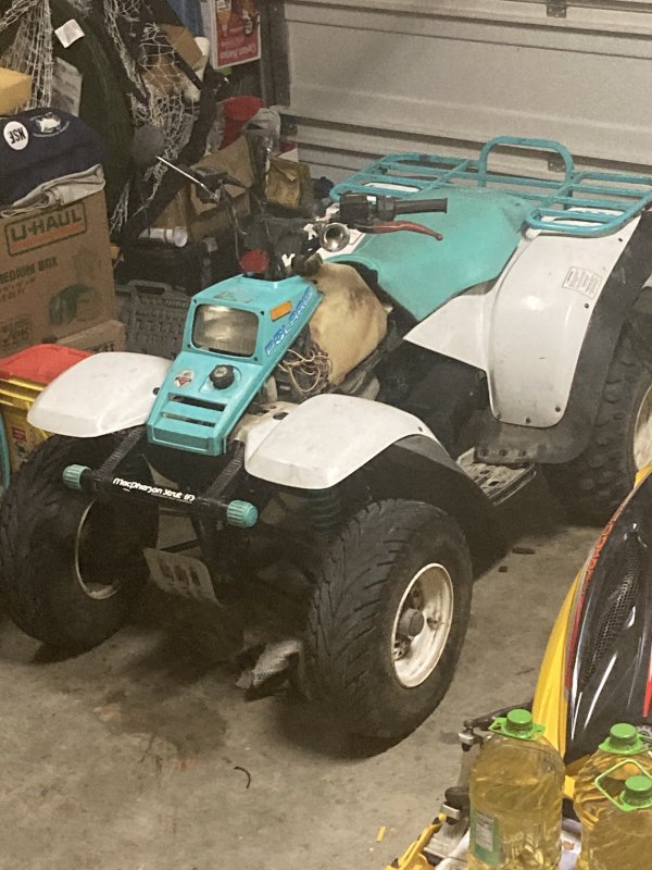

Hi, i have a polaris 4x6 -89 and im not sure if there might be something wrong with the engine.
It makes a kind of scrabling sound like when a rod bearing is bad, but i can only hear it when revving quite high, usually bearing fault is heard mostly on low revs.
Could it be bearings? piston? Or just something loose that is vibrating?
Could be trash on the magneto side of the case, one way bearing on the clutch making noise, might even be something as simple as a heat shield vibrating at a certain frequency generated by RPM.  Can you post a video so we can hear it and maybe help diagnose?

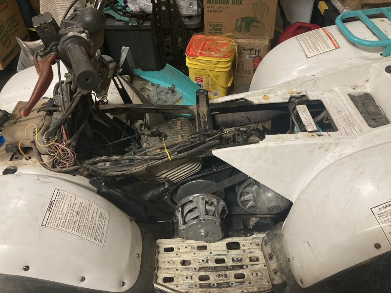

So the “pig valve” it’s been called many things- is on the left side of the gas tank and it can shut fuel off or turn it on- after I cleaned the carb up, redid my lines, and cleaned out my tank, today it’s working like a champ and idling well! I’ll send a pic, I didn’t put it all the way together bc I am going to rebuild the top half just because everything else was so rough I know the rubber seals are toast. But yay and cheers!!!
I know right!!!! I am so proud, yesterday I thought it was going to cost me a bunch and I wouldn’t be able to get it back together. This site helped me find a manual and also got me reading what other people see. I noticed the brand is irrelevant compared to the years the machines were made in.
