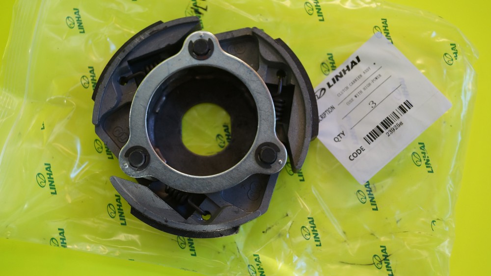

Hello i have a linhai 300 of the 2004+- era. I had a cluch problem so we changed it. After changing it has a hard time to start going. When you pop it into gear and press the gas it barely drives but when it starts going about 20km/h it start driving well the acceleration is normal and everything do you have any idea of what could be the problem

This was the part i changed but i didnt change Cvt clutch bell now im wondering if that is the reason. i didnt change the belt because it looked pretty good. Just cleaned the metal shavings and changed this part, and no before it worked well then it broke couldnt get it into gear but once got in it drove but also barely so i changed it pretty quick.
Ok, well I'm not sure what's wrong but it sounds like the bike's trying to start off with the driven pulleys too far apart or the drive pulleys too close together. Either thing will make it seem like it's in too higher gear. Since you've had the driven pulleys and centrifugal clutch hub apart I'd guess you might have assembled that wrong. I think you will have to take it apart again and check how it's assembled and that everything's nicely lubed and free to move.
