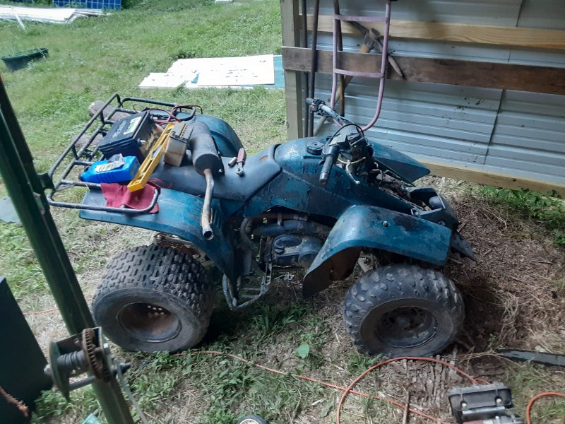

Okay have an old lakota, died while riding several years back ( early 1500s or so!). Just trying to revive the dead again, recoil starter seems dead.  Hooked a car battery up half arsed and it did turn over although sloooowwwwwwllllllllyyyyyyyy! When it died thought there was no spark. So any ideas on best steps to try and start finding the problems? Put some penetrating oil in cylinder to help loosen it up.

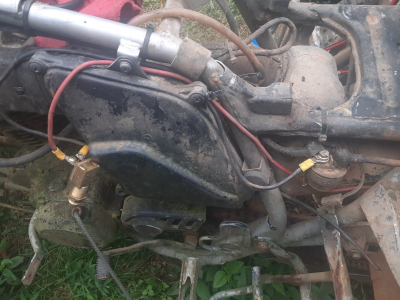

Pulled the plastic off and who ever worked on this bike b4 me needs his man card pulled, and a warning label tattooed on his face not to touch tools! Literally baling wire and 10 to 20 lock washers and regular washers on each too small bolt but waaaaaayyyyyy too long!
Now onward and upward I hope! Fuse blown, handlebar switch bypassed (not by me) and I hate wiring along with work and wrenching but that's another subject!

Okay, well threw in a temp patch on the wiring, now have neutral light and power to the front and rear lights if they had bulbs in them. Still no spark, but the handlebar switch looks really bad so will check the kill switch next and change spark plug as well. Tested pickup coil on multimeter and showed okay so hope that's good. Have not tried yet to see if I am getting a pulse from it though. If anyone has ideas feel free since I have no clue what I am doing! Lol

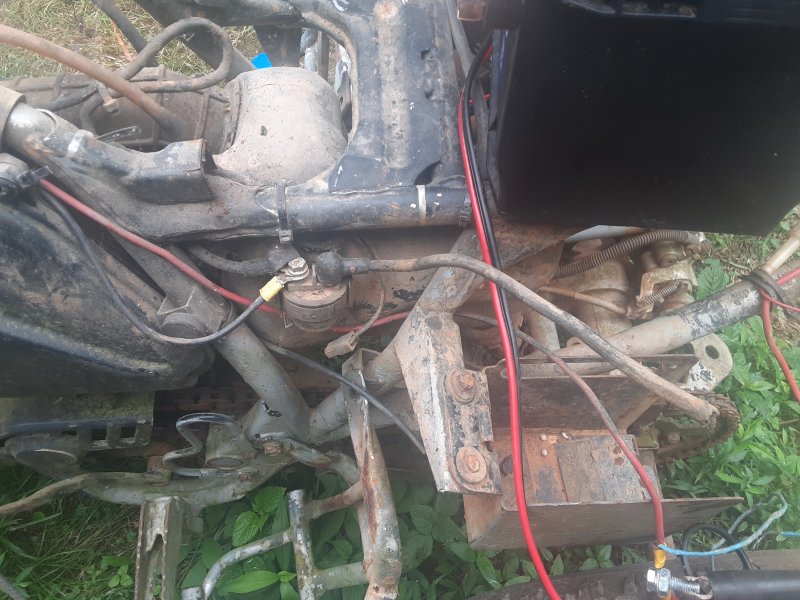

Think its time to make a direct voltage adapter so I can check coil etc properly. Took an led, stuck in output from pickup coil and when turning engine over, the led pulsed in time. So kill switch and coil working. Hooked to output from cdi and led lit up and stayed lit. That doesn't sound right. But started raining so not sure if I had plugged the coil back in. Can't wait for a slab of concrete and a roof!
WE GOT SPARK! Woohoo! Replaced cdi box with gm hei and sparks magically flew through the spark plug! Lol Now to get a battery and see what happens. Nest step order a start solenoid to replace this wired up hack of a starter button. And find a battery for it and a solar panel to keep it charged. Took forever the gm hei ignition module to get here, somehow the usps sent it to Florida instead of Tennessee!
