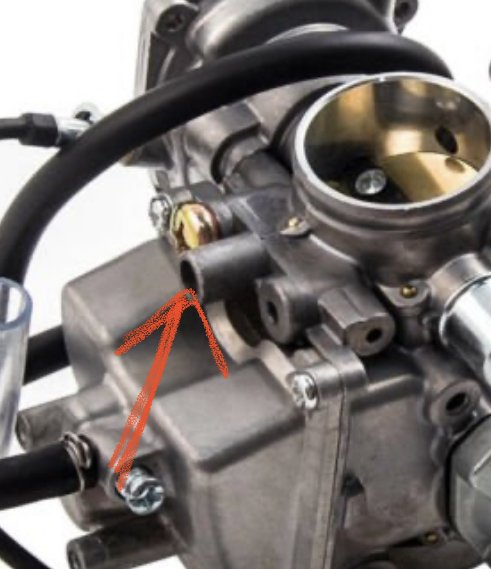

About a year ago I replaced the carb on an Bruin that I bought from a relative, I replaced it because it was gummed up from bad gas sitting in it for a couple years. Replaced the carb, and ran it a little bit and it had a problem of the carb popping whenever giving it throttle. I assumed this was just a fuel air mixture I needed to adjust, but I was lazy and just let it sit for a few more months. I went to adjust it just now, but I don't know if I'm slightly retarded, but I can't find the fuel/air mixture adjustment screw anywhere on the damn thing. I've tried nearly every screw I could find on it without taking the whole thing off (Which is a pain on this atv). I'll link some pictures I have from ebay on this carb. I also checked manuals and diagrams of the carb and could not find anything anywhere. Please spare me from my complete ignorance.

I highlighted/arrowed where the air fuel screw is.  It may have a brass plug over it.  If so you have to drill the brass plug out.  Its pretty common to do this.  Some states require this cap for emissions reasons etc.
