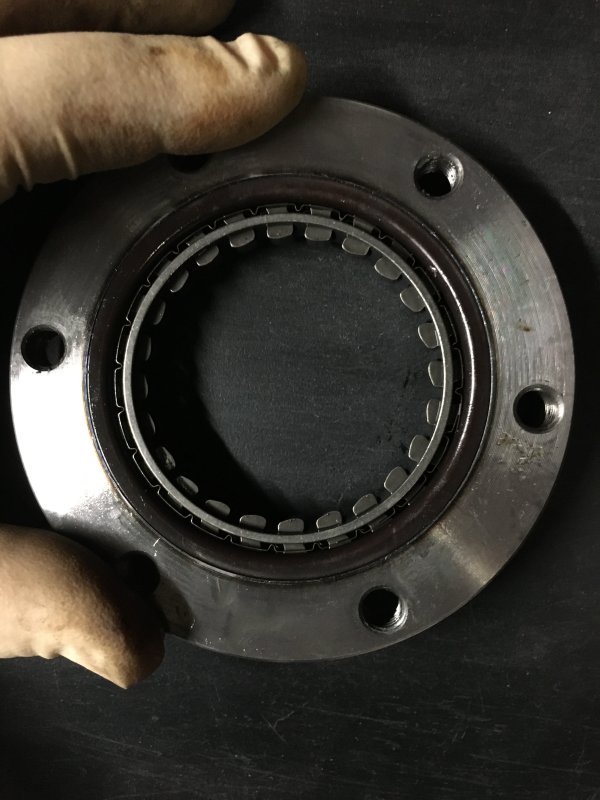

Spins freely both ways like not engaged. Its been parked and did crank the other day but never started. Cranked a few times and then started to do this free spinning.  Its odd to me too, almost thought it had something to do with the way it was parked. I pushed it in gear to move the flywheel a bit and see, but same scenario.

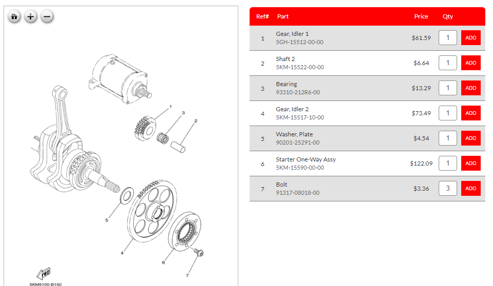

2004 Yamaha Grizzly 660 Starter Clutch Assembly

Nothing broke per say. That's the one way clutch.
They go sometimes plain and simple. That part #6 should be what you need but its behind the flywheel and bolted to the flywheel. Going to need the side cover gasket and most importantly is loctite for 6 allen bolts holding  it to the flywheel.  @Ajmboy The flywheel needs a special puller to get it off. If you don't have one i can mail you mine.  Its not big and you can mail it back.

Yep thats it and the part is behind and attached  to the flywheel with some allen bolts. FYI the flywheel os deeper then the allen key so you have to use the longer stem on the allen key. Problem is its a bi*** to try and turn so you should have a set of good "T" handle allen keys.

I bet it's #6 on your diagram, a one-way clutch. They wear out/fall apart

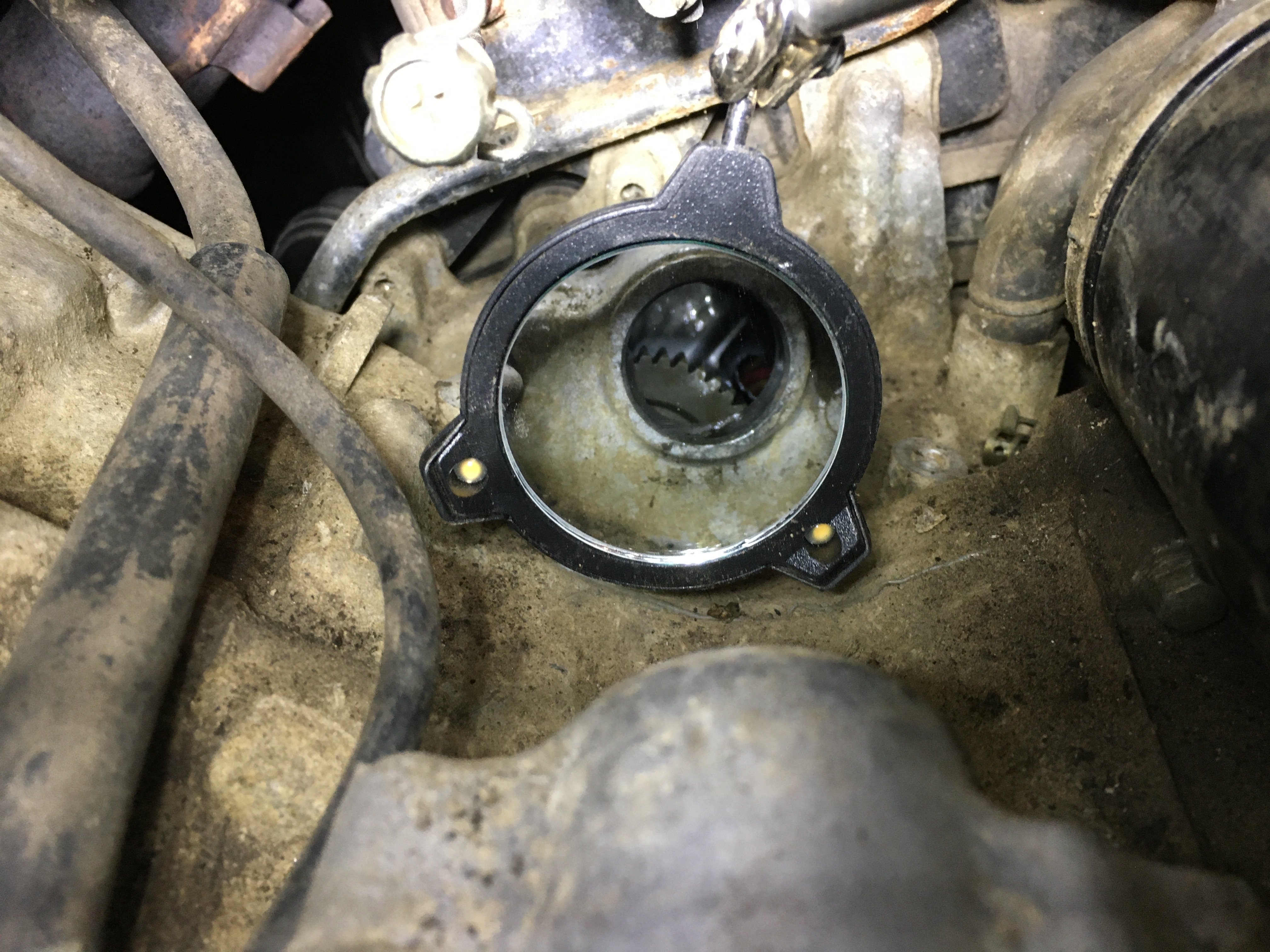

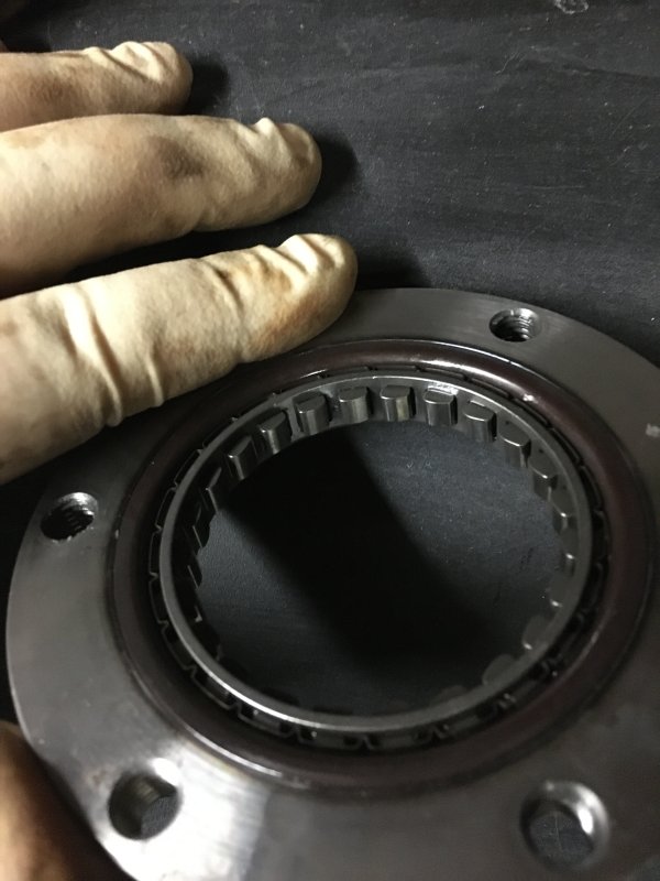

So you pulled the cover off and checked things out and its working again?

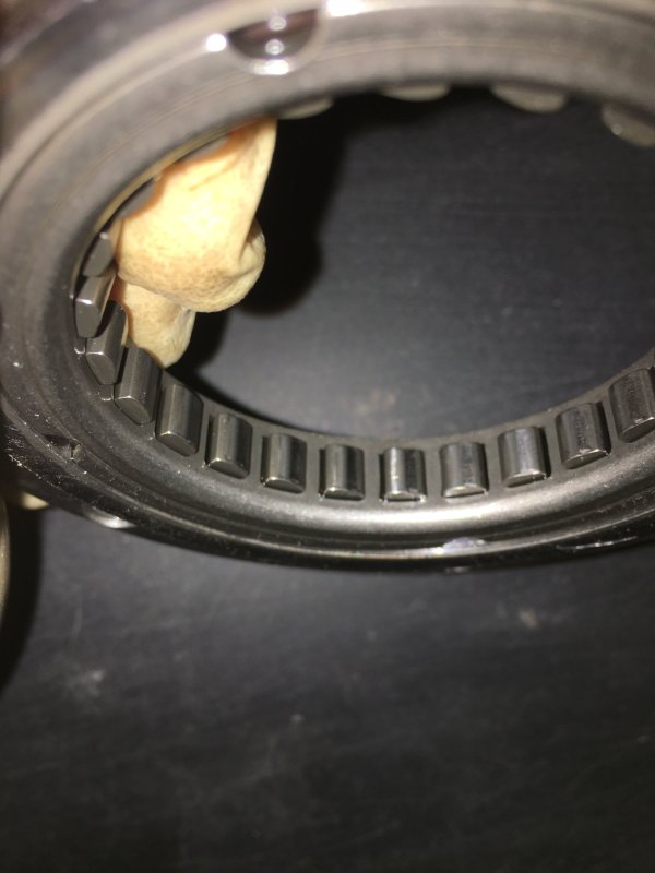

yep, looks like that to me. Hit the starter and the flywheel is turning like it wants to start.  That chain looks loose to me but no sure if its supposed to be like that.. The videos in the post are mp4. here are .mov files from my iphone.. I'm tempted to just get a gasket and put it back to gether but don't know.
IMG_1671.MOV
IMG_1672.MOV
Theres no doubt shes grabbing again. It's common for them to stick and get stuck and work again.   The problem is it keeps happening.  I would go with your gut and slap a nee gasket on and see how it goes.  Worst case she acts up again you know what to do!

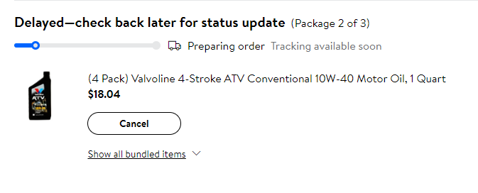

I think I'll do that and see. Oil looked pretty dark, so just ordered it online with a filter and will get a gasket and some loctite for the bolts and see what happens.
Loctite you will only need if you swap out the starter clutch.  I tend to stay away from Loctite on the engine cover bolts and put a tiny dab of silicone on the threads instead, especially the longer bolts at the top of cover. That loctite sh** works good and the longer bolts have to much length on them so they twist and snap coming back out so choose wisely.
Spray the stater clutch with carburetor cleaner if you can get to it. Maybe its gummed from dirty oil.  Prob not but cant hurt.
My guess is you will be changing down the road, and of course it will go on a snowy day!!!! Lololol.
