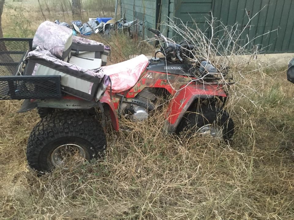

Well im at it again, took about an hour drive Saturday and made a deal on this old honda.
Might be restorable. Tires pretty dry rotted, mastercylinder broken glass and probably full of water.
Handed me the carb he rebuilt (oh no) He said ran about 6 months ago but when we pushed out of his
field there was a tree growning through it. See pic.  Missing some parts, also missing the intake. Motor is not
locked up, Has piece of plastic crammed in the head since no carb there for months. Brake cables bad, etc. Thats
part of the fun. Im sure I will be posting some questions later for you all. Stay tuned Az.
I think I paid too much but needed another challenge. 350.00 The only positive it does have a winch
(don't know if it works) These things keep me busy and actually have been making pretty good profit
also. Stay tuned Az
