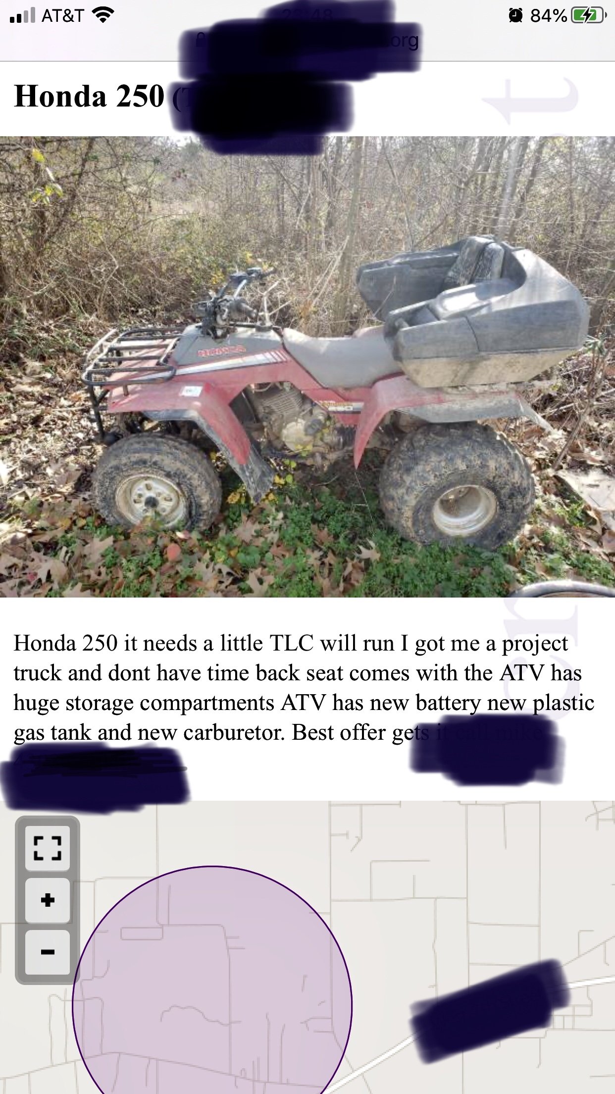

I likely just kissed $200 goodbye buying a Honda 250 this AM from Craiglist.  We'll see.

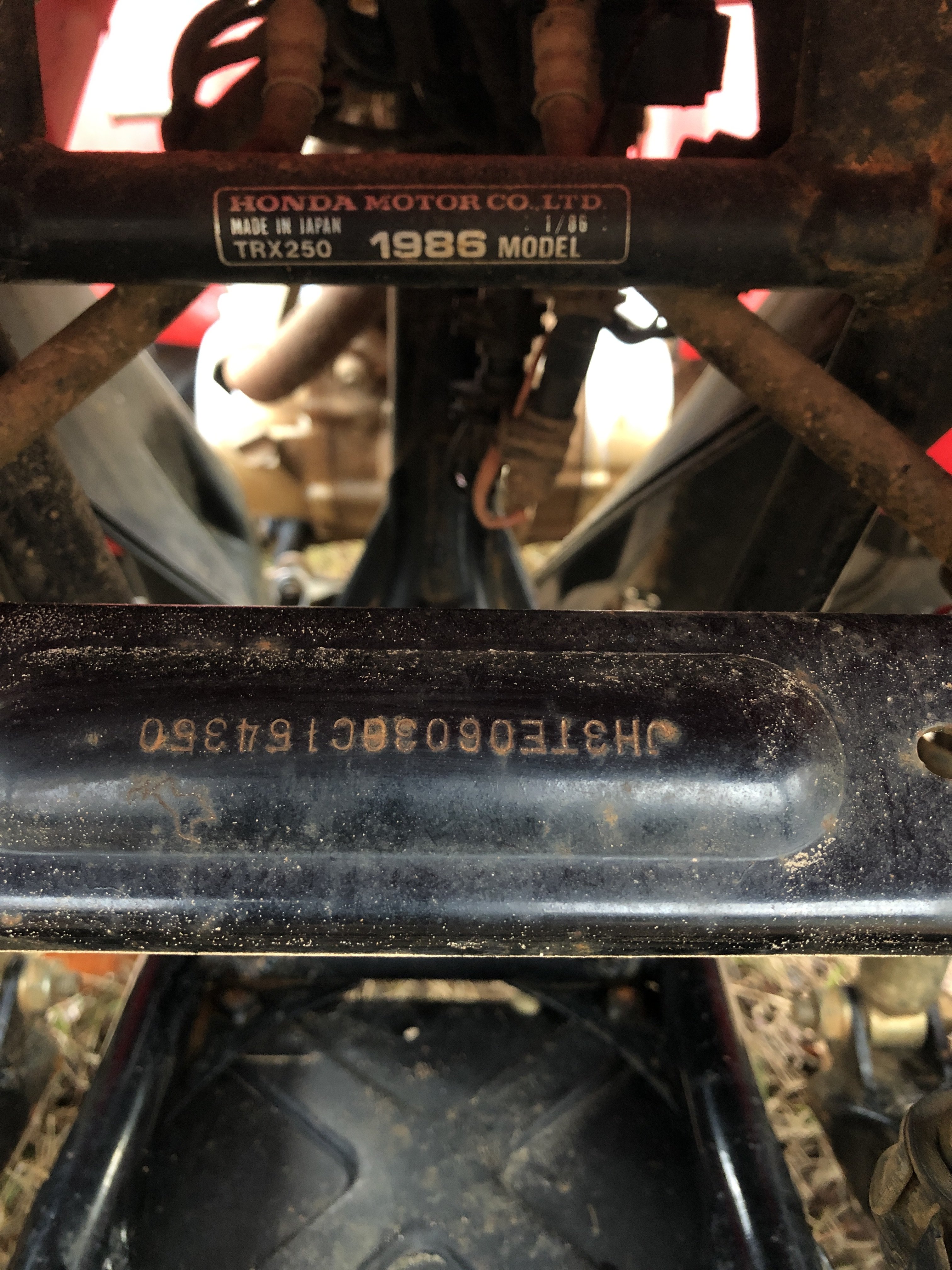

- VIN number is off the front frame; one VIN site calls it a 2008 Honda 250 TRX - this baby ain't a 2008; other VIN sites list the VIN as invalid; might be that the owner (a shady dude from a shadier side of my home town) put a 2008 front end on it?  No idea.

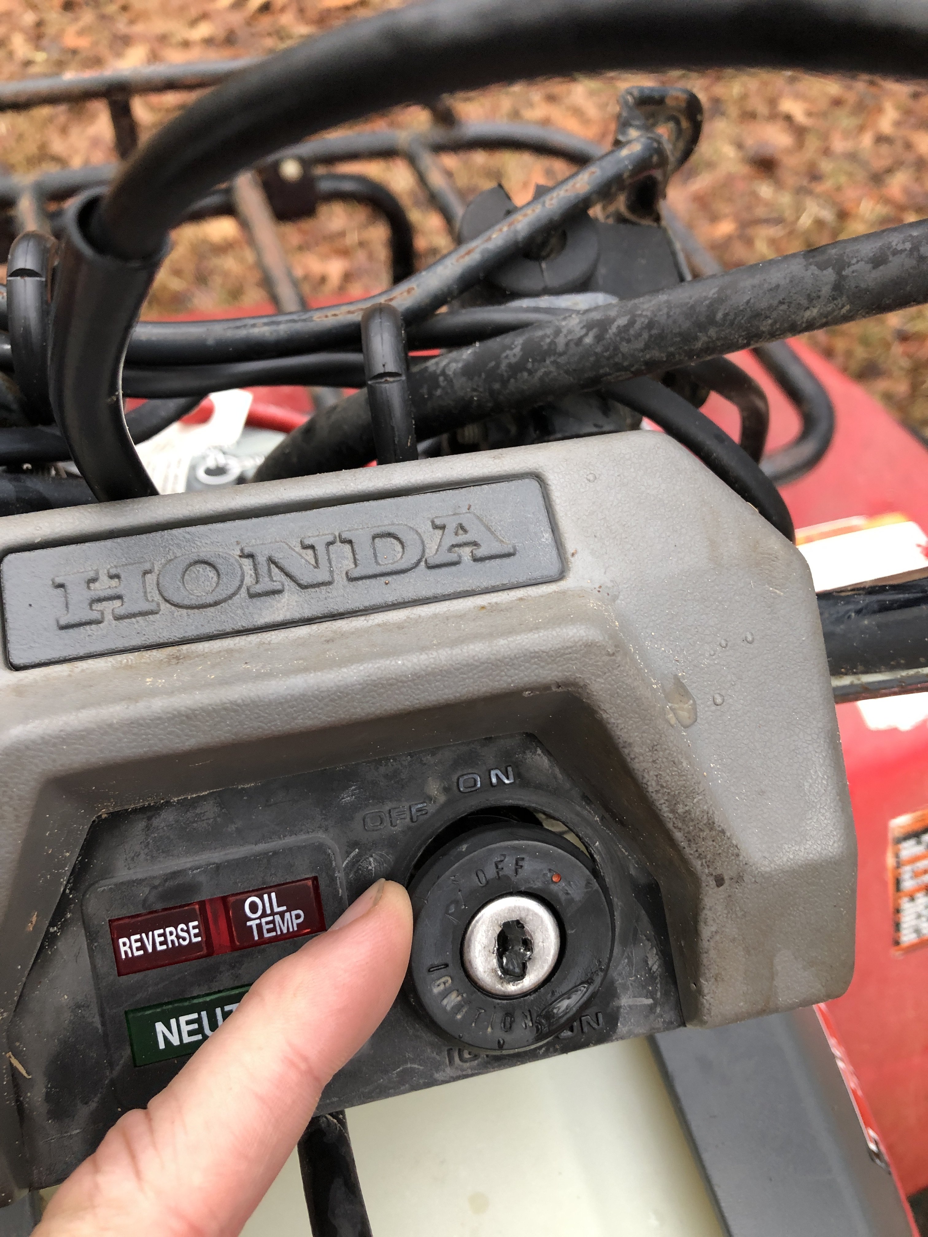

- a HUGE hint (hint #1) would've been that there's no key to start the machine - gotta use a screwdriver.  I'll likely be visited by police sometime in the near future.

- no front headlight; owner said machine has new carb - looks Chinese - he didn't have original carb; air intake box is wide open - no long plastic connection sleeve leading into air box like on my 99 king quad; no visible oil leaks; oil is dark; air filter clean; decent plastic; no front right brake apparatus; left brake handle very loose and rear brake doesn't work
- battery at this point is good; manipulate the ignition switch w/ screw driver and the green neutral light shines (this has since stopped working)

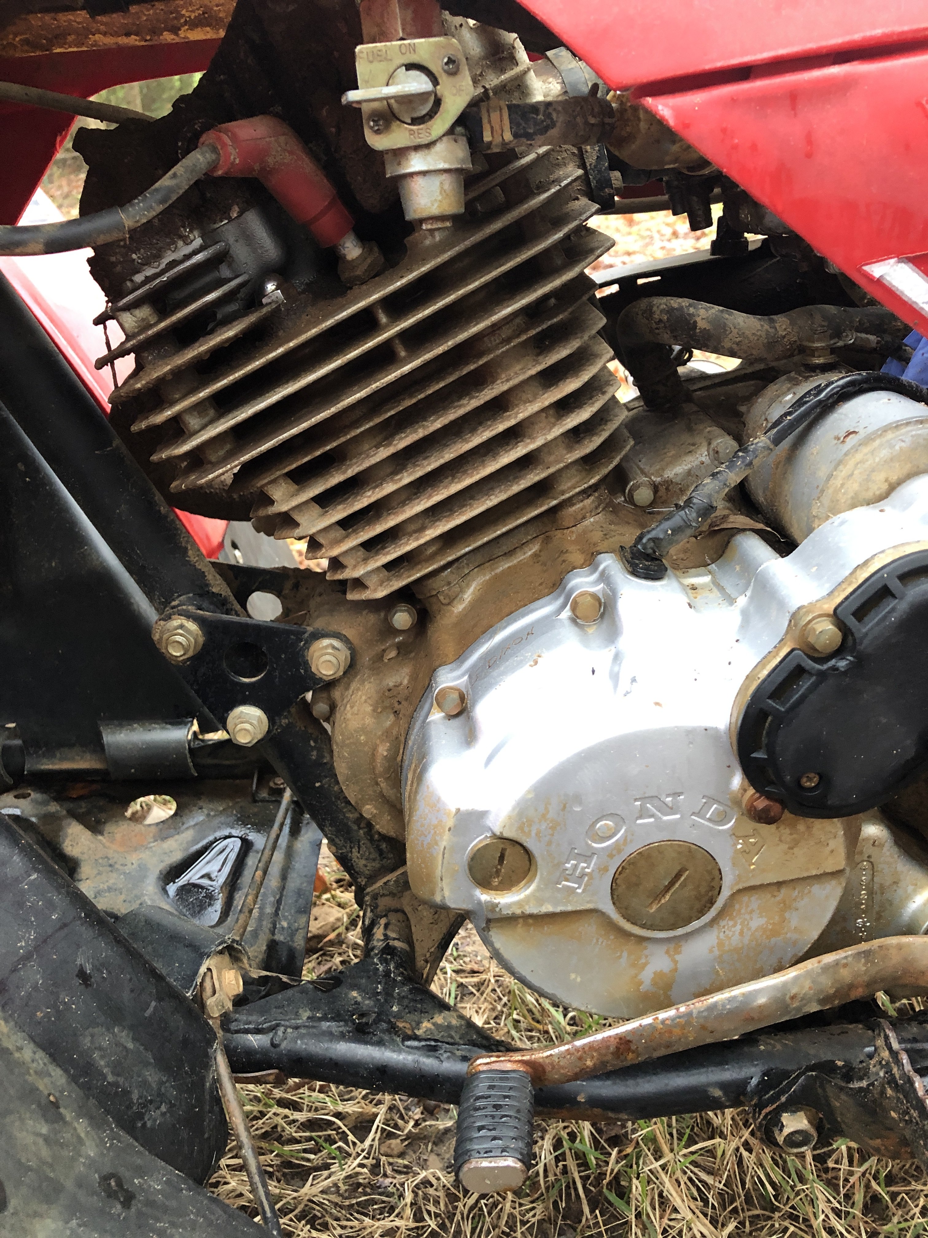

- it's a kick start machine: when I kicked it down (hint #3), the compression sounded normal, almost "tight"  but at the end of the cycle, there was some awful grinding noise coming from what sounded like either inside the engine or the starter area; I let it settle, kicked it again, same noise heard at the end of cycle; owner said it likely needs a new starter - I only hope it's this simple

People suck sometimes. Shady sh** deals are the worst. Looks like an 86 to 88 to me.  However based on what i see there is a market for the plastics and other parts so I would say you could make back $500 minimum in parting it out worst case scenario. Take a look on eBay i bet you find the plastics and racks for that make and model starting at $300.

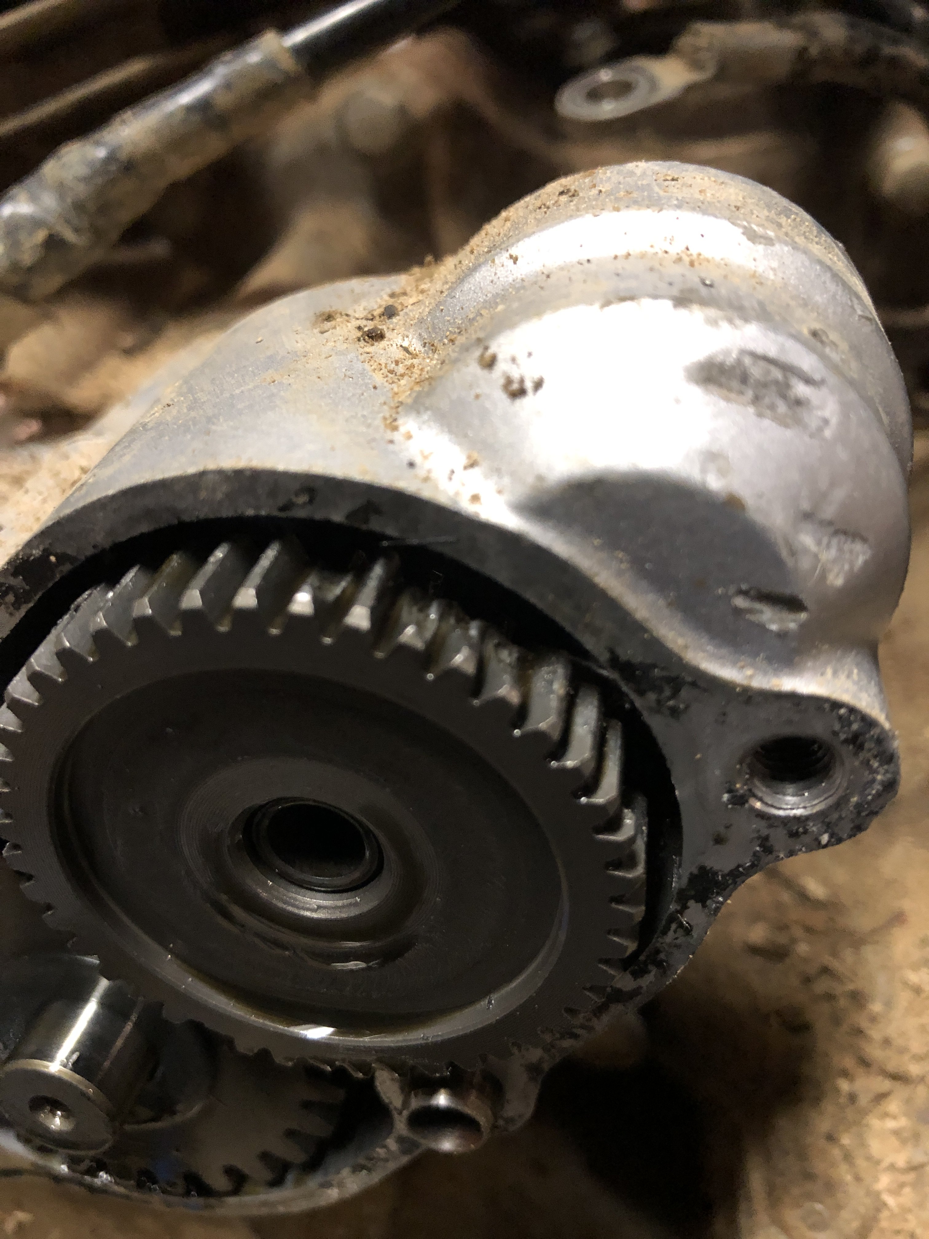

starter teeth were basically smooth on this one - shreds of metal in upper part of gear box - 4-5 of the teeth on the starter idler gear were gone - nothing for starter to bite into

2) might as well spend $15-20 on new ignition switch so I have a key to start the thing

you're telling me.  i'm pretty sure (from my limited knowledge) this was the grinding sound I heard when I tried to kick start it.  I can only hope.
I was able to move one of the other gears in the main part of the machine by turning the outermost smaller gear, which is promising.  ideally i'd need to take off outer gear housing and inspect for metal shards - but i'm not there yet... and will likely need gasket, etc.

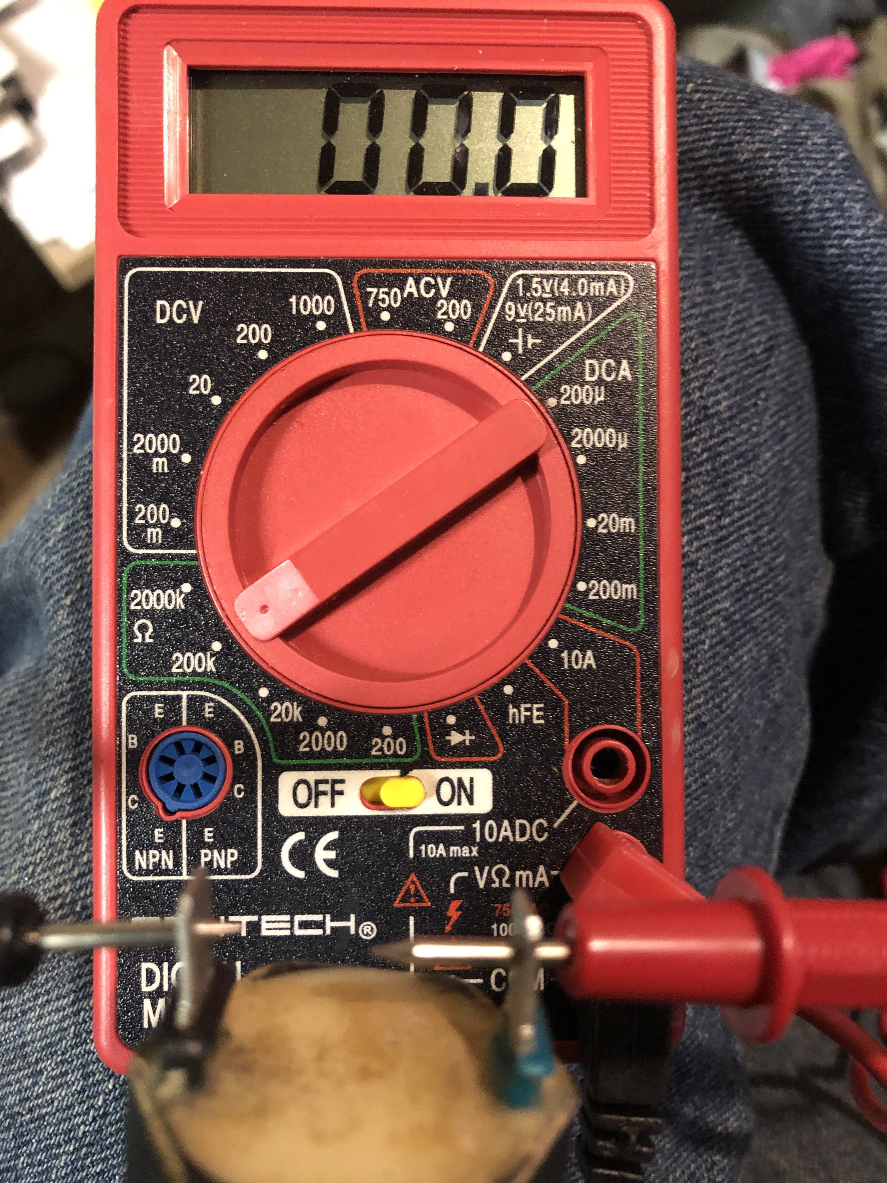

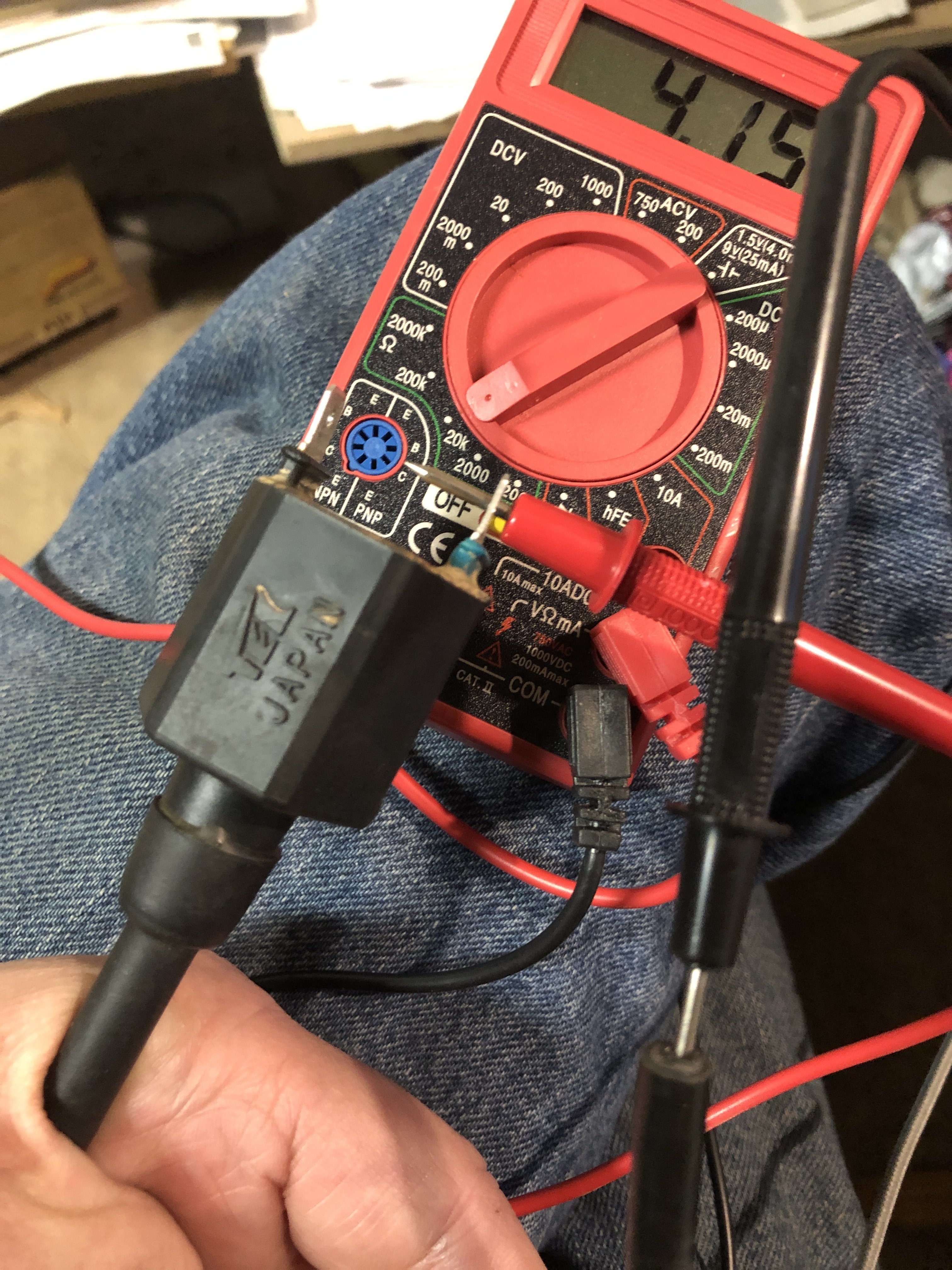

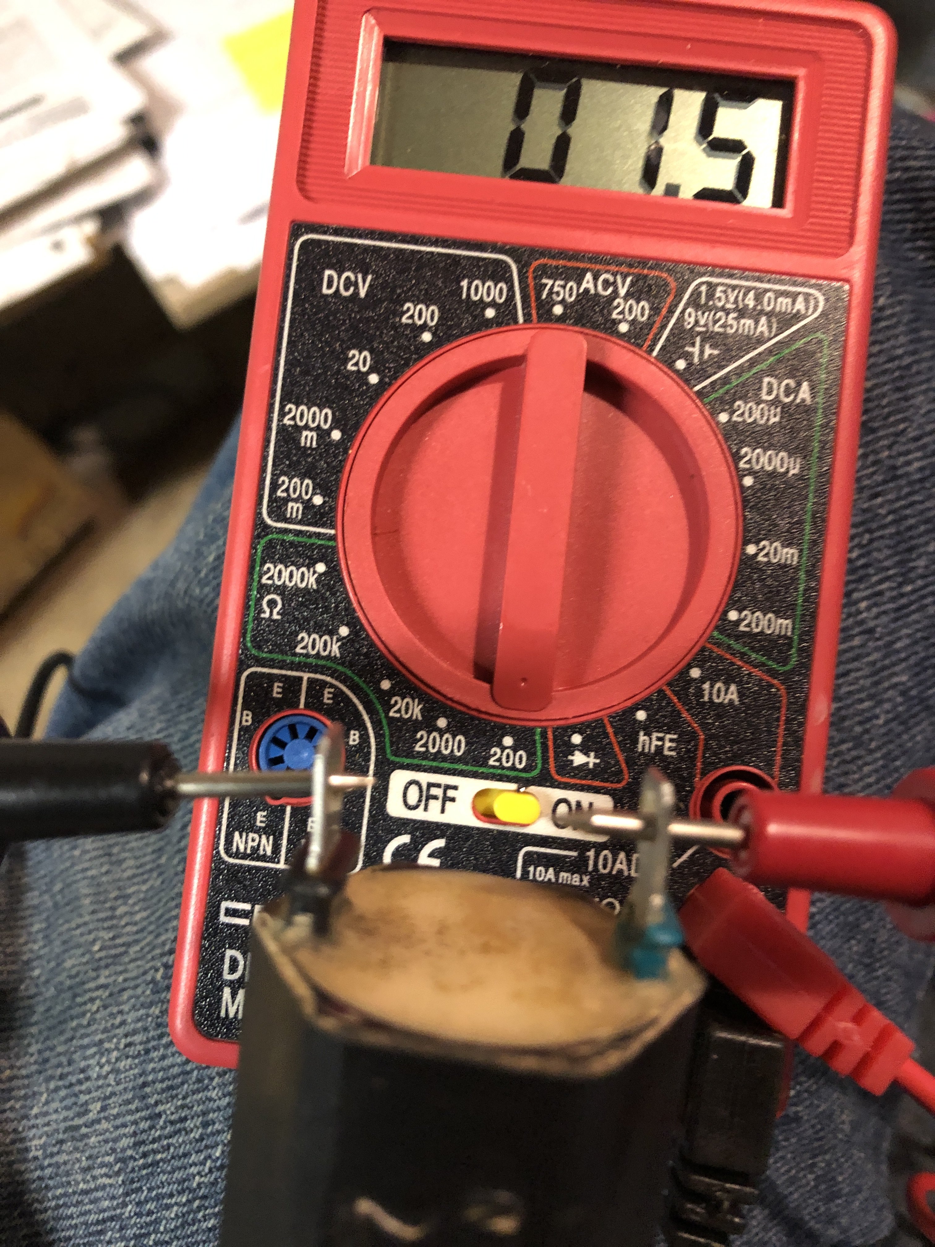

no spark.  pulled ignition coil and got the following readings below.  meter is on ohms.
for primary coil resistance specs read resistance range from 0.16-0.2 - if meter correct I'm way overboard at 1.5 or 2
resistance without spark plug cap should be 3.6-4.5: I measured 4.15 on the 20k ohm setting, which appears to be in range.
does this tell me the cap itself is bad?

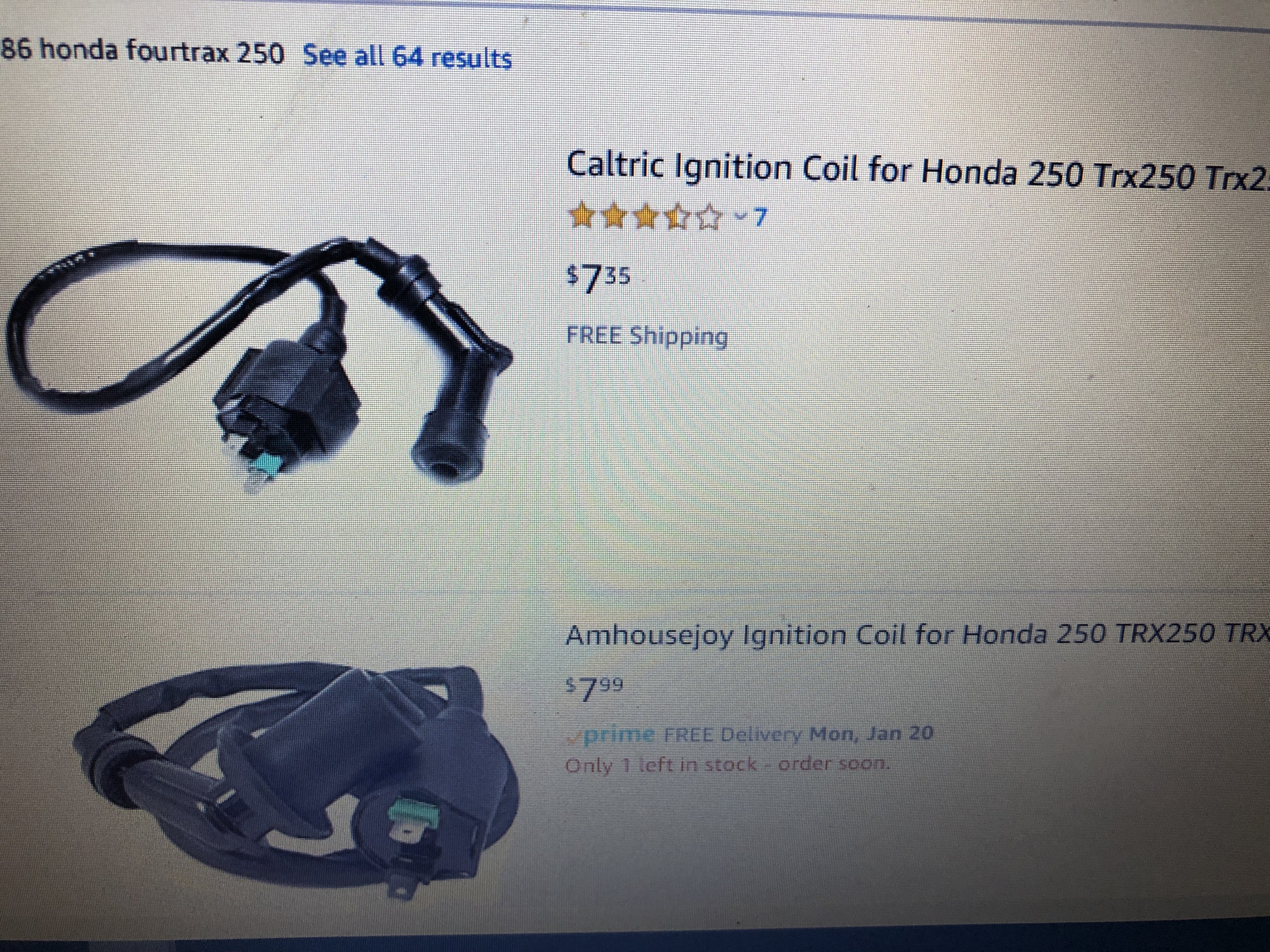

simple solution would be to buy a $7 dollar coil off ebay

I think your coil is fine.  Tester at 2000 you got  a 0.2 reading. (within spec) no?
Second test on the spark plug wire your at 4.5 (within spec) no?
I think the coil is fine, the cap can be tested with a simple continuity test and worst case cut the spark plug wire back a half inch and put the cap back on.
My guess is a ground failure maybe on the kill switch or elsewhere but i could be wrong.  And agreed on the $7 bucks for a new coil for sh*** and giggles.
Test your stator coil and pick up coil since your going through the motions.

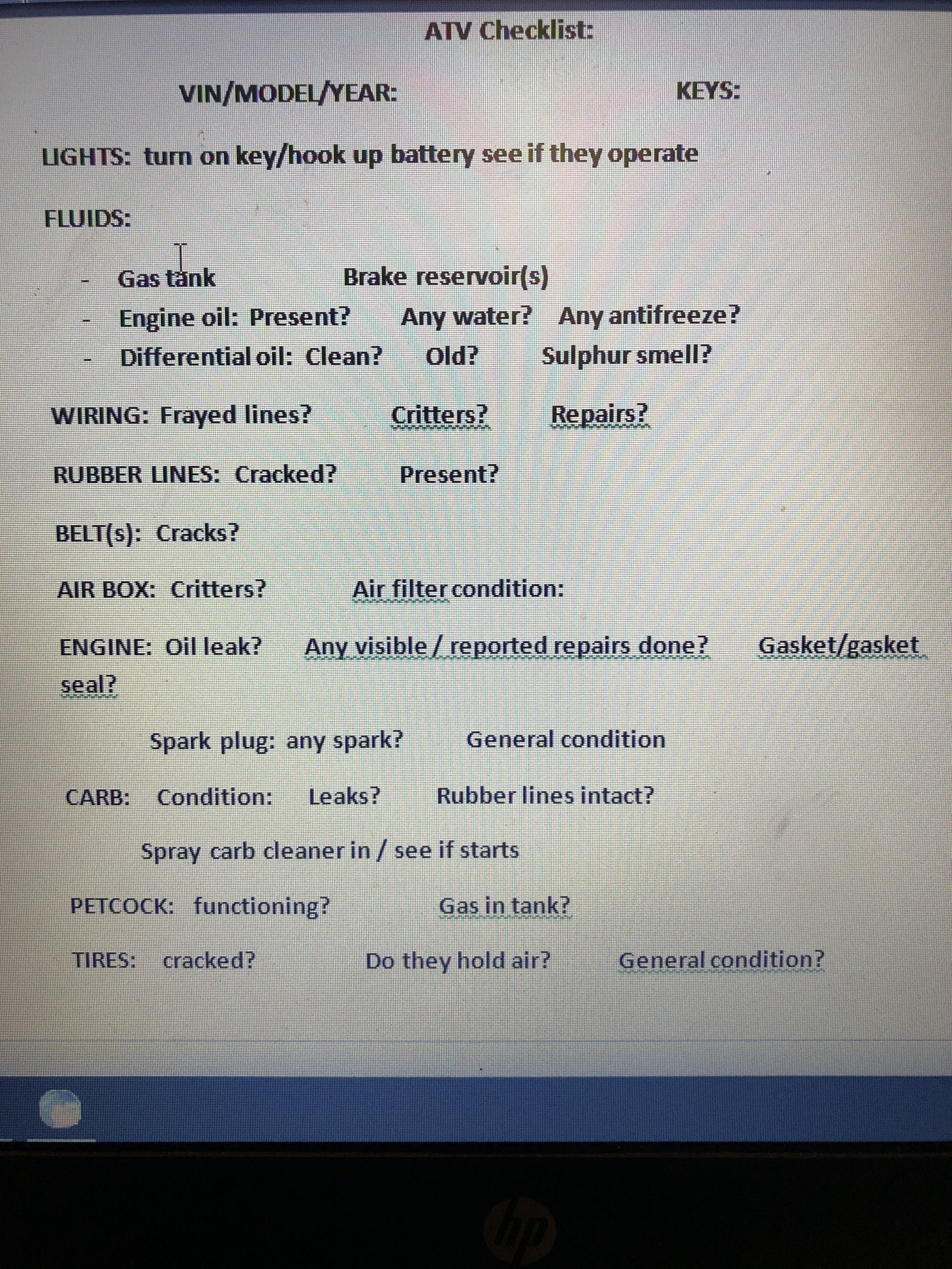

Would this list meet your requirement prior to purchasing an ATV?  Remember, I'm at novice level - these are things I think the average Joe could/should check.
Feel free to comment and I'll add it to my list.

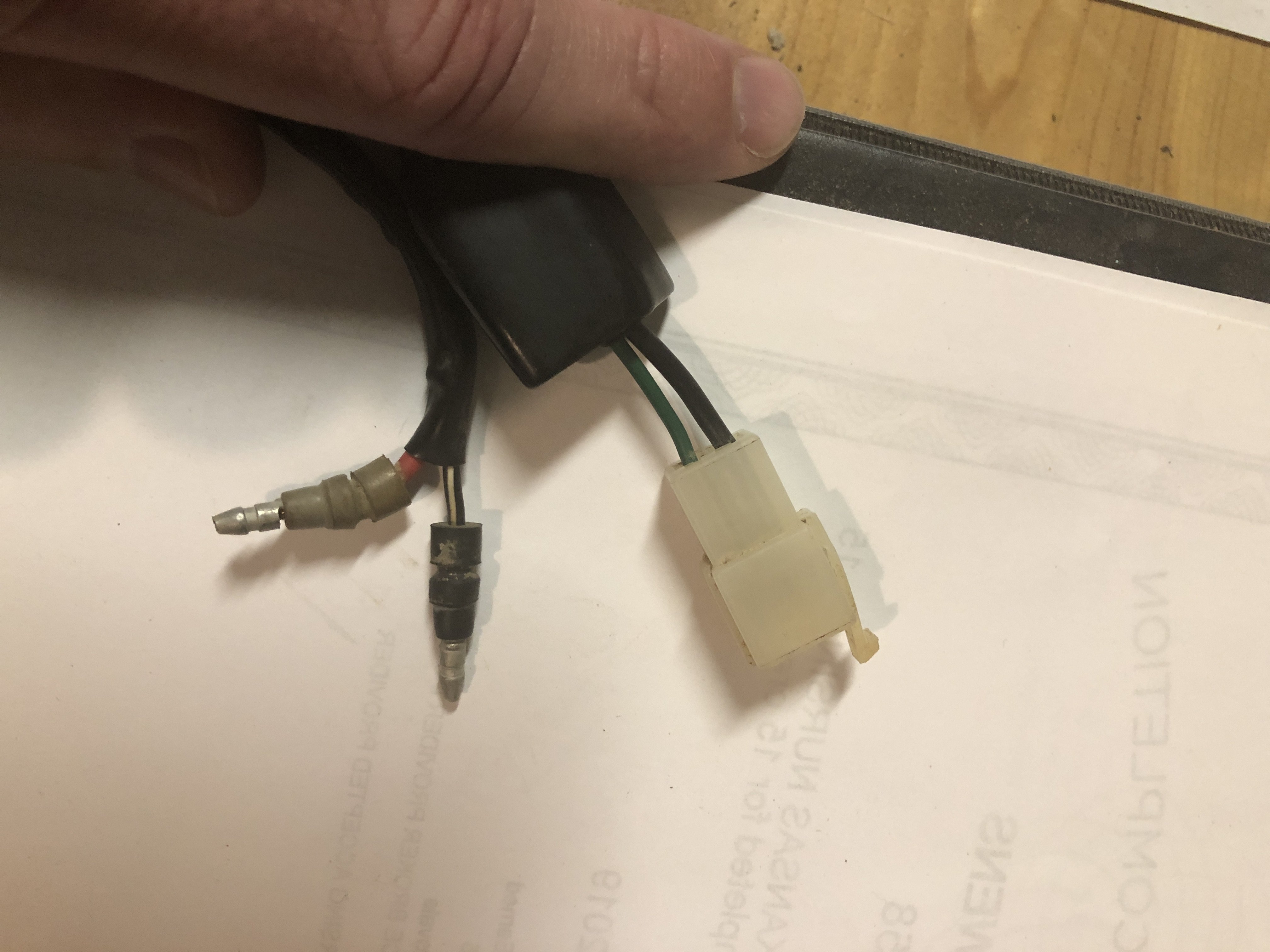

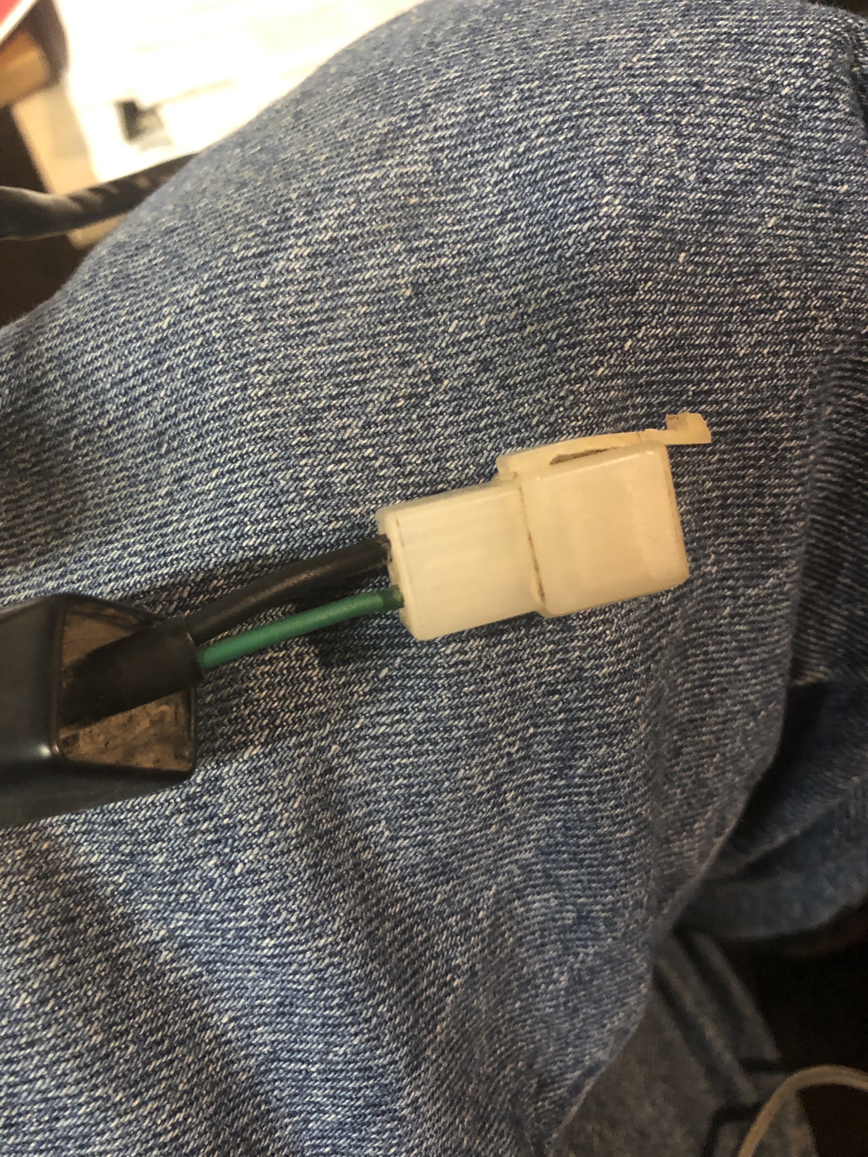

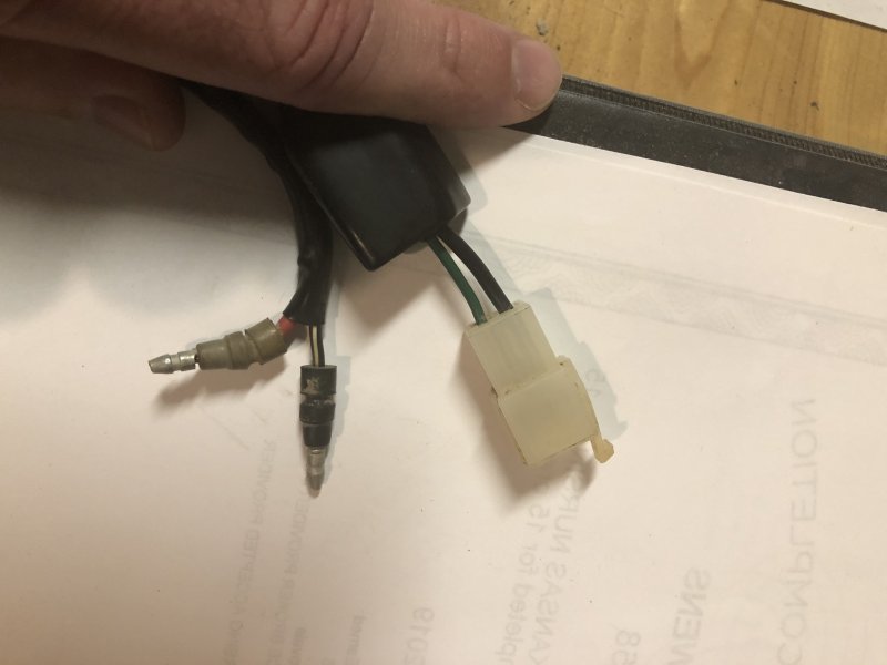

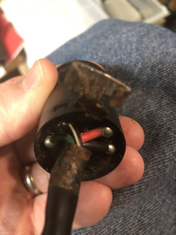

the ignition switches for sale online are connected the exact opposite way than in the pictures below: into the white plastic piece are the red and black w/ white stripe wires and the ones hanging free are the green and solid black wire - buyers of the switch comment, "hooked it up and it ran just fine" - but the wires are not in the same pieces as what came with the machine.  I could buy an original ignition switch from honda but it's $50.
on a cheap ignition switch from amazon could I not split the white plastic piece open and replace w/ the correct wires in the picture?
i'd likely have to resolder the wires on the switch itself and I can do this - would have to mark which wires go where but don't know if this tactic would be wise - i'd be out $10-12 if it didn't work - unless someone with a knowledge of electricity can shed some advice
You can buy it and give it a shot, maybe blow a fuse, thats it. If it does not work then worst  case scenario i would clip the plug off and just use but splices and connect it the way it matches. I would not start soldering.
I am no electrical expert but one of the wires will be constant hot, one will be the ignition, and one will go to the starter solenoid probably thru a neutral safety switch. Check the color of the wire on the solenoid. It may give you a place to start. The constant hot should be obvious.
