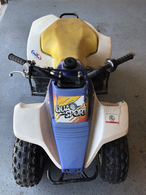

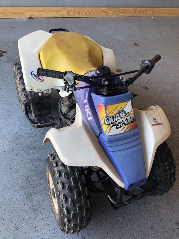

Picked up an LT80 (unknown year) for $200 recently for my girls. Not running at the moment, but does turn over. I’m thinking the carb needs to be rebuilt or replaced, as it appears to be leaking 2 stroke oil. Anyway, I’m excited to have something to wrench on in my (limited) spare time :)
21 minutes ago, Frank Angerano said:
That's a cool little bike. It should be oil injected, a small tank under the seat?
The carburetor can easily be cleaned out and compression should be about 90psi .
Its a small carb so be gentle.
Thanks Frank! I did see the oil tank under the seat. Not sure where the oil is injected though (I assumed the carb). Doesn’t appear to be leaking from the tank. Sounds like I need to break it down and investigate further

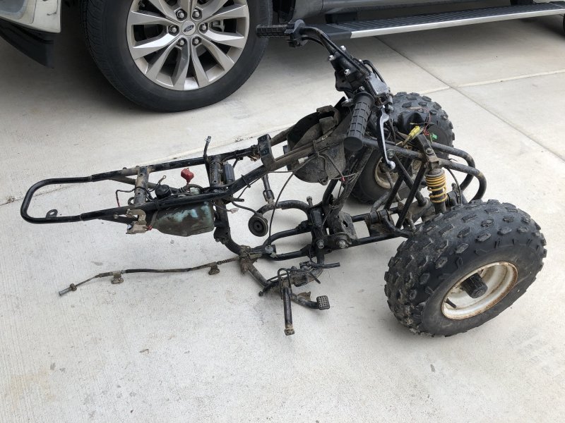

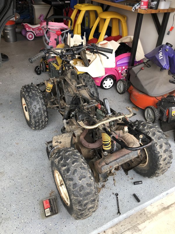

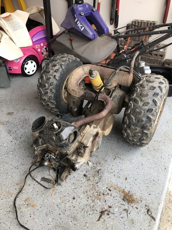

Update: started stripping her down today. Hoping to have it down to the frame over the next day or two. Looks like I’ll need to replace the wiring harness - it’s cut and melted in numerous places. The exhaust bolts are going to be a problem a well... pretty rusted and slightly rounded. Other than that, no surprises 👍

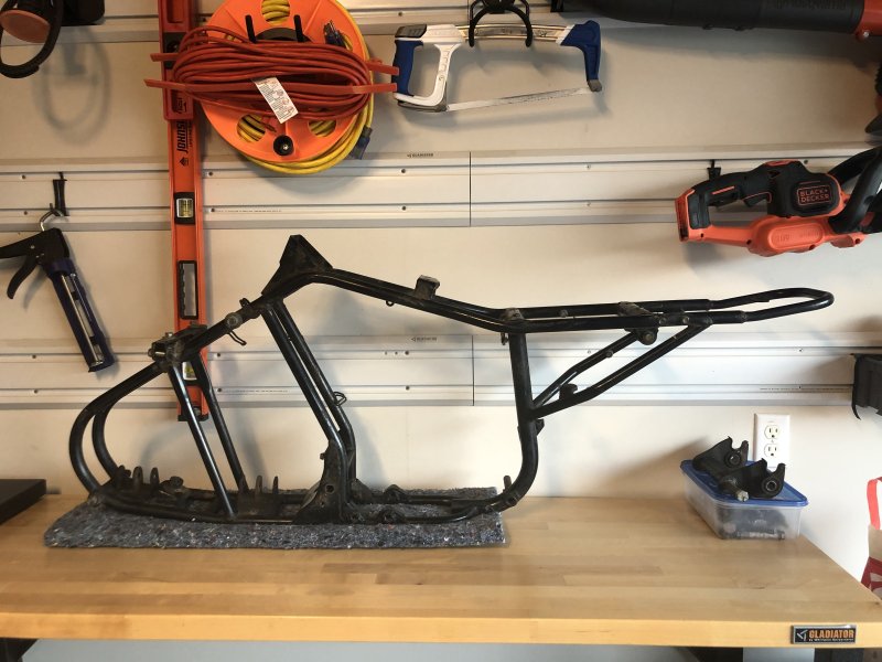

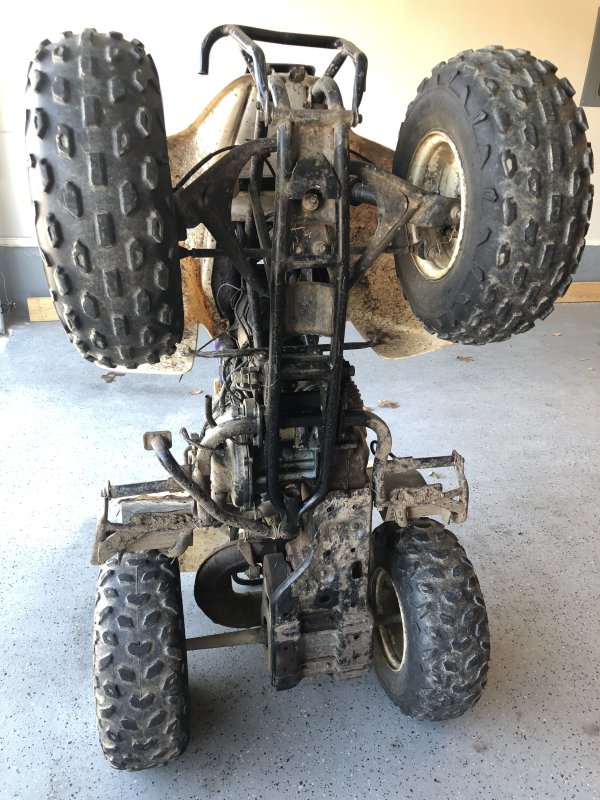

FINALLY got her stripped down to the frame.... really should have checked with wifey to see what outstanding tasks I had on the honey-do list before taking on this project 😊That and crappy weather set me back a bit.
Ordered a new set of handlebars and bumper guard. Once those come in, everything is getting powdercoated. I’m thinking pink with sparkly purple accents 🤣 love my girls
