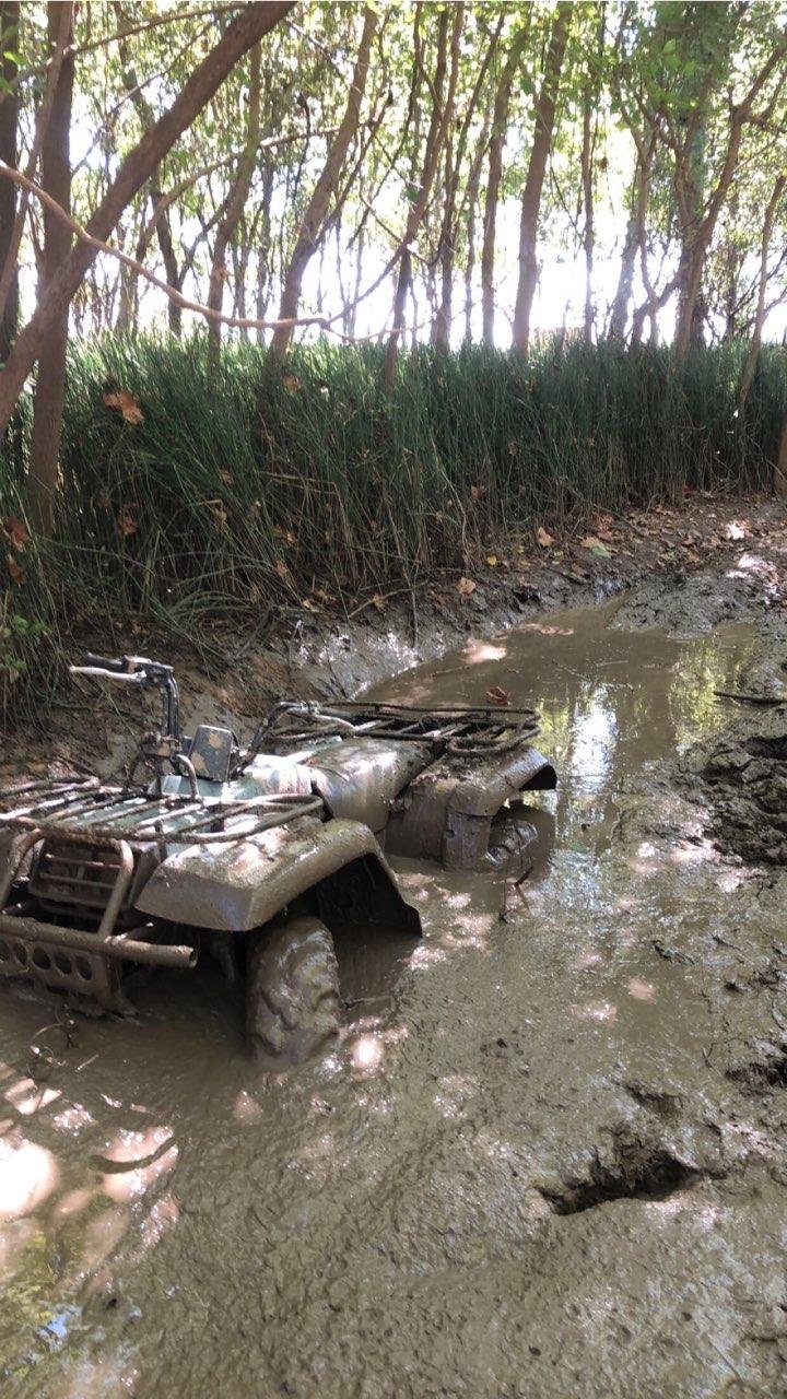

So the clutch still wants to slip a bit if you throw it WOT in middle gears but doesnt slip if you ease it to WOT. Probably centrifugal clutch. But anywho, here's a couple shots from yesterday's ride.
