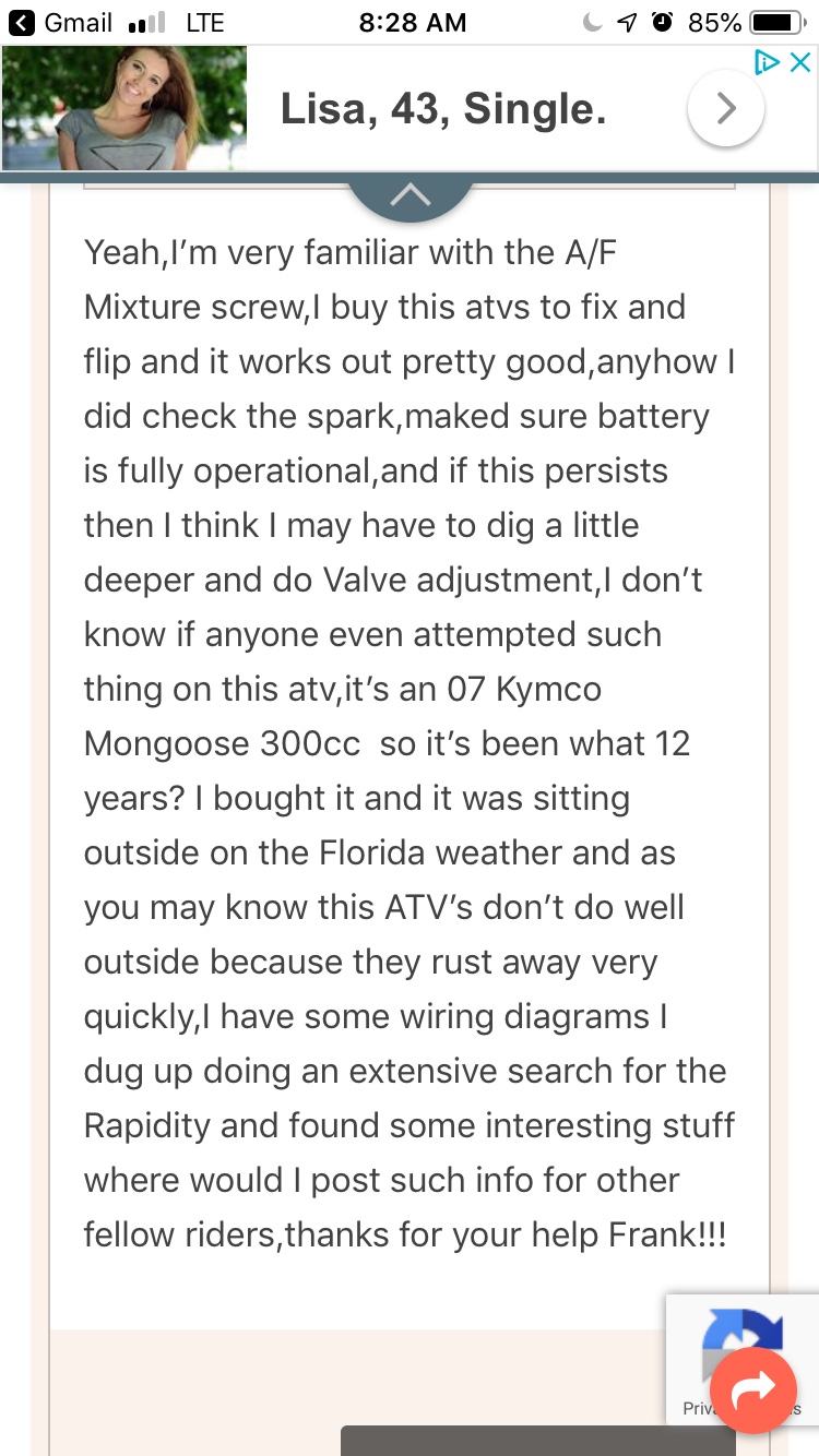

read the statement on the picture I attached I’m using an iPhone and I’m not very familiar with it yet,but that’s the reply to your last conversation.
Ok well that’s a great post Lisa 43 and single! 😂 just kidding.
