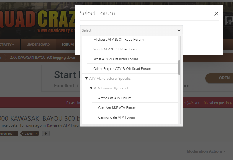

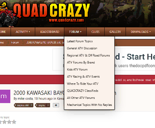

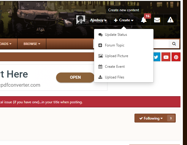

Thanks for the move, FYI when I created the post the sites main menu it showed machine specific forums was an option for topics, but didn't show them or appear to allow me to navigate to them.
Are you on a desktop or mobile using the site? If on desktop, was it from starting a new topic like:
Or the main menu:
or from:
Just trying to understand better because if you were confused, other members are as well and I'll suggest to change it around if needed.
image.png.e4429f245f934fb53291f9b562225907.pngimage.png.3d5494f0116703d143716c7fd70199aa.png
It appears to be working fine this morning, last night the sub menu for ATV Forms by brand didn't seem to load. It could have just been my browser, I use chrome on this machine and it is oddly slow at times. It's a home machine with light use, I need to just drop a SSD in it.
